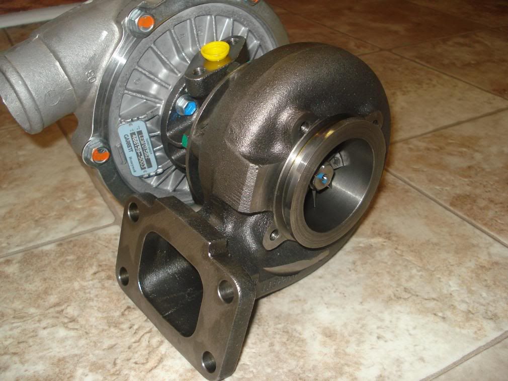

look what came in...
its a garrett T3\T4 57 trim .63 a\r with a v-band exhaust side....

sweet another member of the turbo lsj revolution.

yes sir....its the best way 2 get 400whp

cute toy of a turbo there.
i can see you actually did some research, and not just buy one "because its mad tight yO"

i did do research....... this was the best turbo for what i aiming for with the money i had for turbo money. its also a good baseline turbo to start with... i dont want mad power, i just more than the sc can put out...... and paul made 380whp on the ebay version of this turbo w\o the hahn intake manifold and with a not working right fuel system\maf, on stock block....so this turbo puts me in the right place for NOW......i know how u feel about these turbos from some of your other post, but this was my best opp. for the money

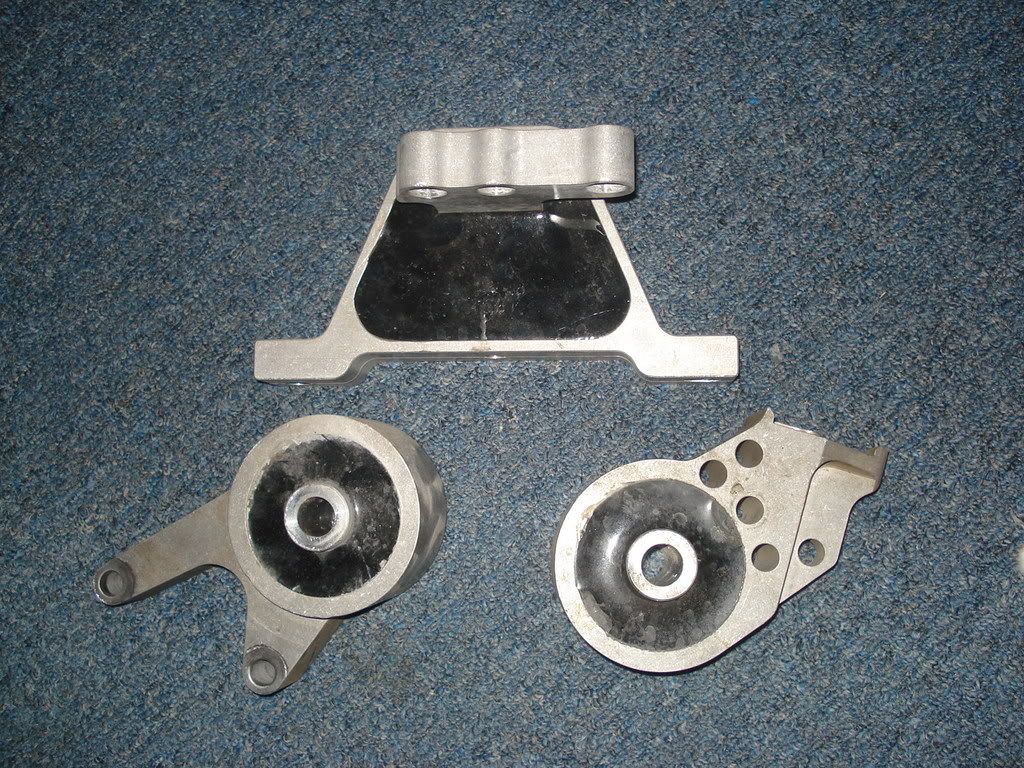

well few very small updates....
new 2 me mounts (zzp)...picked them up for $100

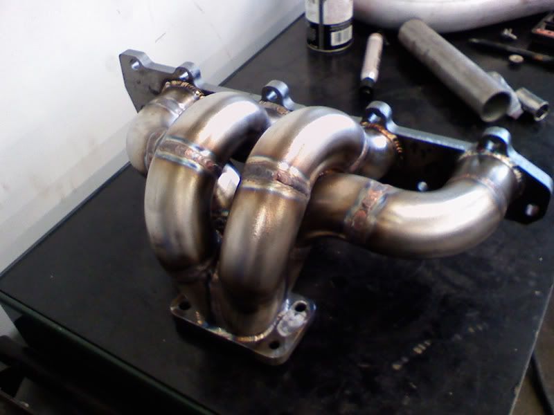

sent my log manifold back for one of these...mine will have an external wastegate...
still no word on my rods....but oh well

which side are they gonna put the WG flange, front, left or right?
not really for sure....i'll pm them and find out..lol
might wanna do that, on the log manifold, i had very little clearance between block and the wg, placement on this manifold could be critical. i'd say left side down by the flange would be a good spot, so your dump tube could be routed on the same side as the dp.
that 2 me would be the best place. it would make the exhaust work a ton easier. I sent them a message so we will see
the wastegate is being put on the left or driver side

Where did you find that turbo manifold?
Vulcan Turbo.com

i hope its placed on the left otherwise thats a nice internally gated manifold

Turbo should spool up a bit better than mine did on that setup (shitty ebay version, still stuck on shitty ebay modified turbo mani lol) I just emailed vulcan about that Tubular manifold myself. I'm moving soon so I will finally have some time (and a place) to work on my car for once lol.
