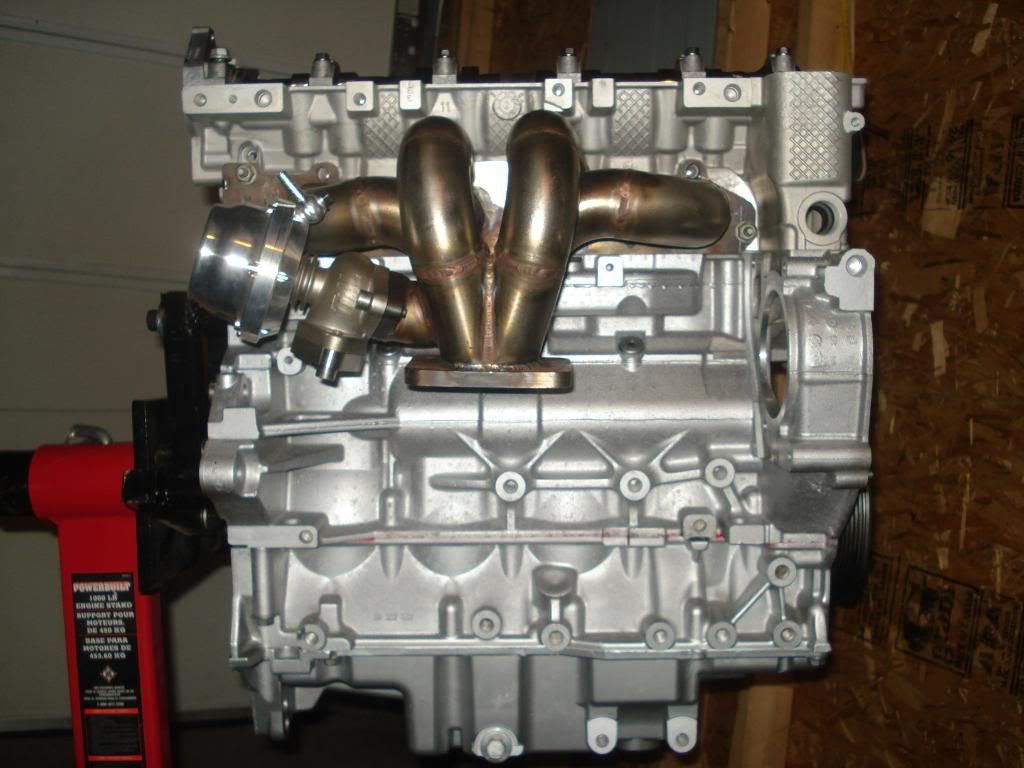

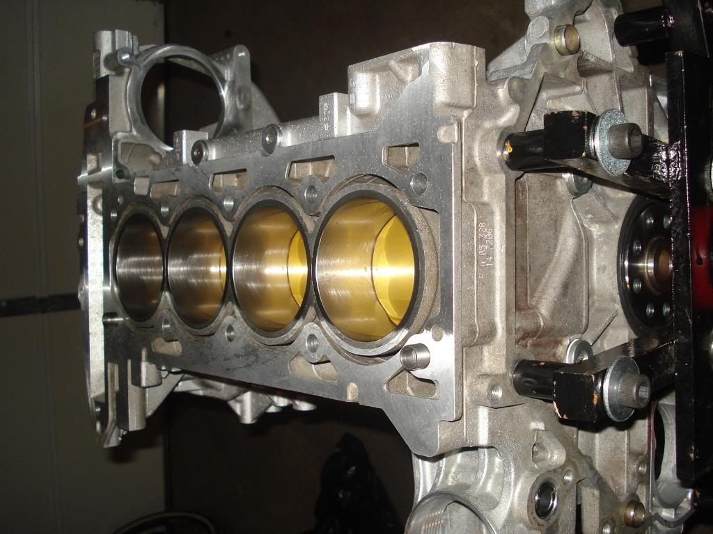

finally here is the good stuff!!!!
i know it says 2.2L but they r built 2 sent spec's fo my 2.0L.....lol

oooo gold pistons
Old Nov 24, 2008 | 01:26 PM
  #113
06blackg85ss's Avatar
Joined: 04-22-06
Posts: 15,211
From: New York
NICE MAN, can't wait to see it running.
Old Nov 24, 2008 | 01:30 PM
  #114
quicksilver41's Avatar
Joined: 08-11-07
Posts: 697
From: Ft. Riley, KS
Going to be sick! Looks good.
Old Nov 24, 2008 | 01:54 PM
  #115
jimbos'ss's Avatar
Joined: 10-09-05
Posts: 4,624
From: Killeen,TX
ooh looks good man, the manifolds definately compliment each other.

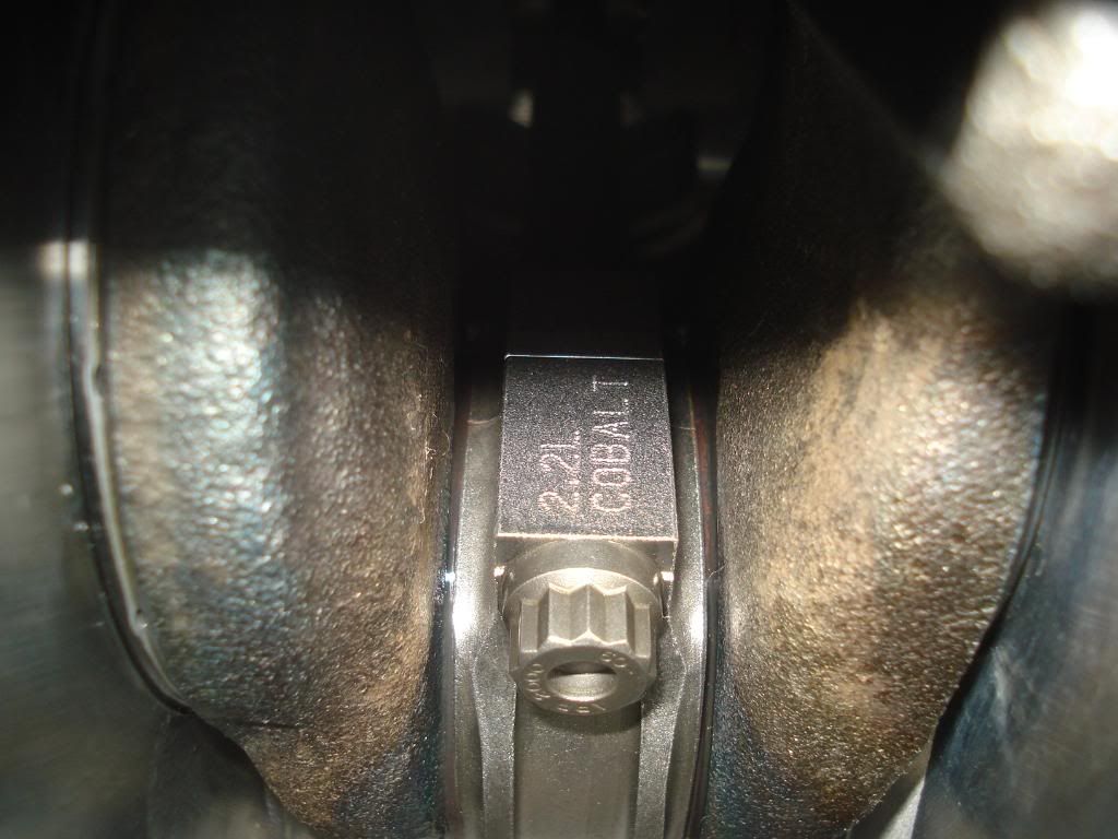

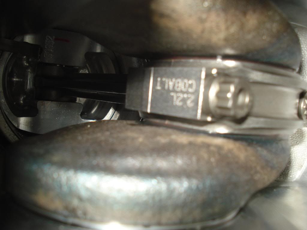

I have a stupid question !
Why do the rods say "2.2L cobalt" ? Thought you had a 2.0L crank ?
Old Nov 28, 2008 | 10:48 AM
  #120
Joined: 04-22-06
Posts: 15,211
From: New York
that;s just how pauter marks them for some reason, mine say the same
Old Nov 28, 2008 | 02:59 PM
  #121
spike's Avatar
Joined: 12-01-06
Posts: 1,700
From: IN
Yeh its just how they mark them.... But they fit fine....

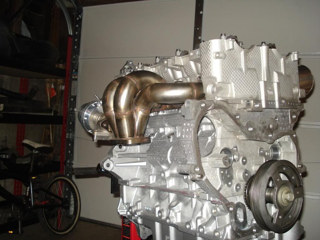

it coming ok..... I took some more pics with the turbo on and it looks like every thing fits fine. I think my mani. was made slightly diffrent than pauls but idk..... will be starting 2 really get things going in a few weeks after i get some more money

well i am thinking that i may not want 2 chance the .020" bore and might take everything back apart and have the block sleeved?!?!?! but idk...... I know it cost IDC just wish i would have done it from the start any input toward the sleeving would be great
Old Jan 11, 2009 | 04:27 PM
  #125
Armyguy151's Avatar
Joined: 01-07-07
Posts: 560
From: Franklin Indiana
i found some sleeves on all ecotech.com that i'm buying...i'm the the process of fully building a 06 turbo pistons rods cams forced perofrmance 3065r turbo vulcan exhaust manifold hanhs port fuler intake manifold....i'm tryin to find something about the crank anyone know where i can get a stronger one i'm going to iraq within 30 days i'm at ft dix nj right now mobing so if anyone knows let me know thanks...oh also i'm puting new pistons in and staying with the normal bore i also thought about going .10 ovr but that means tryin to find more **** ya know
