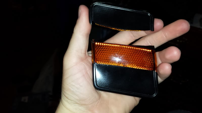

Anyone ever seen this happen. Painted the orange markers and they were fine for about a week. come outside today and its laying inside the headlight warped and cracked. I guess the black paint attracted to much heat.

Ive seen that in my old friends car. Halogen bulb ftl. I run LEDs after i saw his haha
