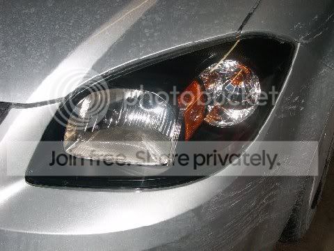

some people paint the bottom, some [like myself] don't. from what i've read in other threads it doesn't seem affect light output. here's how i painted mine...
^don't mind the dirty car...its a winter pic
i used krylon fusion satin black. also, i've painted a couple sets of headlights and each time i sanded the "chrome" insert with 1000 grit sandpaper, primer, then paint. it's actually an easy project, its the getting the headlights to re-seal correctly thats the pain in the butt.
