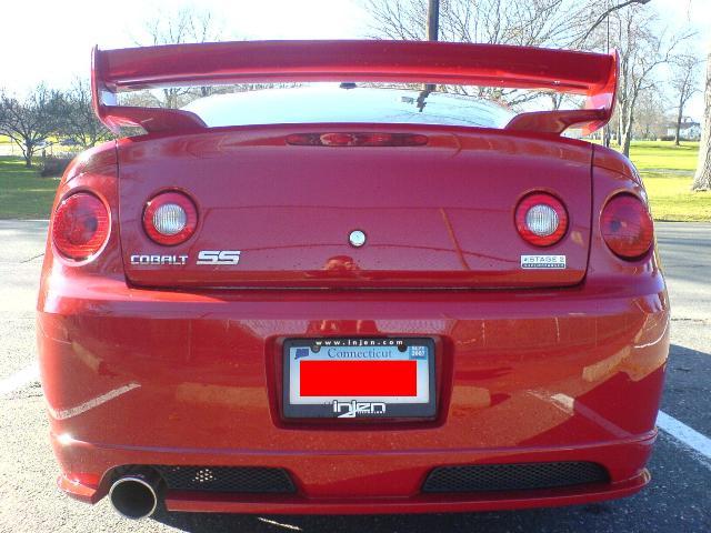

I say remove it. It looks a lot cleaner that way.
