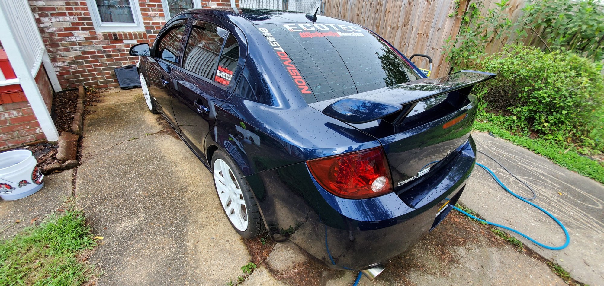

Kyle, the sedan and the coupe spoiler are different distances between the bolt holes. If you pull the sedan spoiler off, to mount the coupe spoiler you will need to drill holes and the other holes will need to covered up the other option is the GM Unique Spoiler for the sedan. Here is a picture of my sedan with the spoiler.
