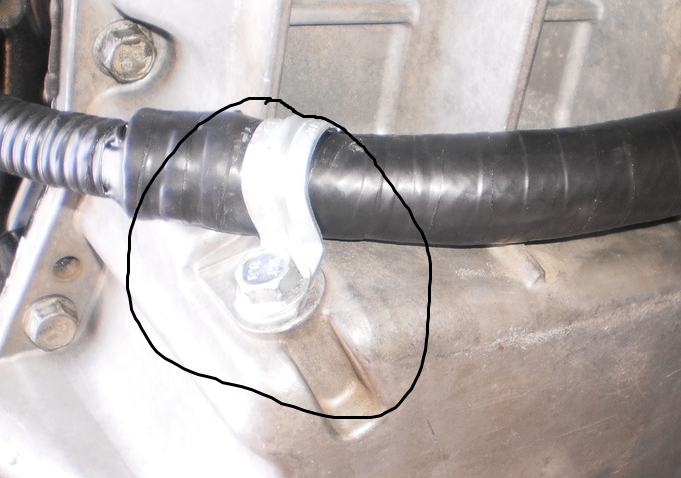

any concerns sealing the oil drain plug with the strap there?
I'm not sure what your referring to?

I think he is talking about this.

that is not the port for the oil drain plug, it was just a random threaded hole that did not open up to the oil pan i will see if i can get a better pic

here that piece is in the front of the engine
