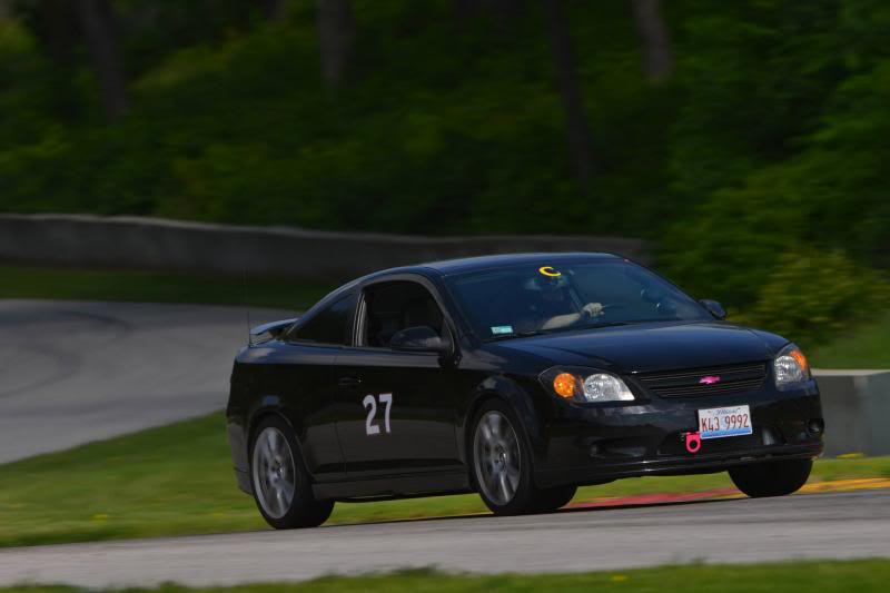

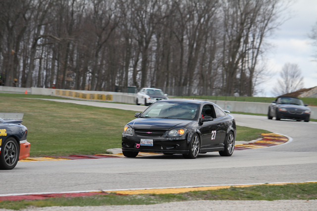

Eh, I'll bite.
I just do track days. I generally do two events (4 days) a year at Road America, and then a couple day events at other area tracks, mainly Blackhawk Farms.
Maybe one or two autocrosses a year, but I just go for fun. I'm not competitive, and I'm also stuck in SMF.
06 G85 SS/SC
Relevant Power and Cooling Mods:
2.7
80s
E85 HPT Tune
Dual Pass
CXRacing Heat Exchanger (Mounted in Front)
Option B
Raw 3" Intake
Badmab Header
ZZP 3" Catted Downpipe
Vibrant 3" Catback
Handling/Stopping Mods:
LNF Struts
Koni Yellow Shocks
Powell v.2 YYZ Springs
Powell Street Bar
Under Car Rails
Brembo Swap
Front Pads: Track: Raybestos 43 Street: Stock Brembo
Front Rotors: Track: Centric Street: Stock
Rear Pads: Hawk HP+
Rear Rotors: Centric
Stainless Lines
ATE Superblue/Amber (At least until my stockpile of Superblue runs out... I swap every flush.)
Street/Rain - Enkei Ammodo 18x8 with 235/40/18 BFGoodrich g-Force KDW2s
Track - Enkei PF01 18x8 with 255/40/18 Continental Racing Slicks Hot PSI 35 front, 36 rear.
Fenders have been rolled.

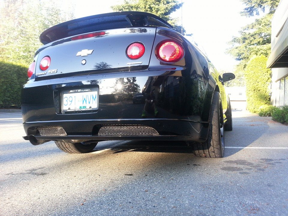

I fall into SMF hard for AutoX. looking to do track days, and next year compete in Redline Time attack.
2006 LT2 / L61(2.2L)
Power:
Fully built L61 Engine
Eagle Crank
Eagle Rods
Weisco Pistons
1mm oversized valves
Comp Cams Stage 4 cams (motor was set up to do 25psi on a turbo)
M62 w/ Dual Pass cooling & Cobra H/E
Injen Intake
Badmab Shorty Header.
ZZP 2.5" Stainless high flow cat and catback
Clutchmasters 8 puck race clutch
Quailfe LSD
Stop and Turn
Goodrich Stainless line kit
NAPA Ultra Premium rear Drum Kit
Napa Ultra Premium Rotors
Hawk HPS Pads
ATE Superblue / Type 200 fluid
SKF Wheel hubs
1" Rear swaybar (forget whose)
Steering Rack spacers
D2 Racing Coilovers. 8k rear 12k front springs, custom front shock valving( full on -4.0 camber at the track)
Front sway bar and endlink delete
Fe5 Control arms with Powell LCABs and TCABs
Wheels/ Tires
Street: 17" Sparco Asetto Gara wrapped in 235/45/17 Hankook RS2's
Track: 15" Kosai K1 wrapped in 225/45/15 Hankook RS3 (couldnt justify R comps this year) 37psi front, 35psi rear
Etc
Impact! 6ppoint harnesses
Corbeau raceseat ( need a new one)
custom harness bar setup from a friend that builds supermodified
CF hood, soon CF tail for weight
Rear seat delete
Tow hooks (very useful actually.... >__> )
And with my new grills.

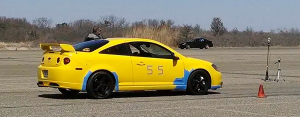

Good thread is good
Second year auto x'ing
Car and mods:
2009 Cobalt ss
yyz v3
koni yellow
xxx bar
K&N
zzp Dp
trifecta tune(use stock on track)
17x9 team dynamics with old rs3's 255 40 17
Raybestos black box pads
bps short shifter and cable clamp/base bushings
Future mods:
Cabs
rear beam bushings
camber plates for -2.5-2.7 degree camber in front
Custom ucrs being made by a few of us in our local cobalt club
stainless lines
tires, tires and more tires.
Car is perfect the way I have it now, get's the back end out when you want into corners and it very stable/predicable in every way. Just need some r comps or newer street tires to be competitive in STX, and lots driver mod
We are blessed with being able to rent a 1000 foot by 500 foot runway pad at a local airport, which gives us big fun fast courses.
Here's some of our club members
Pic from last year
Current setup, requires a 5mm spacer in the rear to clear tires. Much worth it for the extra tire, had no problems keeping up to all the porsches at the local porsche club auto x a few weekends ago.

Hahn down pipe
Ported intake and TB
Crazy Steve Intercooler
Powell Built 4.45 Cyroed F35 (best mod ever)
Custom adjustable splitter. I run it 3 inchs of the ground at the track. Can be adjusted 3/4 inch up or down with a 10mm wrench
5x114.3 Conversion
Drag DR31s 17x9 front 17x8 rear
Hoosier A6s 295/35 17 fronts 255 rears
Rebel track bay
Custom D2s front and Powell YYZs and Konis reat
-1.50 camber ft 1.75 rear
Spent 1 week reworking the fenders with a dolly and body hammer
Powell rear swaybar
[URL=http://s931.photobucket.com/user/daddmann/media/My%20Balt/AirSplitter7_zpsb02d0201.jpg.html]
HP tuners tune
fully bolted
K&N Intake
Full E85
ZZP fueling cam
ZZP Opel injectors
ZZP 5th injector
Jennety 3 inch exhaust
Hahn down pipe
5x114.3 Conversion
Rebel track bay
Powell rear swaybar

I run road coarses, so far averaging around 3 track days per season. I haven't done much to my car. It's an '09 SS/TC.
Hahn Intercooler
Hahn DP
Hahn CAI
Hahn Charge Piping
Trifect Tune (stock on track)
Factory rotors and pads up front
Centric rotors and powerstop pads in rear
Super Blue DOT4 brake fluid
BPS Shfit Linkage
After a 2 day event at Watkins Glen I discovered my left front caliper is binding, so I will be rebuilding that before my next track day in July (Pocono SouthEast). I also want to look in to Powell rear sway, ss brake lines and floor mounted gas pedal (I have a hard time heal-toeing on the track).
I run my street tires, Continental ExtremeContact DW, with pretty good results.
I've ran 2 track days so far with the above setup with satisfying results and 4 tracks days without the engine modifications, also with good results. I've only done 6 track days with the car total.

my setup !!
Wheels / Tires:
* Enkei Falcon’s – 18 x 8 wrapped in Nitto NT05 – 225/40/18
Suspension / Handling:
* Pedders Springs
* Koni Yellow Shocks (Rear)
* 06’ FE5 – Struts
* Moog Sway Bar Endlinks
* OTTP Spherical T-CABS
* OTTP Derlin L-CABS
* OTTP 1.25” Rear Sway Bar
* Powell Rotated Trans. Mount
* LNF OEM Rear Transmission Mount
* Powell Harness Bar
* Sparco R100 Racing Seat
* Powell Xd Seat Brackets
Brakes:
Front -
* LNF Brembo Calipers/Rotors/Pads
* FTP Stainless Steel Brake Lines
Rear-
* Stock LSJ Calipers/Rotors
* PowerStop Pads
Performance:
* M62 Supercharger w/ 2.8” Pulley
* Dual Pass Endplate
* Siemens 80 lb Fuel Injectors
* Bad Mab Shorty Header
* ZZP 3”-2.5” Catted Down Pipe
* ZZP 2.5” Catback Exhaust w/ resonator
* Injen Cold Air Intake
* OTTP Option B
* OTTP Front Mount Heat Exchanger
*LSJ-Ion Ported Head w/ Supertech 75lb Valve Springs
Tuned on E85 by 06blackg85ss
