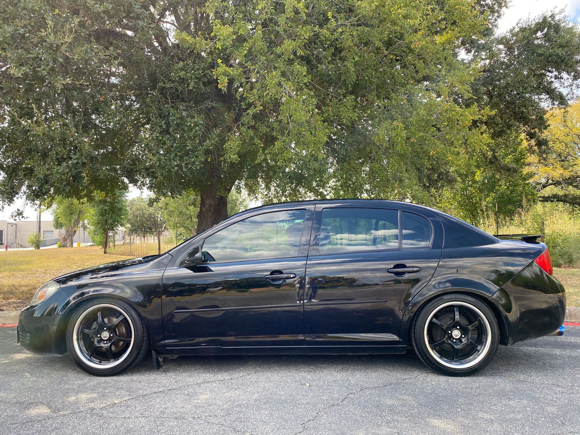

I bought the raceland ultimo coilovers for my 2.2 auto slowbalt, after installing coilovers with new sway bar links and strut mounts I have bad axle wobble.
I assumed the issue was that the axles didn’t like the new geometry of the angle so I replaced both axles with new ones and I have the same wobble. I found that I need a rotated rear trans mount to raise the rear of the rear of the trans to compensate but I am having 0 luck finding some for an auto trans.
I like the stance I have now and I have raised it an inch from what I initially started with and noticed the wobble isn’t as severe but still very much there. Is there anything else I can do to help realign the axles? I had no issues with wobble or suspension or alignment prior to swapping to the coilovers. Thanks in advance.
