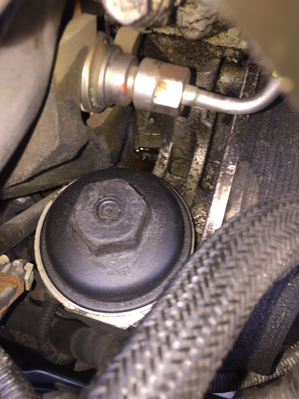

Sorry in advance for the long post, and sorry if any of the questions seem dumb. First, I was going over everything under the hood just looking around making sure everything was in order and noticed some oil behind the oil filter (pictured below.) I checked the oil level while it was running and it was good, and after it cooled down and it was good. I haven't smelled any oil burning and there aren't any spots in the garage. Could it just be the filter leaking from the last oil change? I drove it home from zzp this past Friday (260 miles) and everything went completely fine.

I'm seeing the same thing around my oil filter too.
Anybody know what that dusty/black residue is from?

That oil behind the filter area looks like someone was sloppy removing the used filter, and some dripped off.
Could be from a leaky cam cover gasket too. Check around the gasket area.
Old Jun 1, 2016 | 01:26 PM
Or it's leaking from his hpfp the o-ring is kinda crappy
