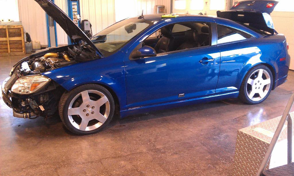

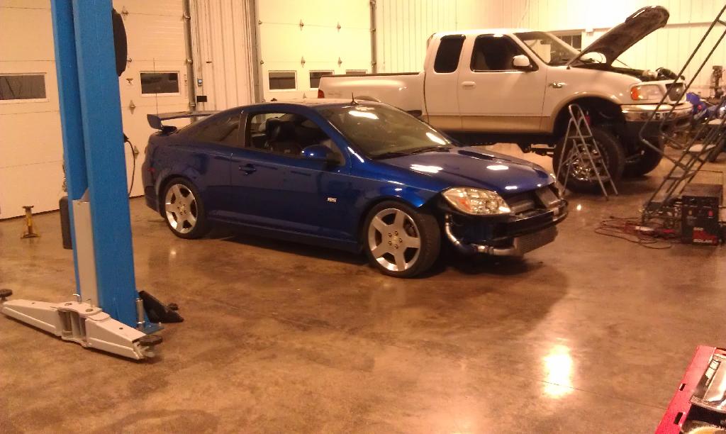

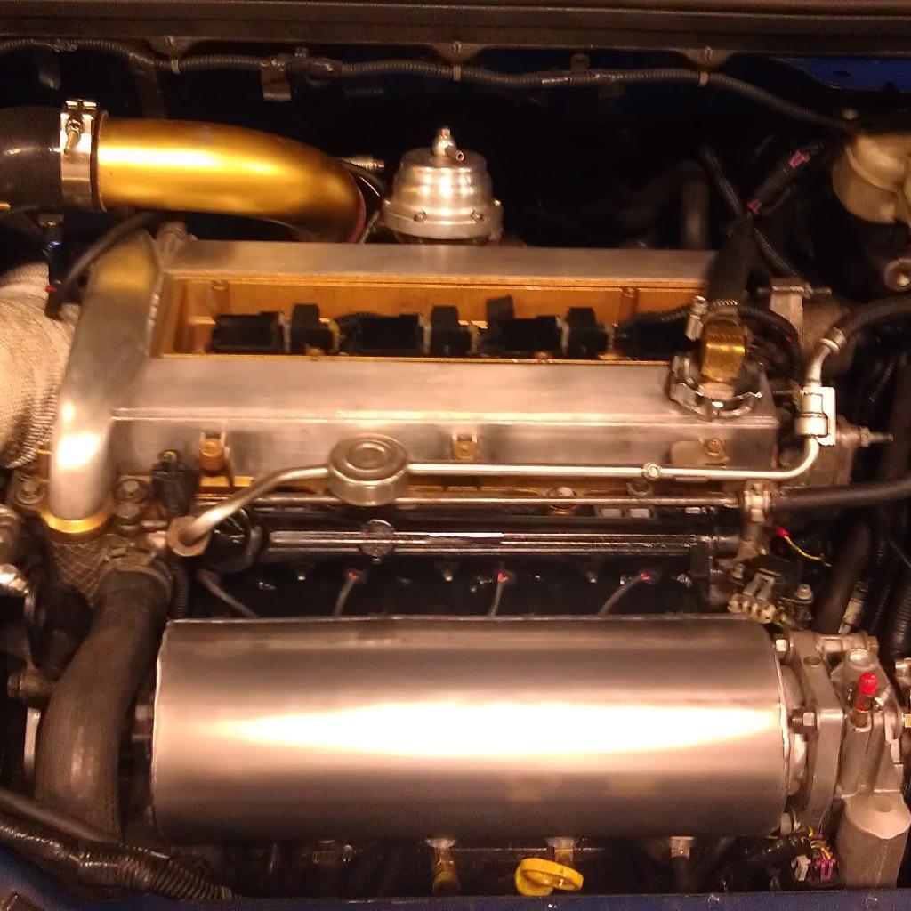

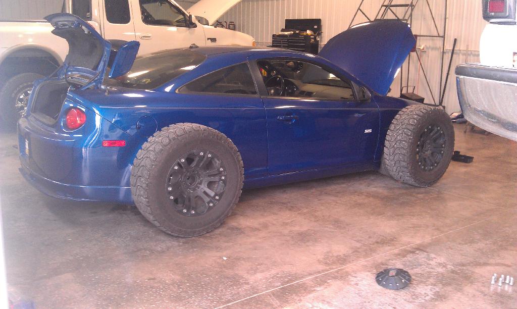

Old Jan 17, 2014 | 07:01 PM
  #72
terry11's Avatar
Joined: 07-24-09
Posts: 1,679
From: Lewisburg, Pa
Does anybody like how I connected the throttle body?

But before it hits the street this spring I have a few...Other plans for her. I don't think I showed you guys that intake manifold either. I was really happy with how that turned out!
