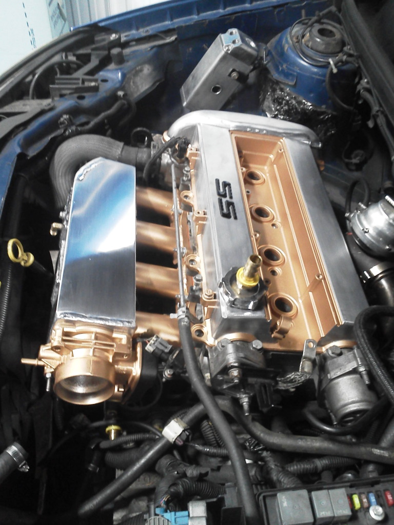

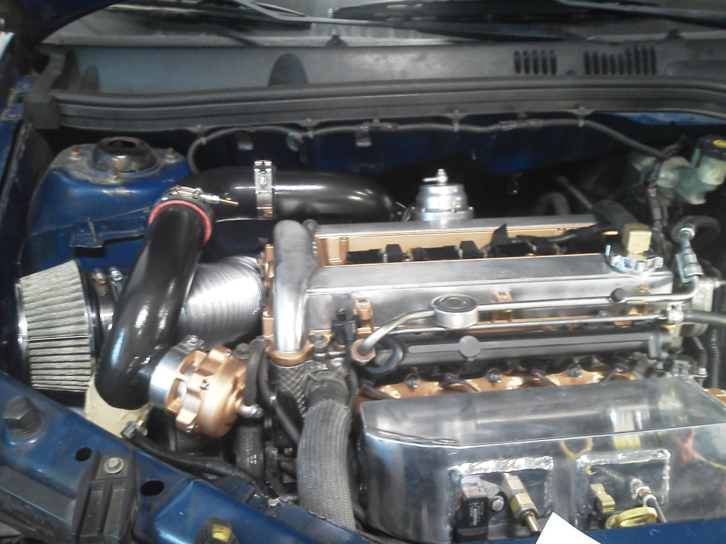

Laaadeedaaaa

nice dryer ducting! hahah.
yeaaahhhhhhh niccaaa! haha
Might fire her up this Saturday possibly sooner depending on work
Oh and that dryer hose is getting heat wrapped and painted

how solid is it? flimsy where it will collapse when the turbo is pulling in a lot of air? and do you have a piece of metal clamped to the filter and then the ducting clamped to that?
I don't know yet thats what I'm wondering myself. If you keep it all pushed together like I have it it's strong I can't crush it with my hands so I doubt it will suck shut at 12-15 psi.
Yeah I have an aluminum piece in there. Thats where the bung is going for the catch can "return line." If I even go that route the hoses might just stay pointed towards the ground forever. Or a big can with a massive breather just for cleanliness' sake.

Ex I got a picture for you then. My dryer vent is perfectly hidden now. if anybody asks me I'm gonna lie my ass off it's aluminum haha

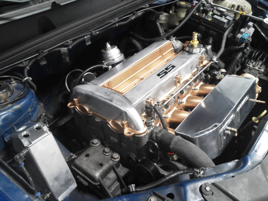

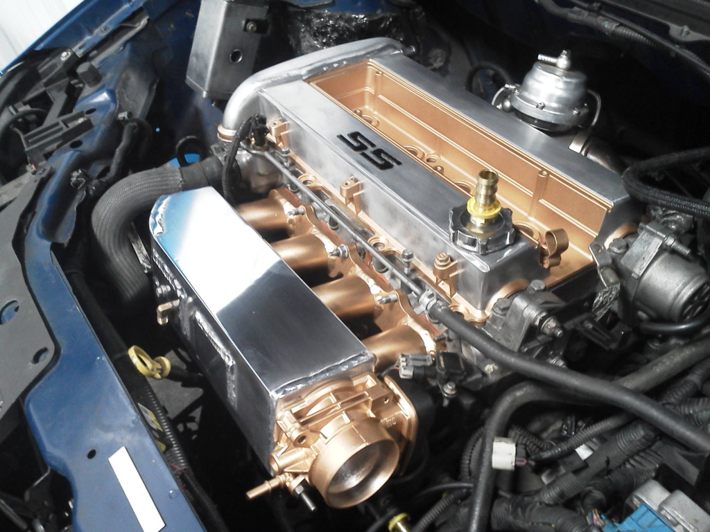

probs some of the nicest colours ive seen doen under the hood.... i LOVE it aha

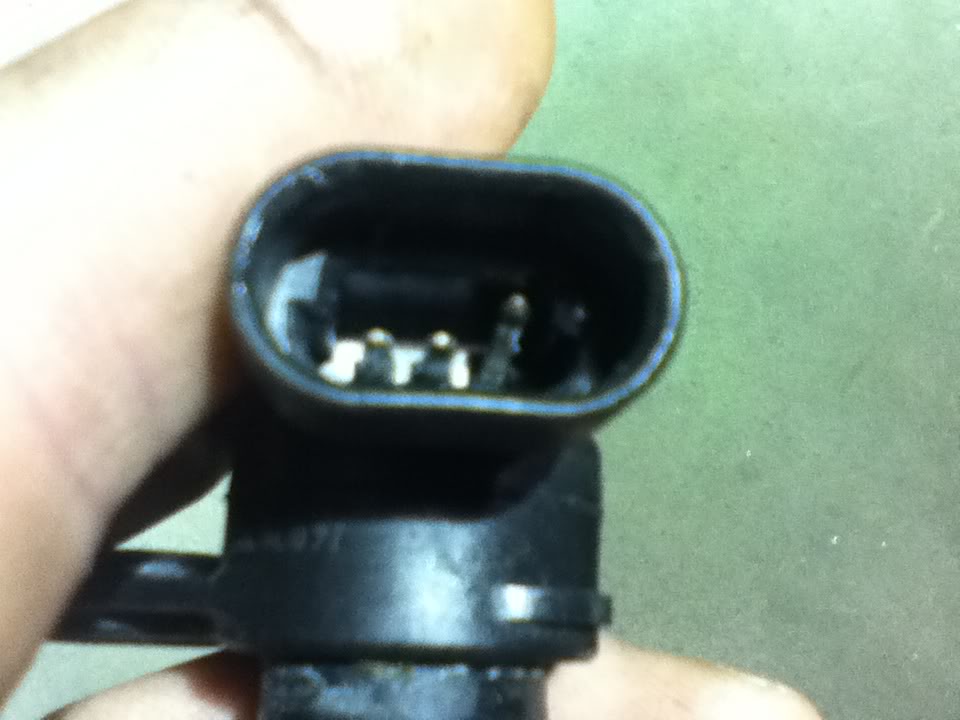

Make sure the pins are all straight on the plug...
I chased myself in circles for a week hunting down a cpa code only to find that.
