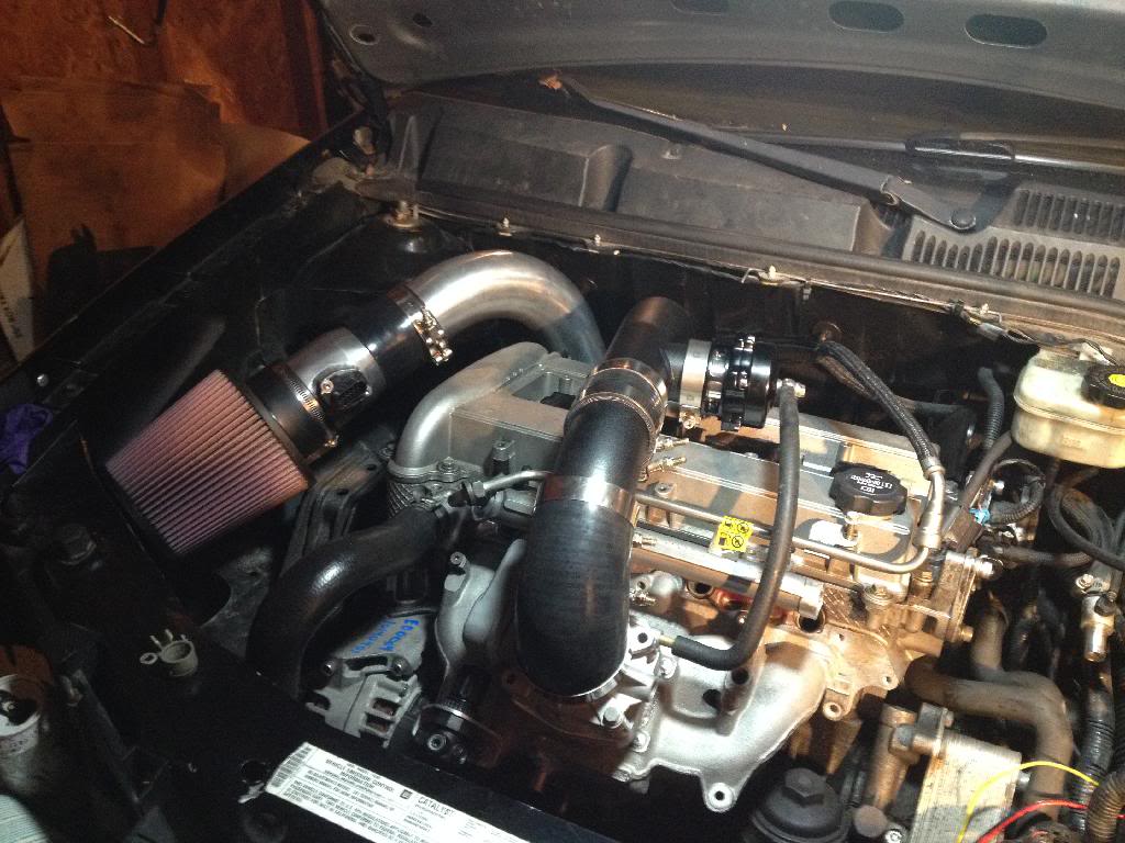

On spring full boost at 3500. On 13# full boost at 3400. Boat starting from full vac at 3k in 3rd. Near instant passing power.
7gph PCI. iat2 rises about 12* in a 3rd gear pull.
You're gonna love it.
Holy **** I had no idea anybody else even did this. Haha you beat me to it! I'm confused as to how you're running that blow off though with your maf positioned pre charger.
I'm going to be injecting five 2gph's (one in each intake runner) and one pre charger that will simply flash off inside the compressor housing and increase the wheels efficiency tremendously. Not all that hot air taking up space between the blades.

A combination of driving style and tuning. I wanted the maf pre turbo so that I could run a heavy meth jets.
Using both maf and ve the rich spike between shifts is minimal.
You just simply don't downshift or "engine break" to slow down.
Having the meth post maf lets you get ballsy with the jets. I'm running 7 PCI for now but will be adding a 5 post and possibly another depending on temps.
Main thing I'm using it for is compressor effeciency. Ethanol is the honey badger of pump fuels when it comes to iat's.

Also, I shimmed the bov spring pretty heavy to make sure it is completely closed at idle. With these new injectors running so smooth I'm pulling over 20" of vac, so bov is set at 24"
It's not as loud as a normal one, but you have to tember it has far less air to "blow off" than a typical fmic setup. So it doesn't hurt that it doesn't open quite as much.
I've dug through the forums and I don't think anyone else has done this here. Let's show them what we're made of
