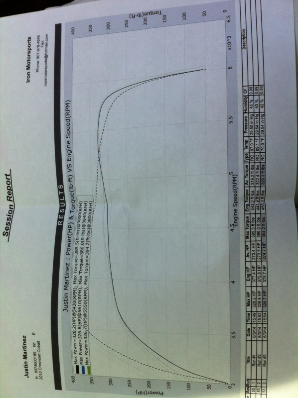

Lnf stock turbo numbers
Just curious to see I got mine on the dyno and the numbers were a lot higher then I was guessing so just seeing what others have with similar mods
Hahn catless dp, exhaust, CAI, charge pipes, trifecta tune 22-23psi.
For some reason it won't let me post the pic of the sheet but hit 328/394

OP what fuel 91 octane? I would love results similar to yours.

Pretty good numbers
That dyno graph dont look too bad for a remote tune

Seems a little high for trifecta, what dyno was it?

What gear

More importantly what correction factor SAE or STD

Probably the only dyno in Alaska? Lol good numbers though.

Dynocom dyno and likely uncorrected numbers. My car on 93 made 362 whp uncorrected on a dynocom. Same tune made 342 whp on a dynojet.

Dynocom dyno and likely uncorrected numbers. My car on 93 made 362 whp uncorrected on a dynocom. Same tune made 342 whp STD corrected on a dynojet.

Those are corrected numbers according to the sheet.
