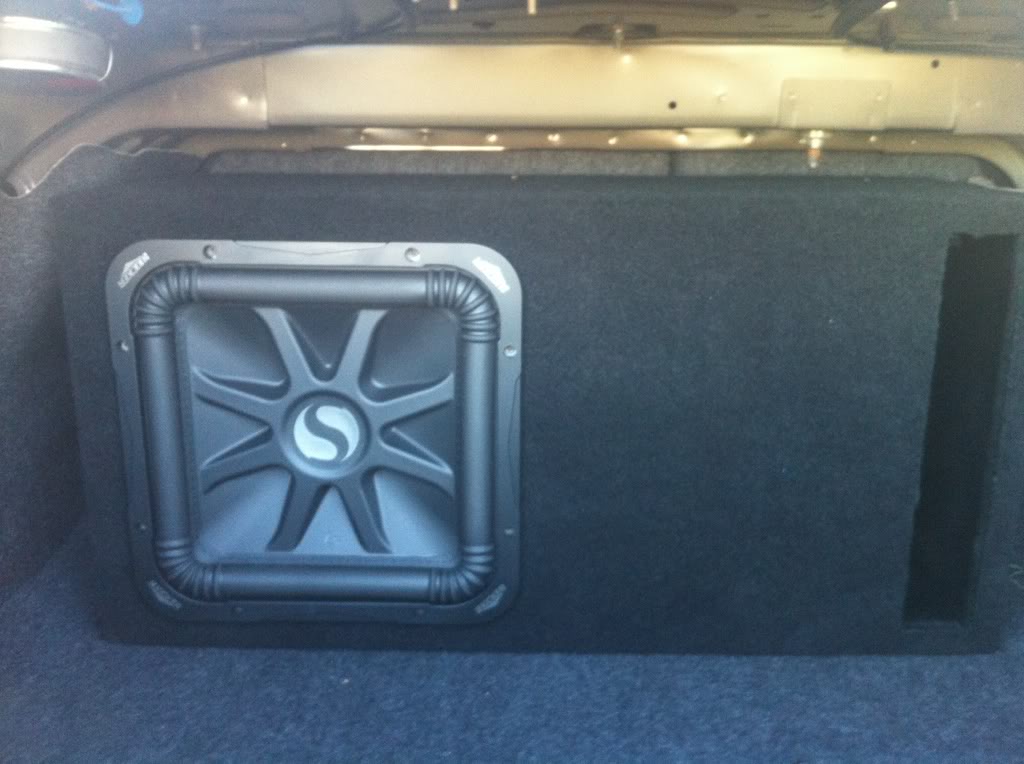

I've got the 12" kicker L5 in a custom box, I love the sound and price was good

looks gud man

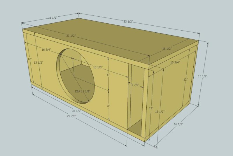

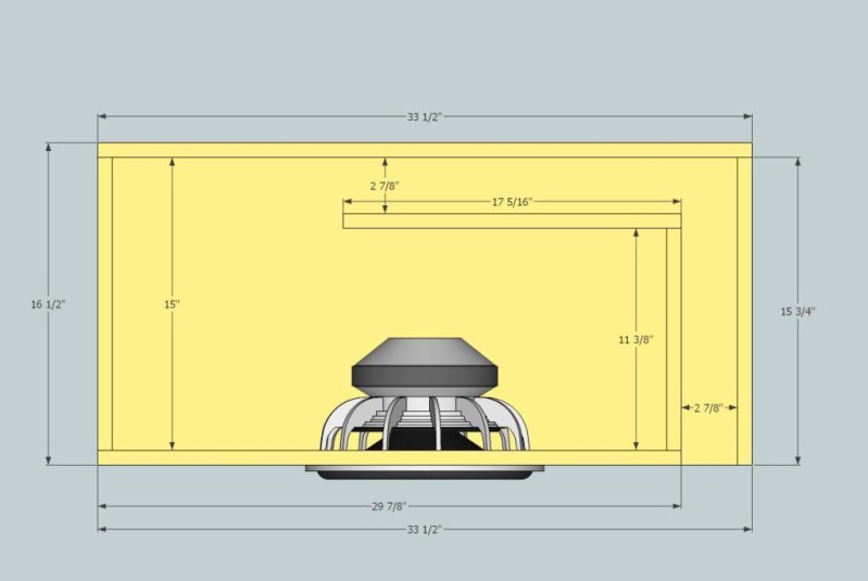

found a design for the box, now just have to see if i can get someone to build it because i dont feel like it haha.

nice lookin schematic. i'm not a fan of bandpass boxesbut to each their own. i hope it works as you imagine it!

i dont know **** about boxes but im pretty sure this is a guy that used to work for fi audio and he has them drawn up for every sub/size so i trust it.
but this is just ported not bandpass if im not mistaken.

Ported.
Correct. @33 inches wide you are not going to have much room between those fenderwells.

yea ported/bandpass are the same in my opinion. i've heard both and i still prefer a good sealed enclosure over either. just personal preference. you going to leave it as a built box or do a custom fiberglass front for it?

Yeah I didn't measure at all, gonna have to check that out haha. And I'm just gonna leave the box

ported and bandpass are completely different.
As far as the box its not too wide that its not going to work but its wide enough that if it were'nt as wide than it would perform better

Yeah you confused me haha. Maybe make it 30in wide?
