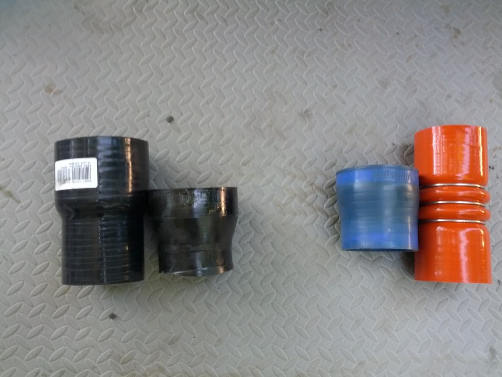

IF that doesn't work, but it should lol, Get some good hump couplers like the one to the far right of the pic.
Some dick never bolted the IC to my car and i found out why real quick when i bolted it up. With the engine movement my pipes would blow off cause the IC wouldn't move with the engine anymore.
The hump coupler will allow a lot of movement and the rings stop it from bulging and blowing off with pressure.

i did the hairspray and havevnt had any problems since.. put those couplers look ideal lol
