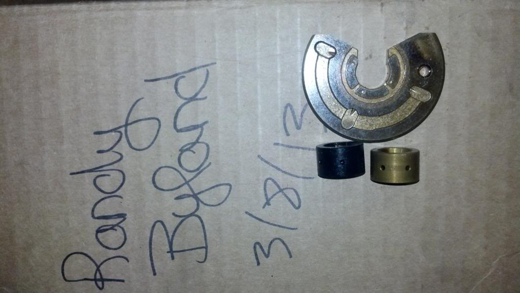

Yep, been there after a year and a half, not nearly as bad as yours though. I did a WOT run and I noticed what sounded like rubbing of the turbo and then took it apart, journal bearings were bad. You might need more than rebuild, shaft and wheel is gone I'll bet, new cartridge assembly more than likely.
Thought it was an oiling issue, made some changes to it and a year and a half later, here we are again !
you been tuned ? other than the zzp canned tune ?
With some help and advice we are going to be watching EGT's as I think they are too high, over heating the turbine wheel and coking up the journal bearings on that side.
I installed an EGT probe right before turbo so we'll see what goes on when its running, hope this weekend.
Here is what it looked like this time.
Turbine side bearing on the left, compressor side on the right.
There's almost no way on a running engine that you will see that happen to a bushing like that. Looks as if it needed more cool-down time if anything. Maybe the big back housings and cast manifolds are holding too much heat and boiling the oil anyway even after an idle-down time. It only takes 350+ degrees to start to compromise the oil, and there's plenty of heat in that metal even from normal use.
These cars don't have oil problems, the oil pressure is very high and they flow well, unless for some reason the supply line/fitting that ZZP is using is too restrictive, but they usually think things through better than that in my experience.
