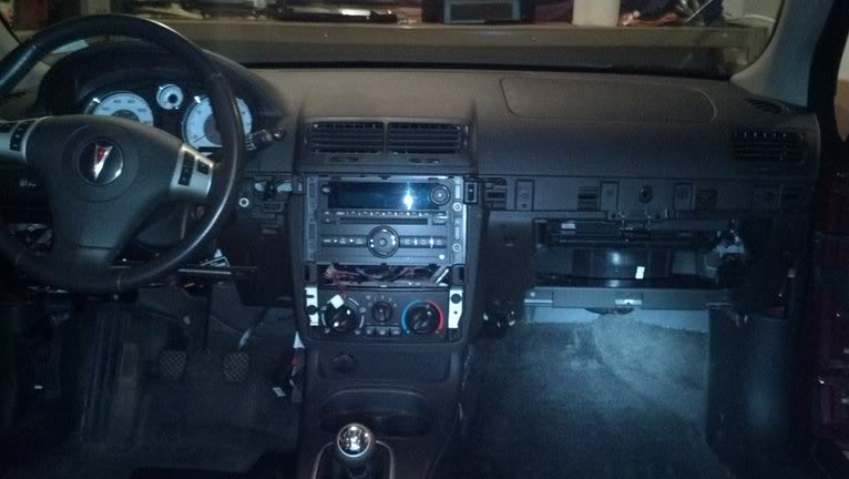

Your heater core is probably fine, unless it is plugged. How many miles are on your car, and has the coolant system ever been flushed? If you're near 100,000 miles (161,000 km), it is time to have it flushed.
The heater core is always hot when the engine is running, so you might want to check the operation of the flapper/door that controls the flow of air over the core. If the actuator is bad or the door is jammed, you won't get full heat. You can access those without taking the dash apart.
If you haven't changed the cabin air filter within the last 8-12 months.... do it now.
If you still want advice on how to replace the heater core, let me know. I've been in there before. It is at least an 8 hr job, but you don't need to remove the entire hvac box. There are a bunch of plastic rivets that you chisel off (probably 8-12 of them) to gain access to the heater core. When reassembling, there are screw holes already molded into the sections of the box in place of the rivets you chiseled off. Much of the lower dash needs to be removed, and you'll want to remove the front seats so that you can lay down on the floor to work. There is also a plastic bracket that mounts a fuel line to the firewall that needs to be removed (yeah, crazy, I know).
