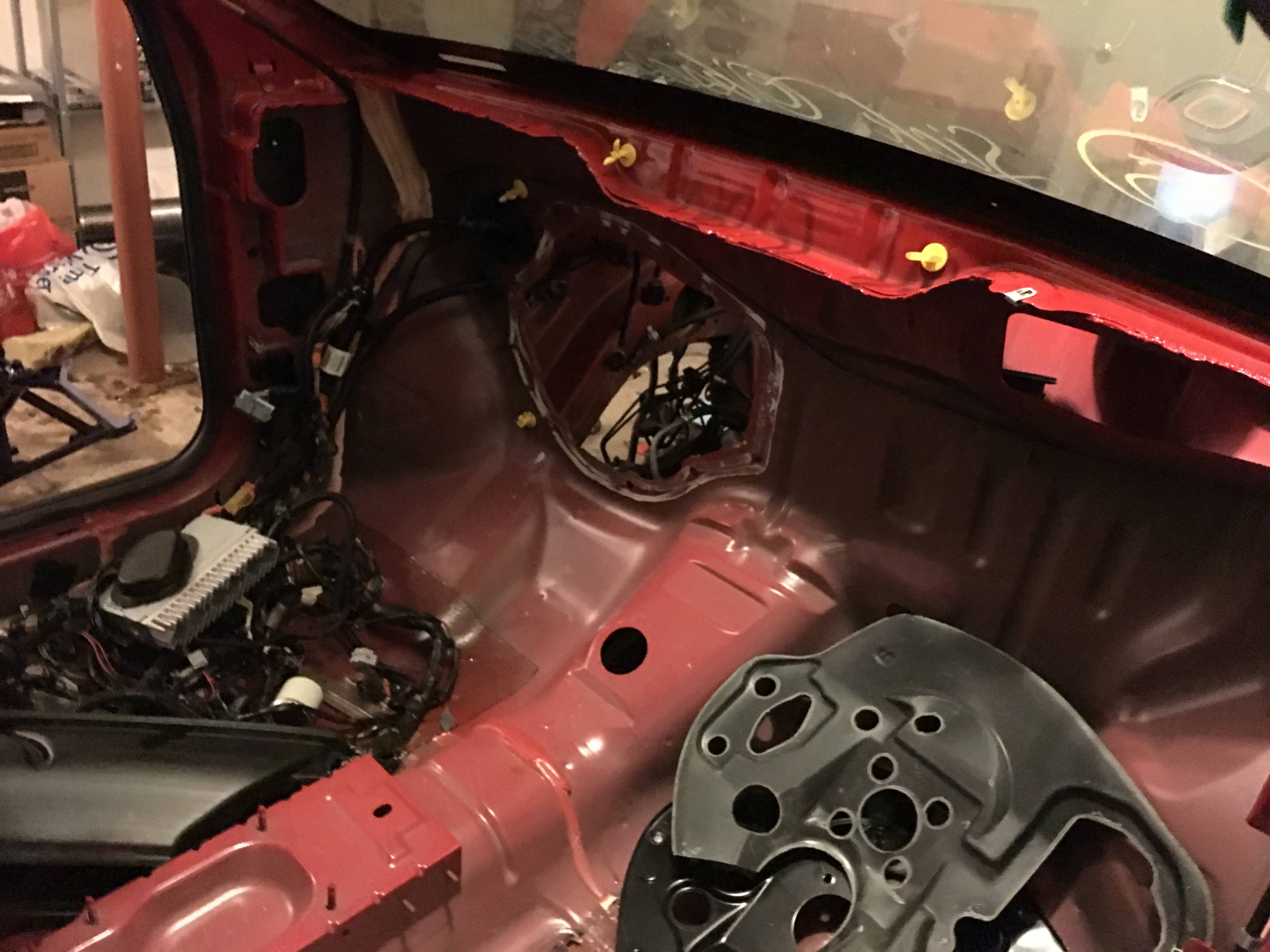

May 12, 2016 (had a wedding after I purchased the donor, also there was a bit of a wait on production. They had build their first batch of 10 production frames and were working on the tooling for the future frames)
Hey guys, wanted to post a quick update. I am almost finished stripping the entire car. I have cut off the front support beam and all that is left is to to remove the wiring harness and subframe with engine. Can't wait to get the frame and start building!
Also, selling old parts has been a great success, I have almost collected almost $2000 at this point! Hoping to get another $500 with the remaining parts which would put the net cost of the donor at about $1500!

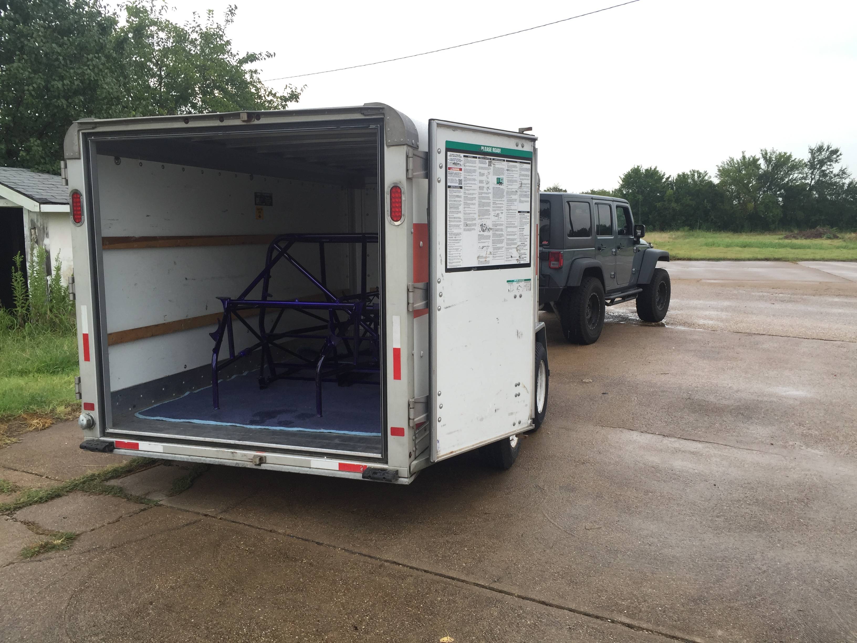

July 20th. 2016

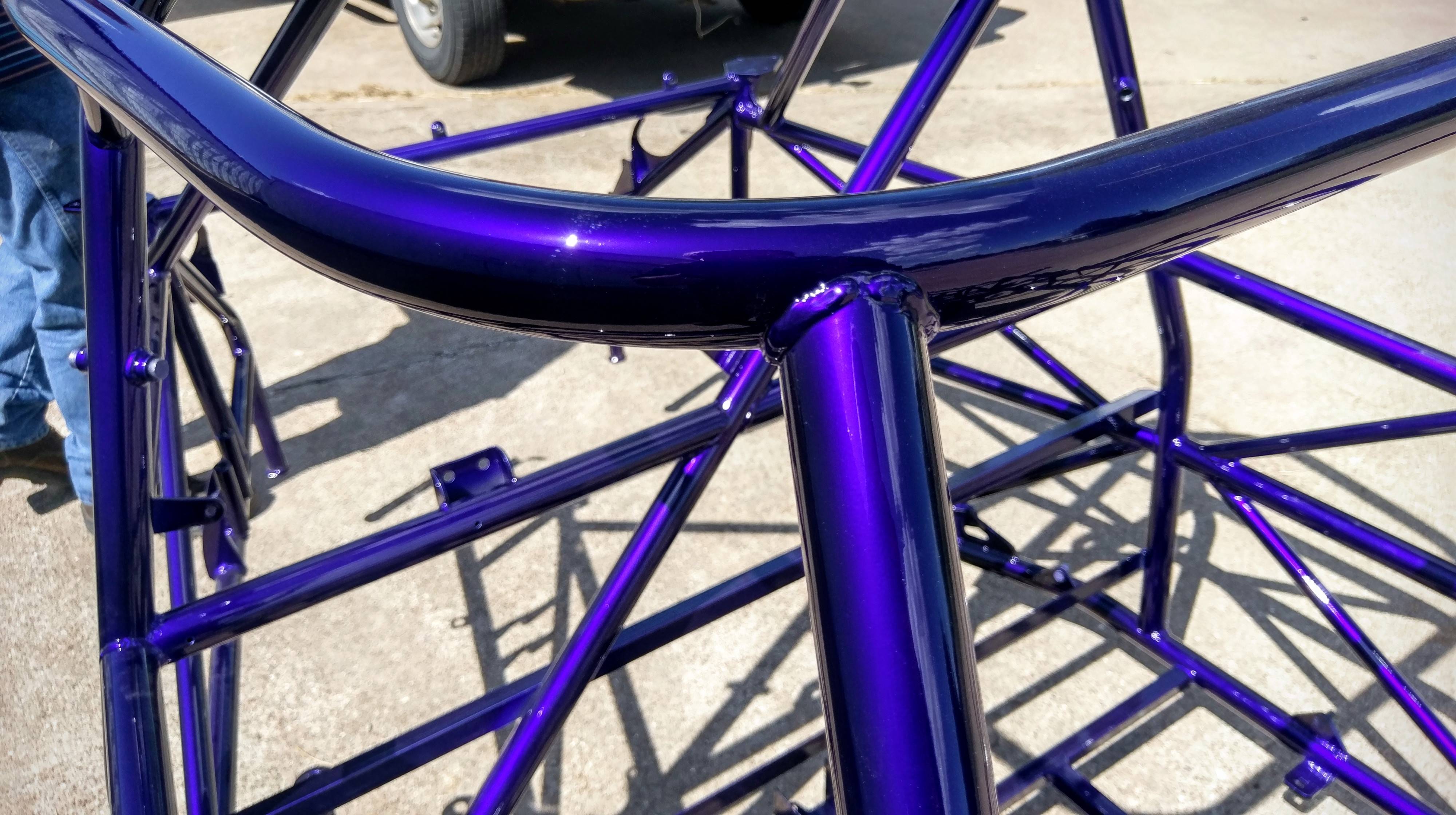

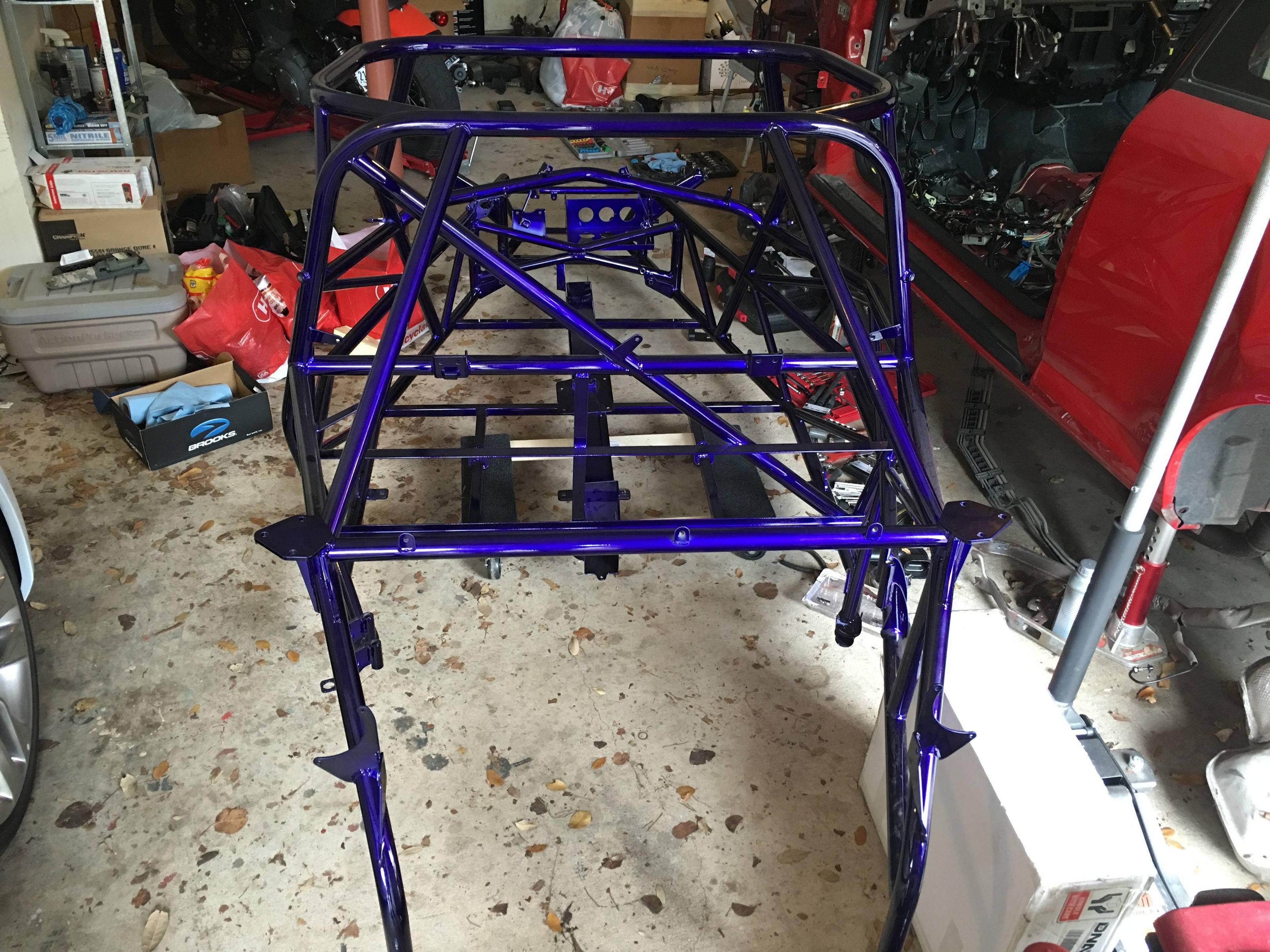

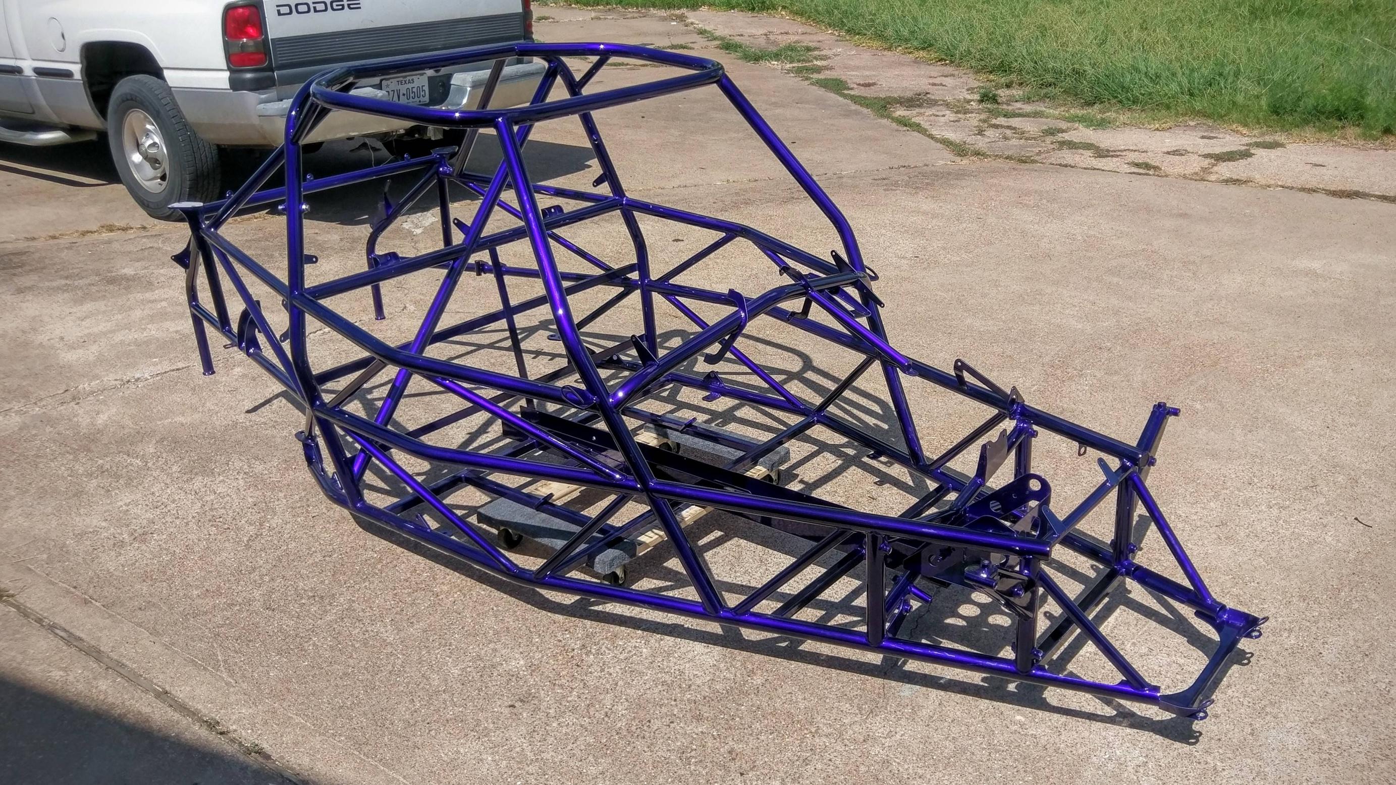

My frame for my car just got built up. I took some screencaps from the webcam that they have set up and also had Adam send me some pictures. Also decided on Illusion Blue for the powder coat!
Pictures of Illusion Blue powdercoat finish

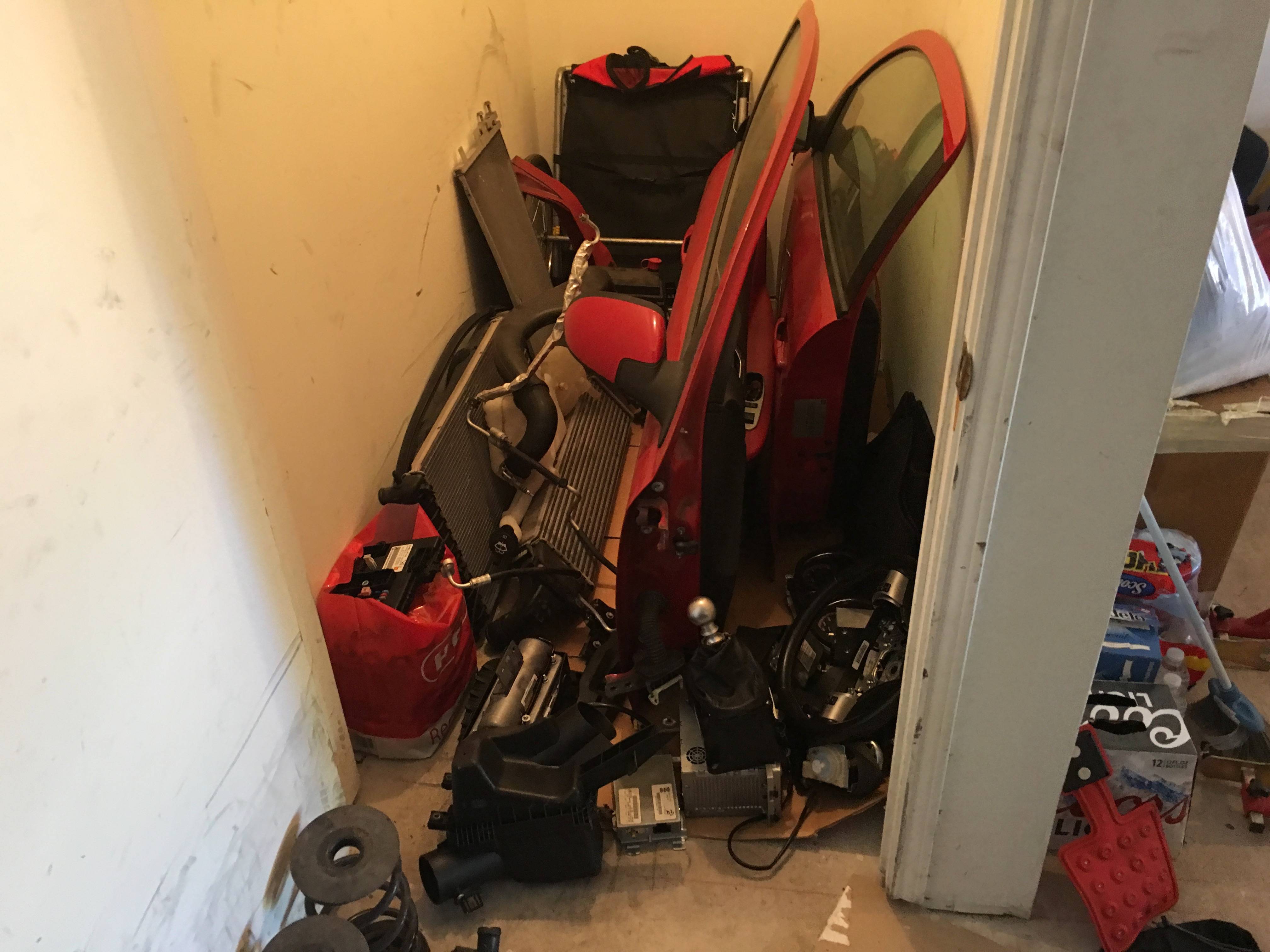

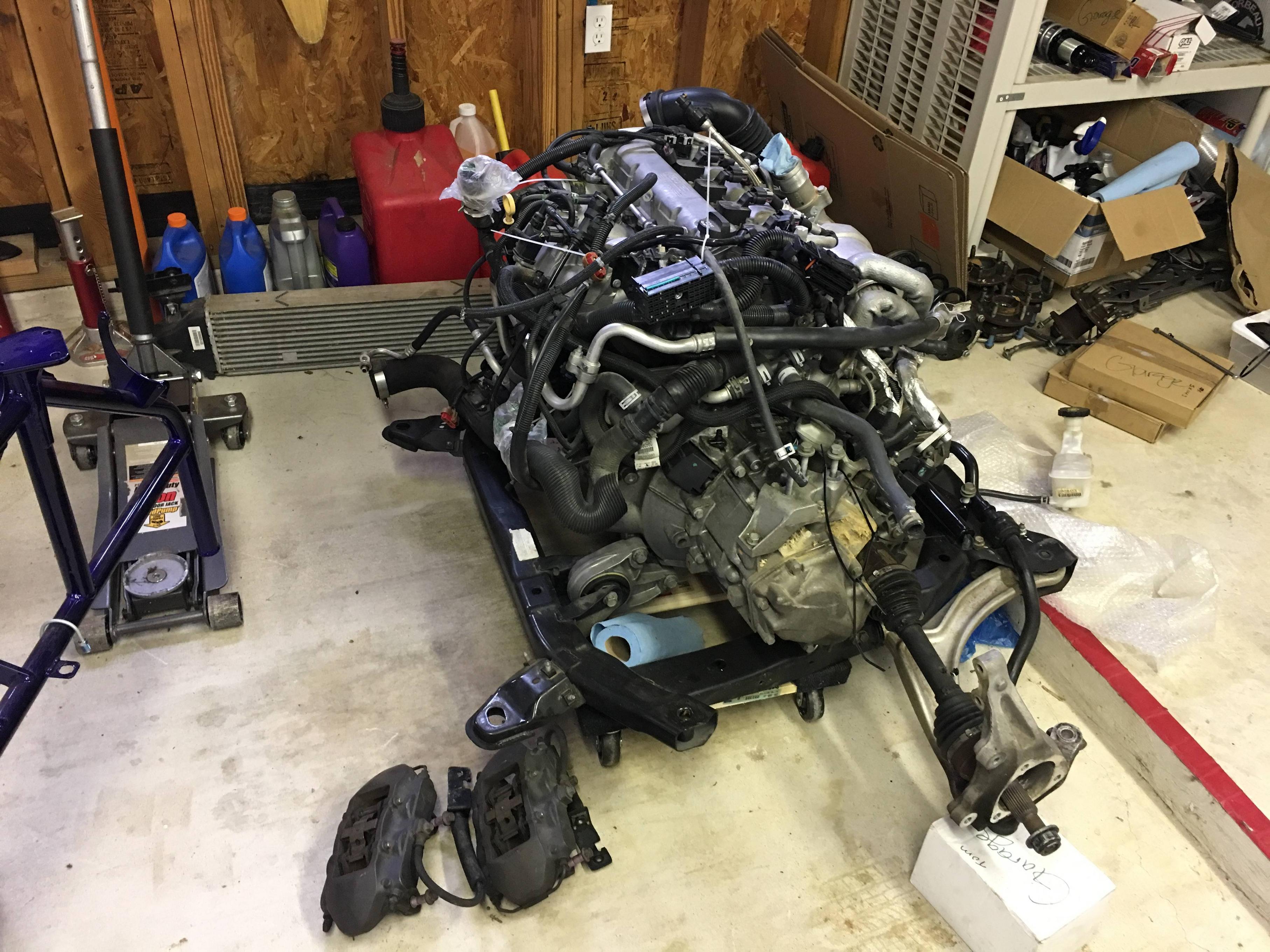

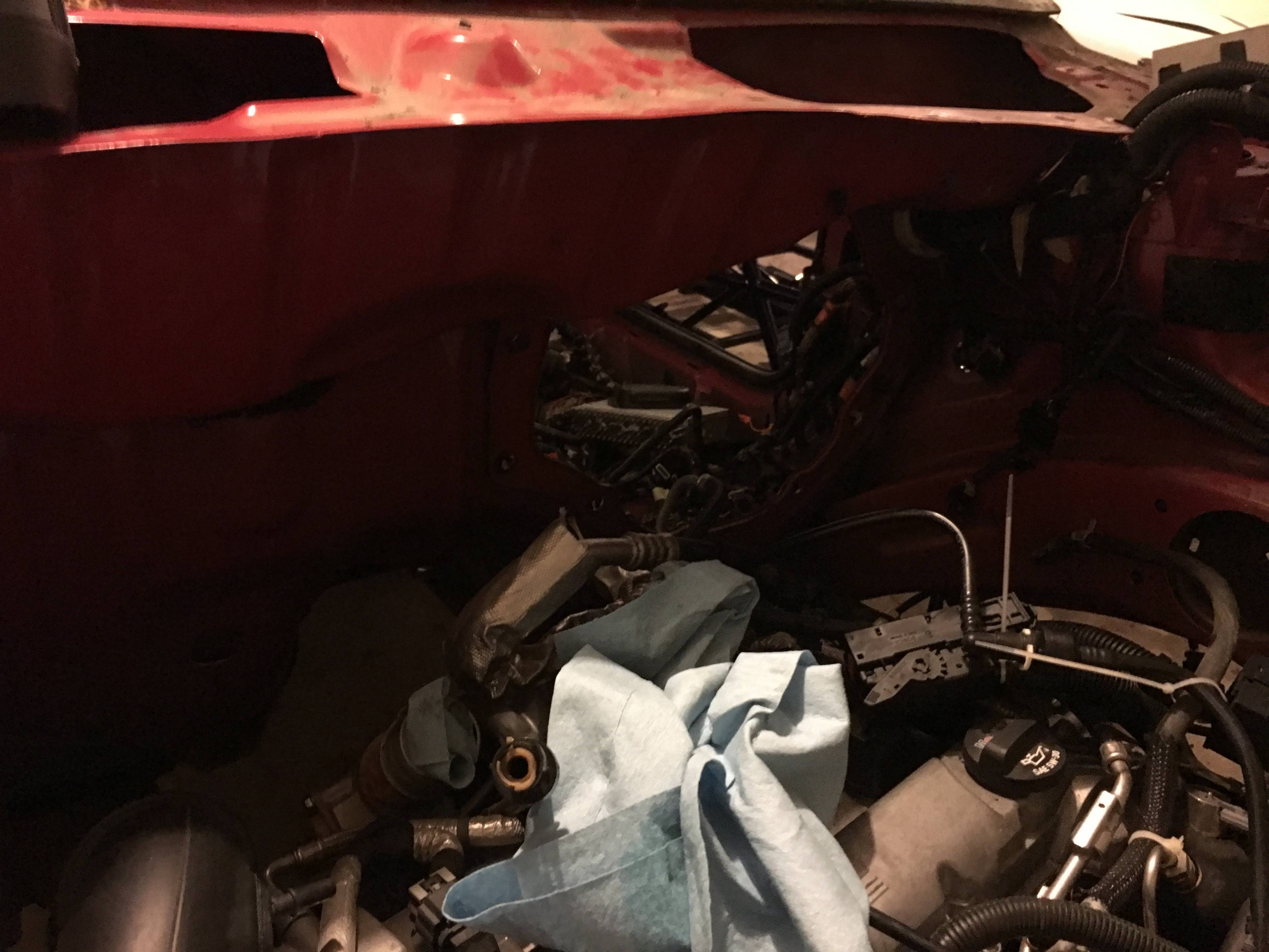

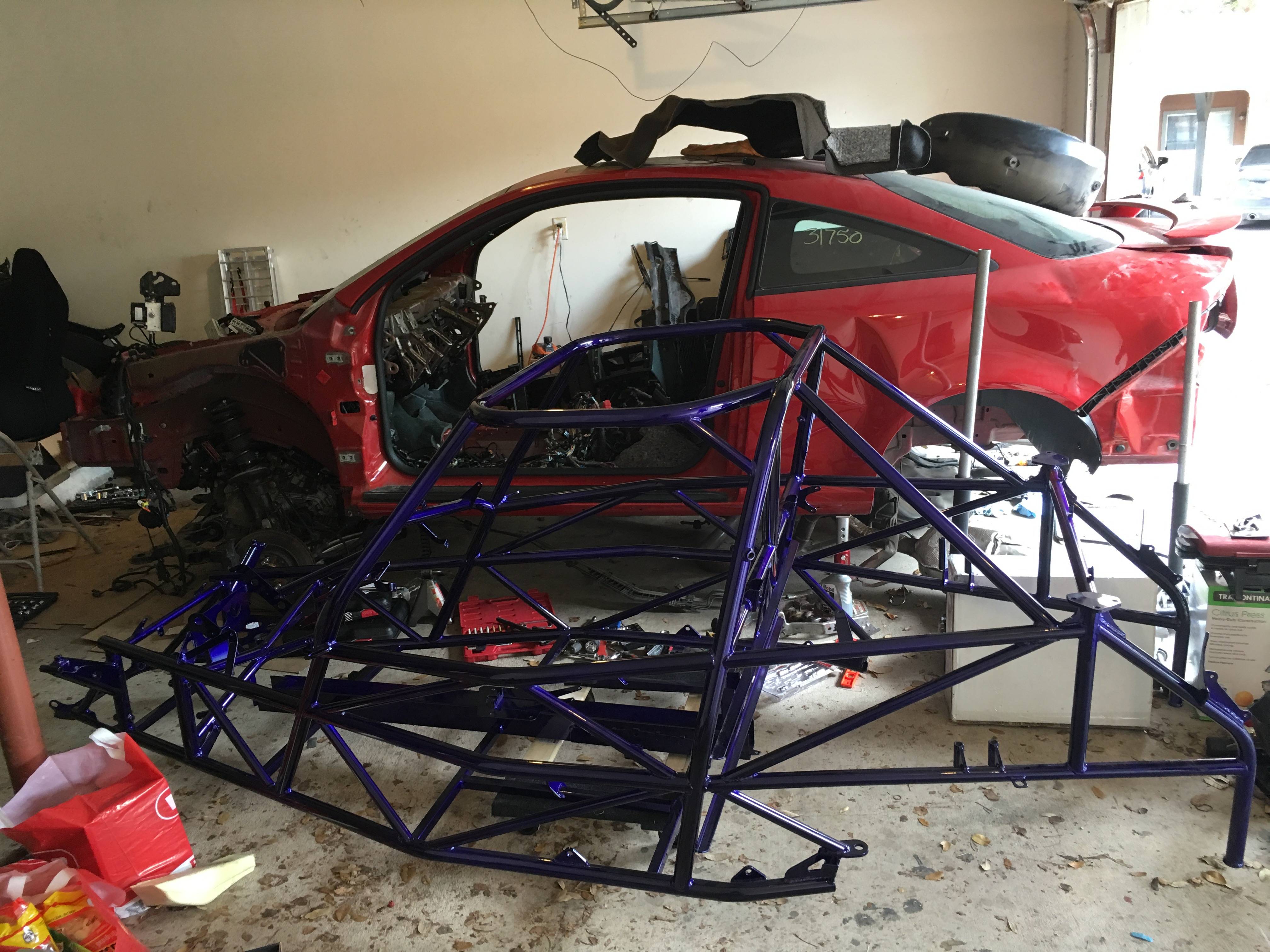

And building on that, I kicked my tail into high gear to finish stripping my donor. Ended working till 4am on Saturday morning dropping the motor and removing any remaining hoses, tank, etc. All that remains at this point is dash assembly to release the rest of the wiring harness.
Also to note, removed the engine and subframe by lowering the car onto two small furniture dollies, and then lifting the car away. I was then able to roll the assembly away from the car. Almost time to dump the chassis!

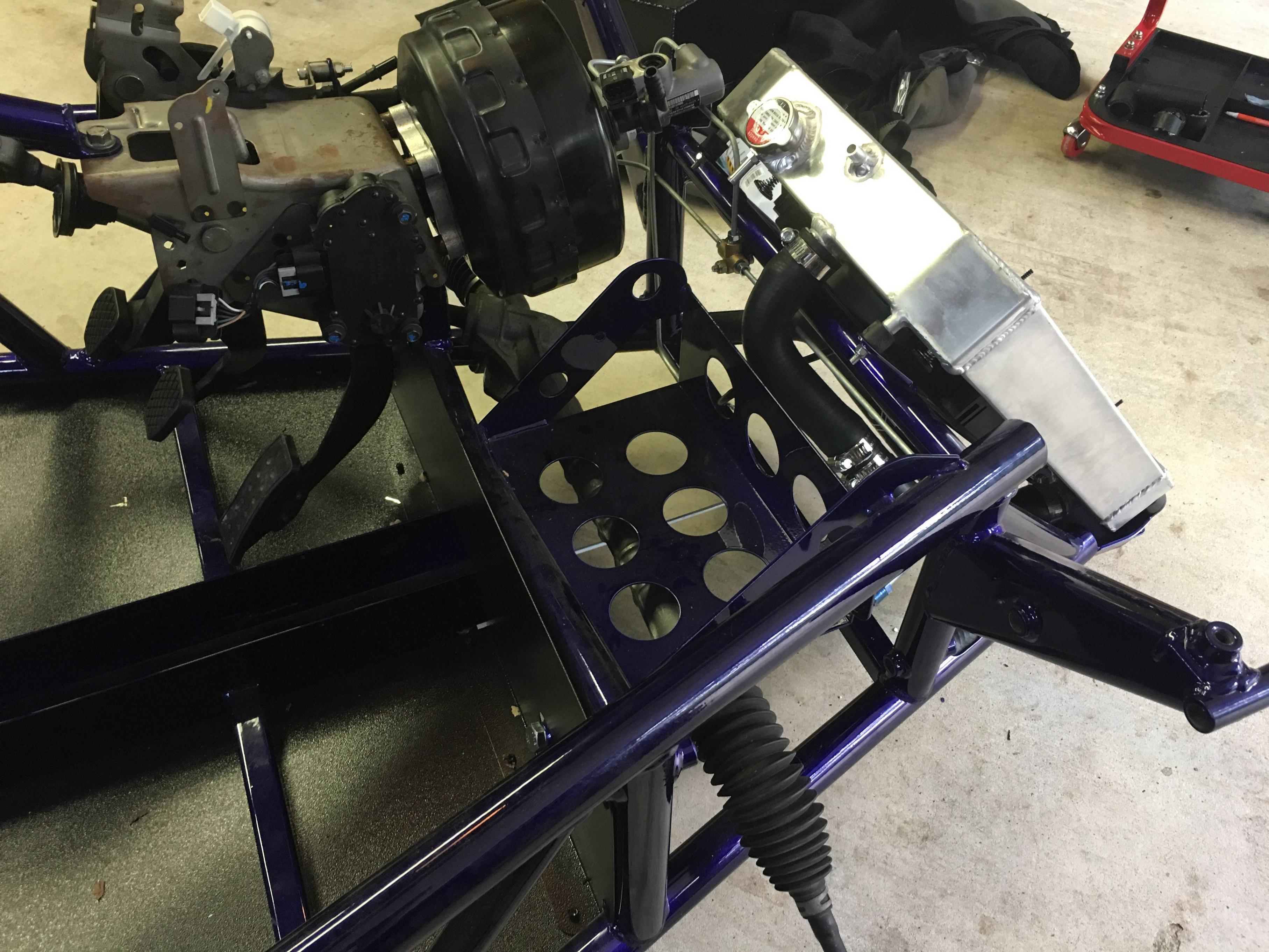

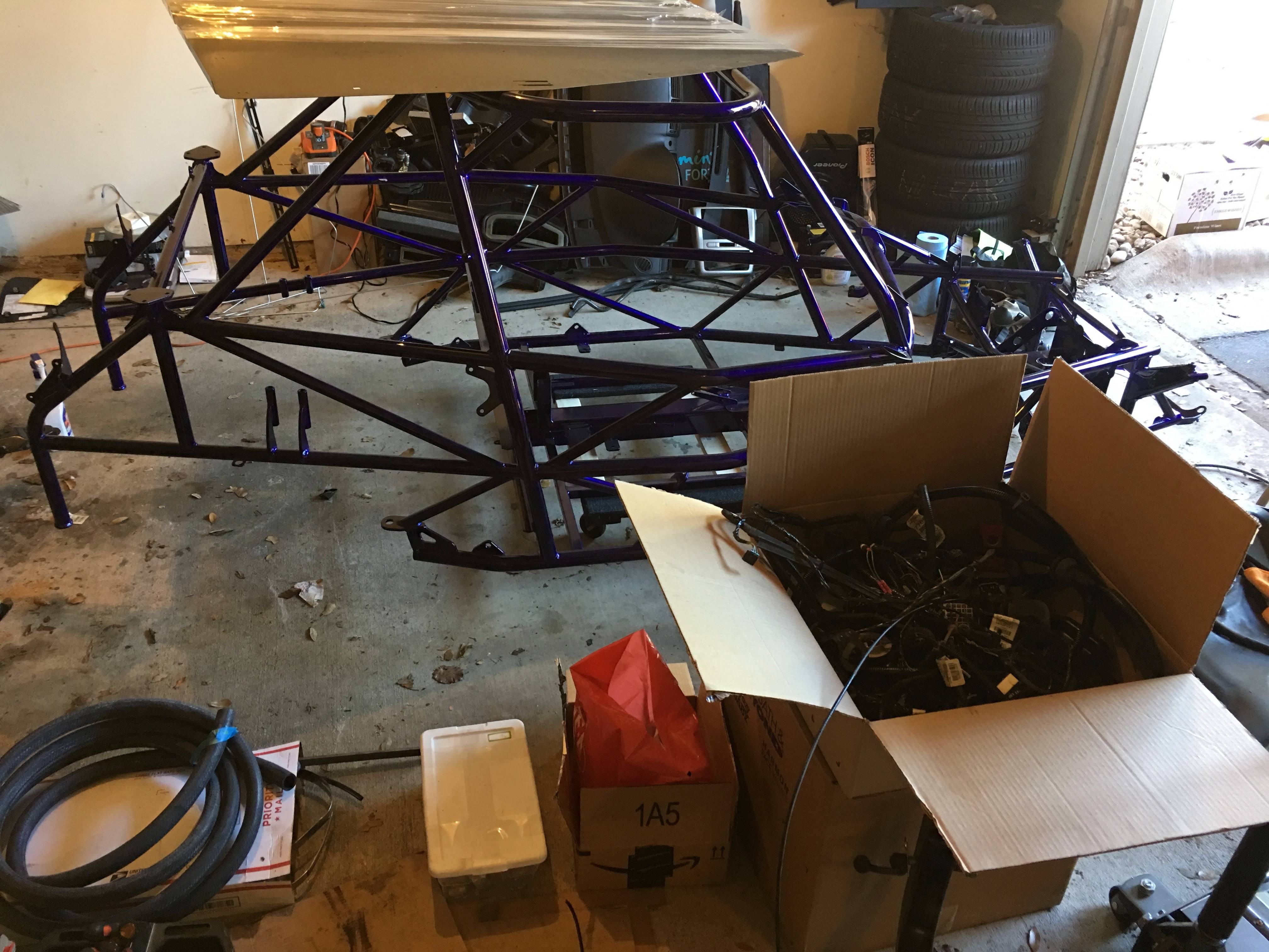

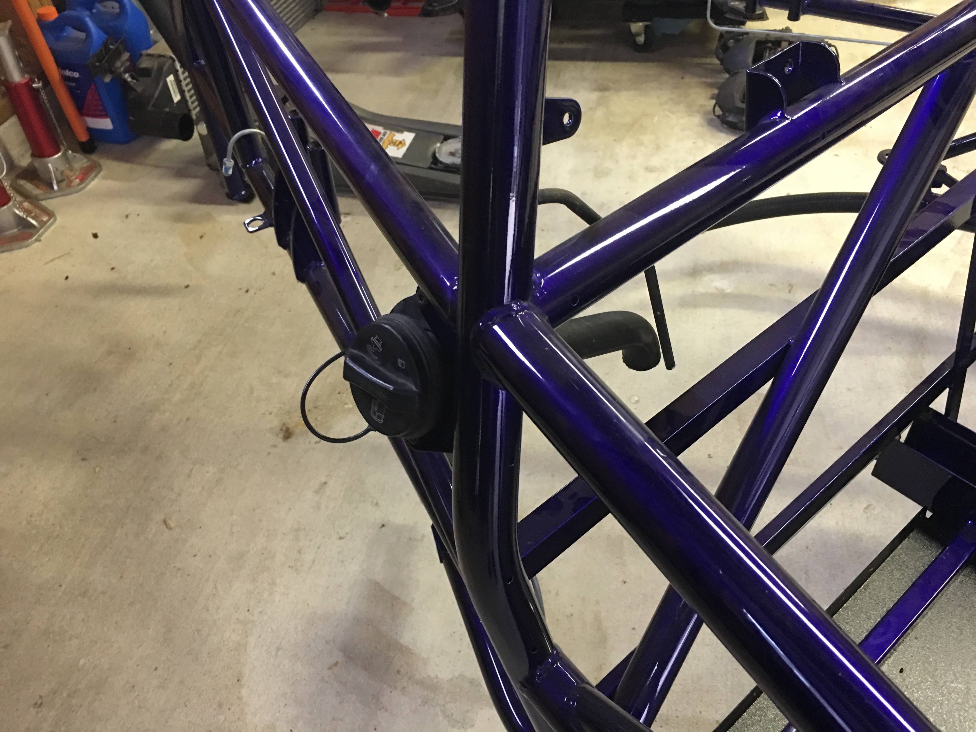

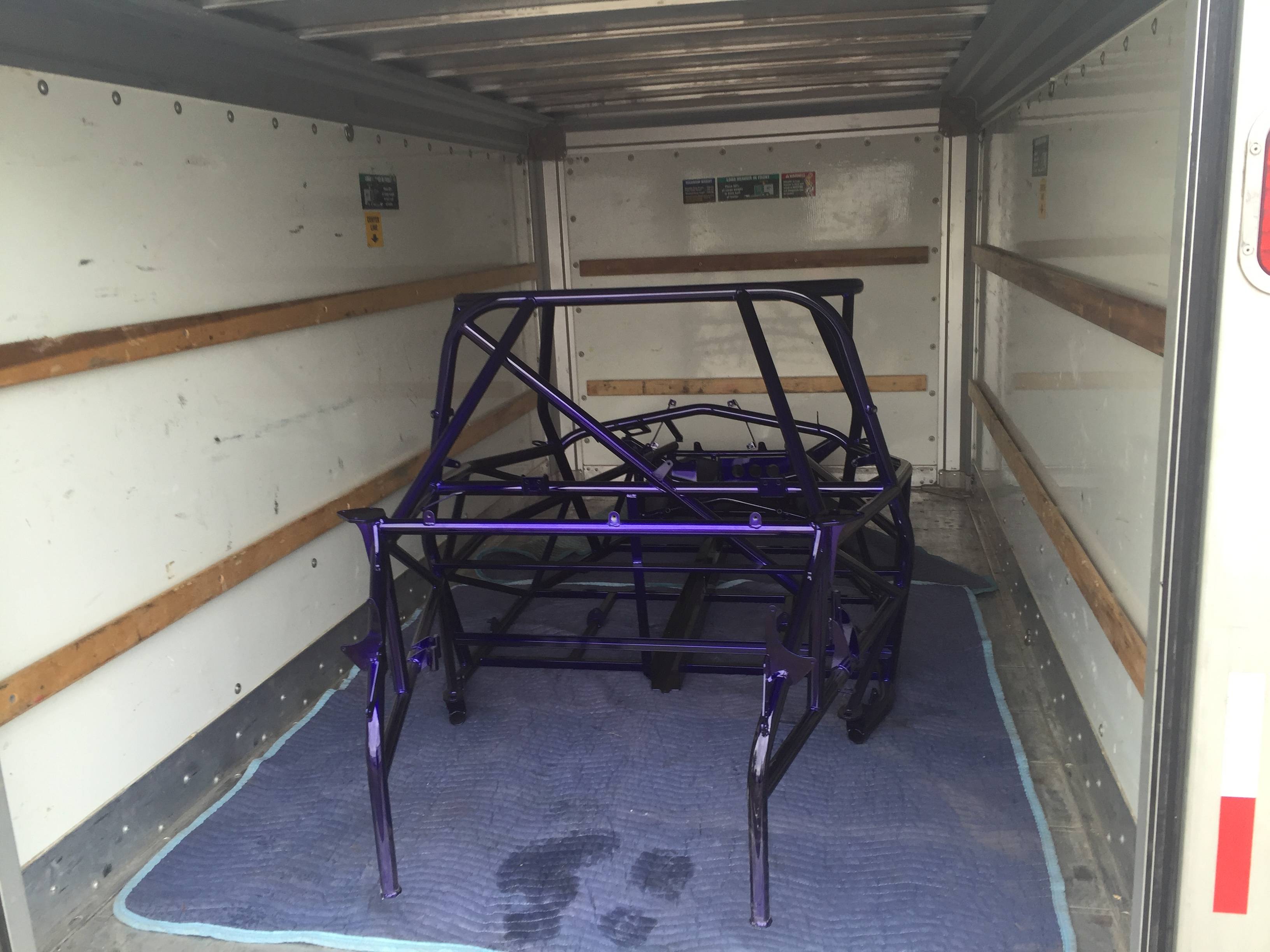

Time for an update! I picked up my frame from Adam about 2 months about and it looks awesome. Started a new job so I haven't had much time to work on it, but finally finished taking out the dash from the donor. The scarp body is ready to be hauled away finally!!

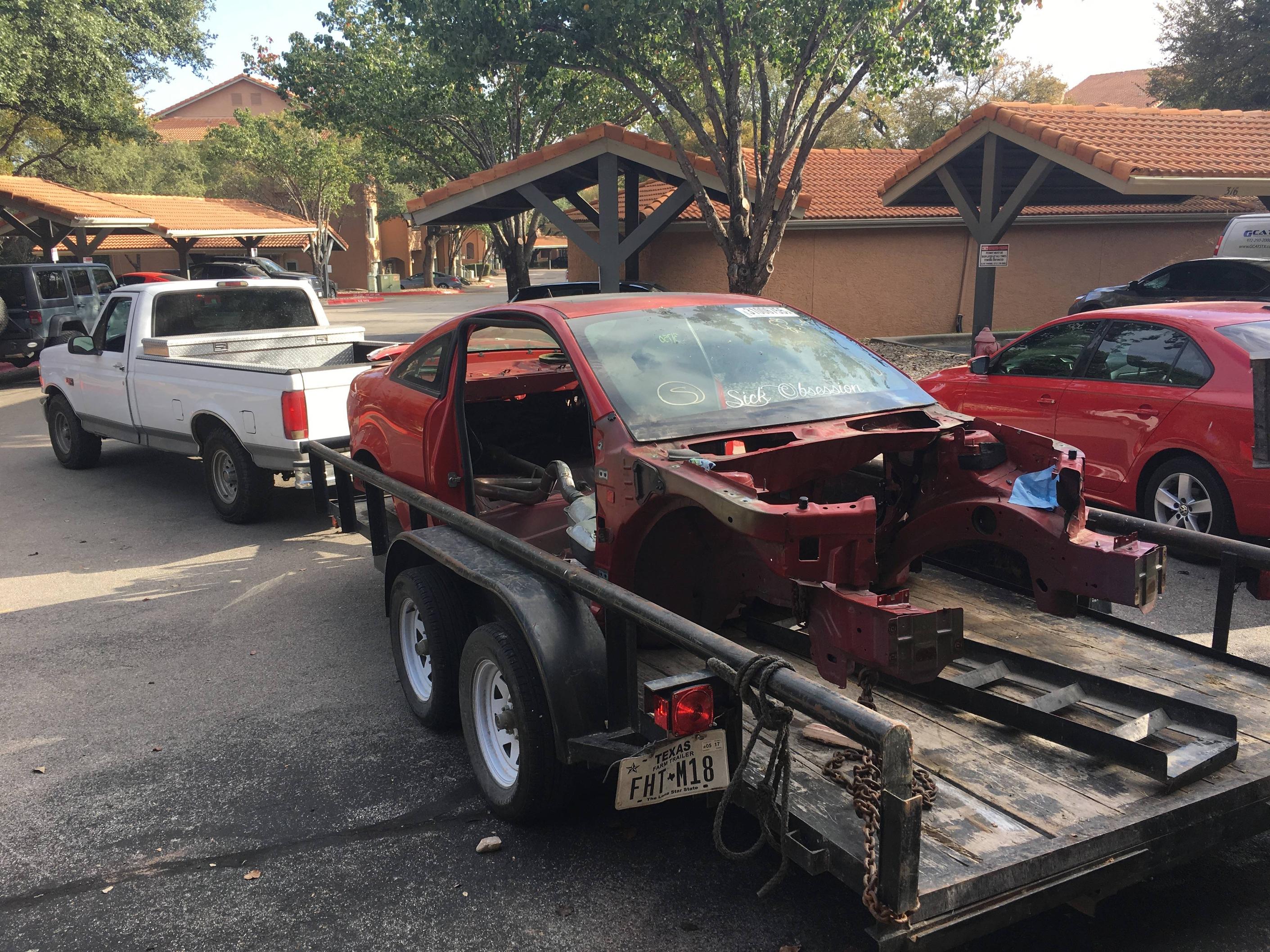

Finally got rid of the donor chassis. Tried out Facebook classifieds after not having luck on Craigslist and it was gone in a matter of days, at no cost to me. Did some much needed garage cleaning and reorganizing of my tools. Started test fitting the brake lines and riveted the front bulkhead.

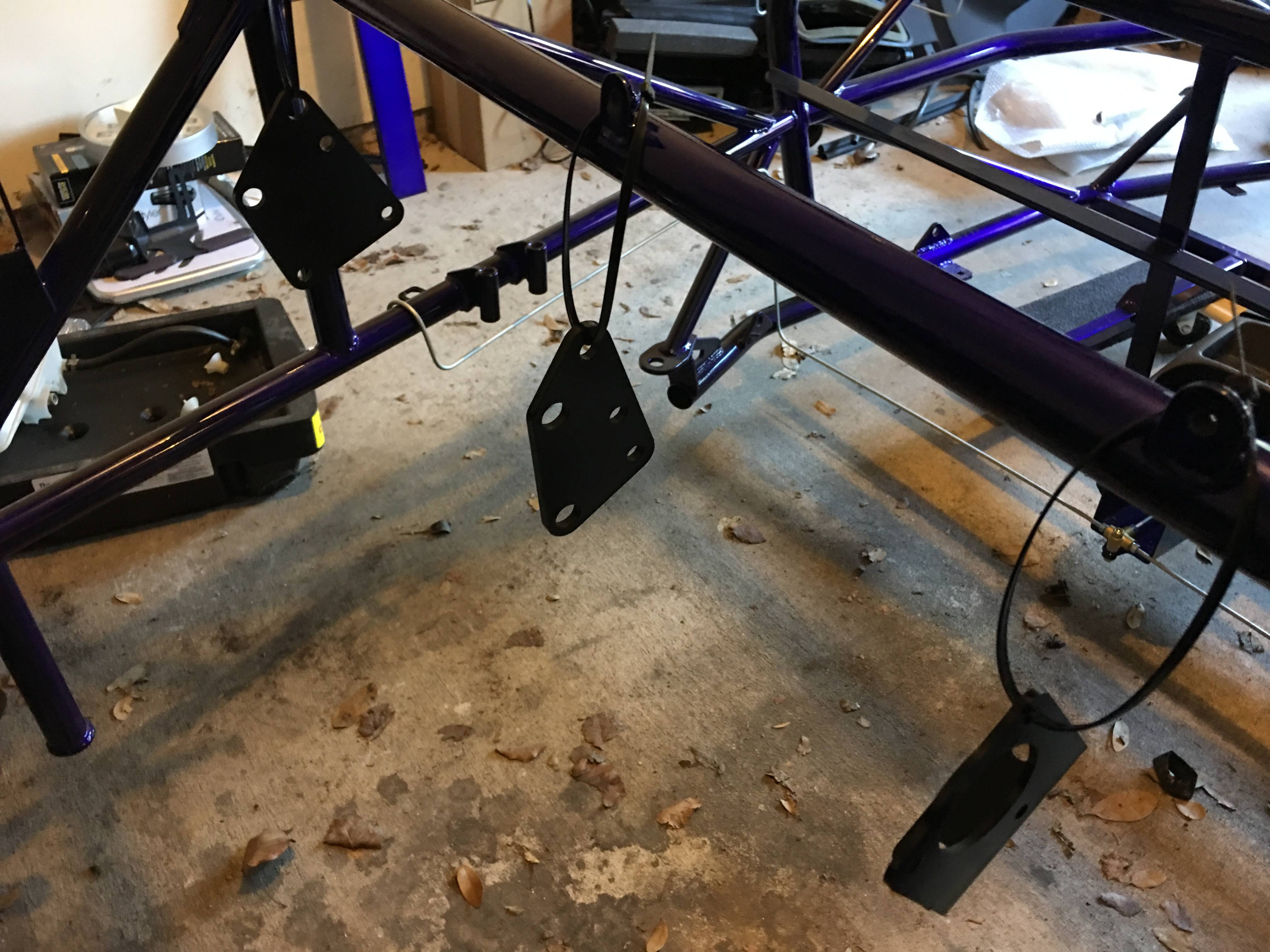

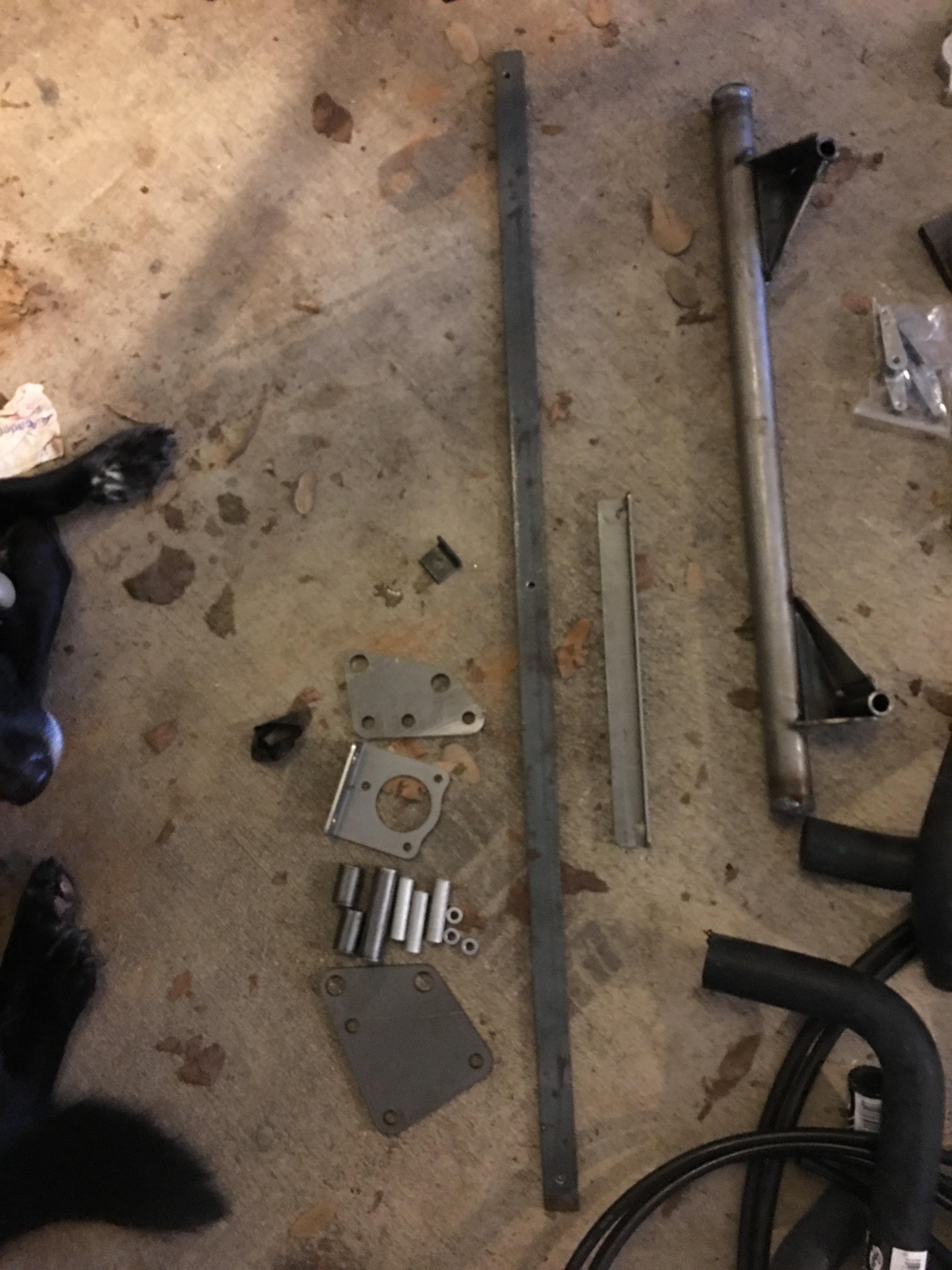

Wow time for a mega update. Project was put on hold while I changed jobs at end of 2016 and purchased my first home this past May. Lots of time was spent organizing the garage to make the build process easier. This past weekend my wife was out of town and I worked like a madman for over 40 hours and accomplished a lot.
March 2017

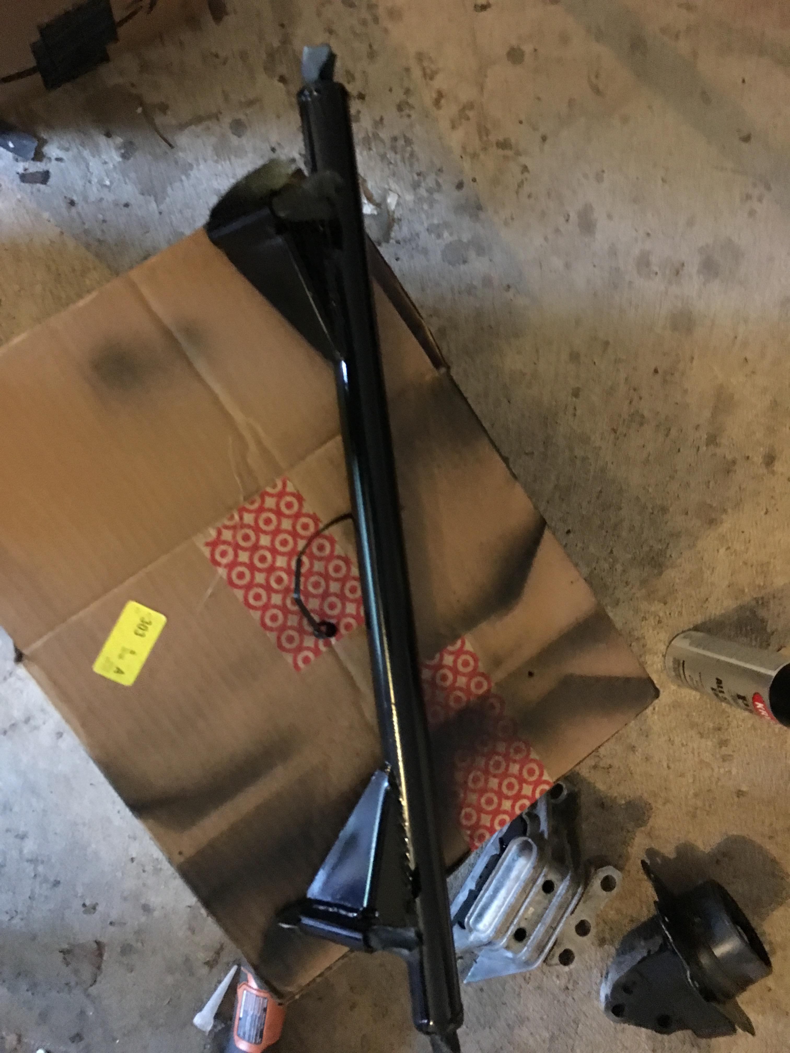

Received stage 2 parts and determined what needed to be painted/powder coated, ended up just going with some primer and spray can bedliner.

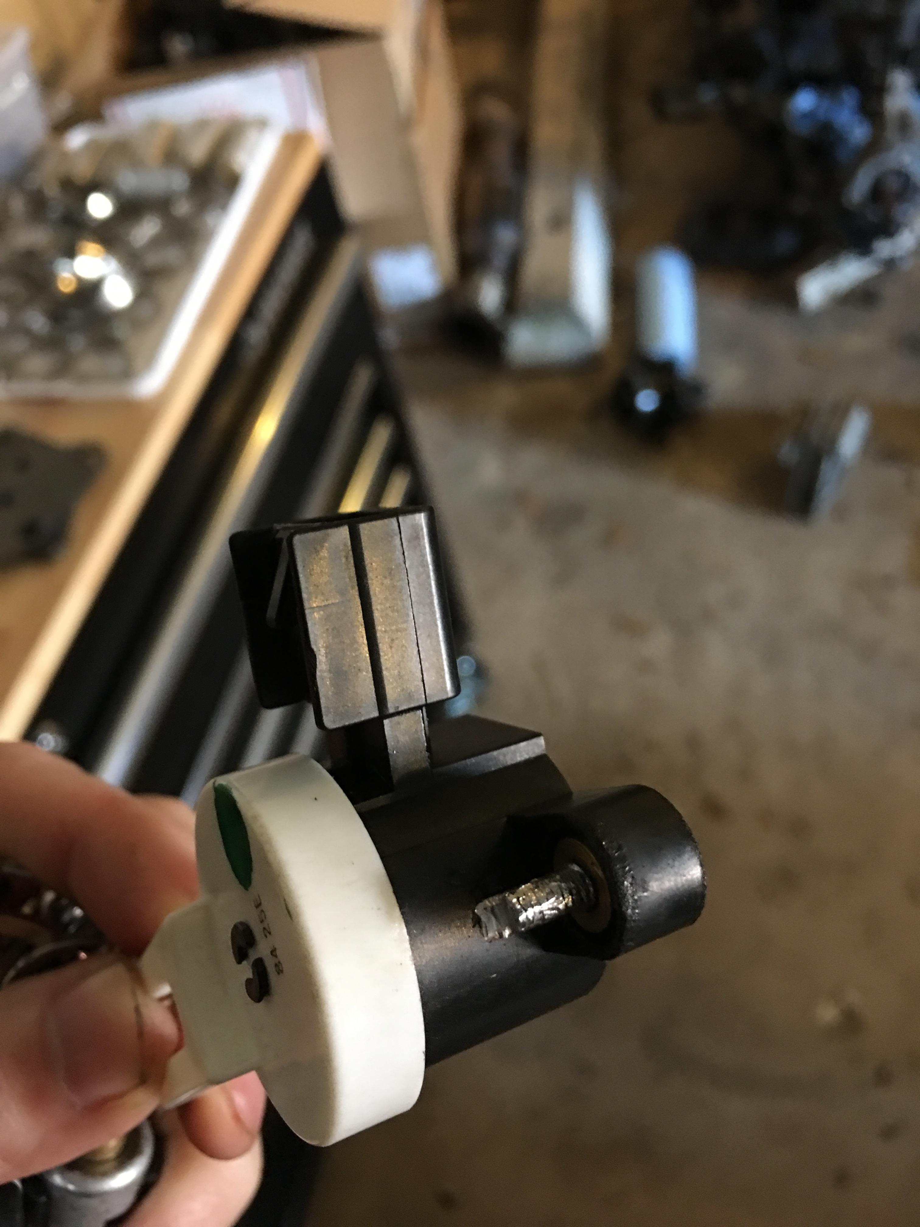

While disassembling the brake position sensor from the pedal box for painting, the head sheared off. I tried cutting a notch for a screwdriver or pliers, but no luck. Will likely just order one from eBay.

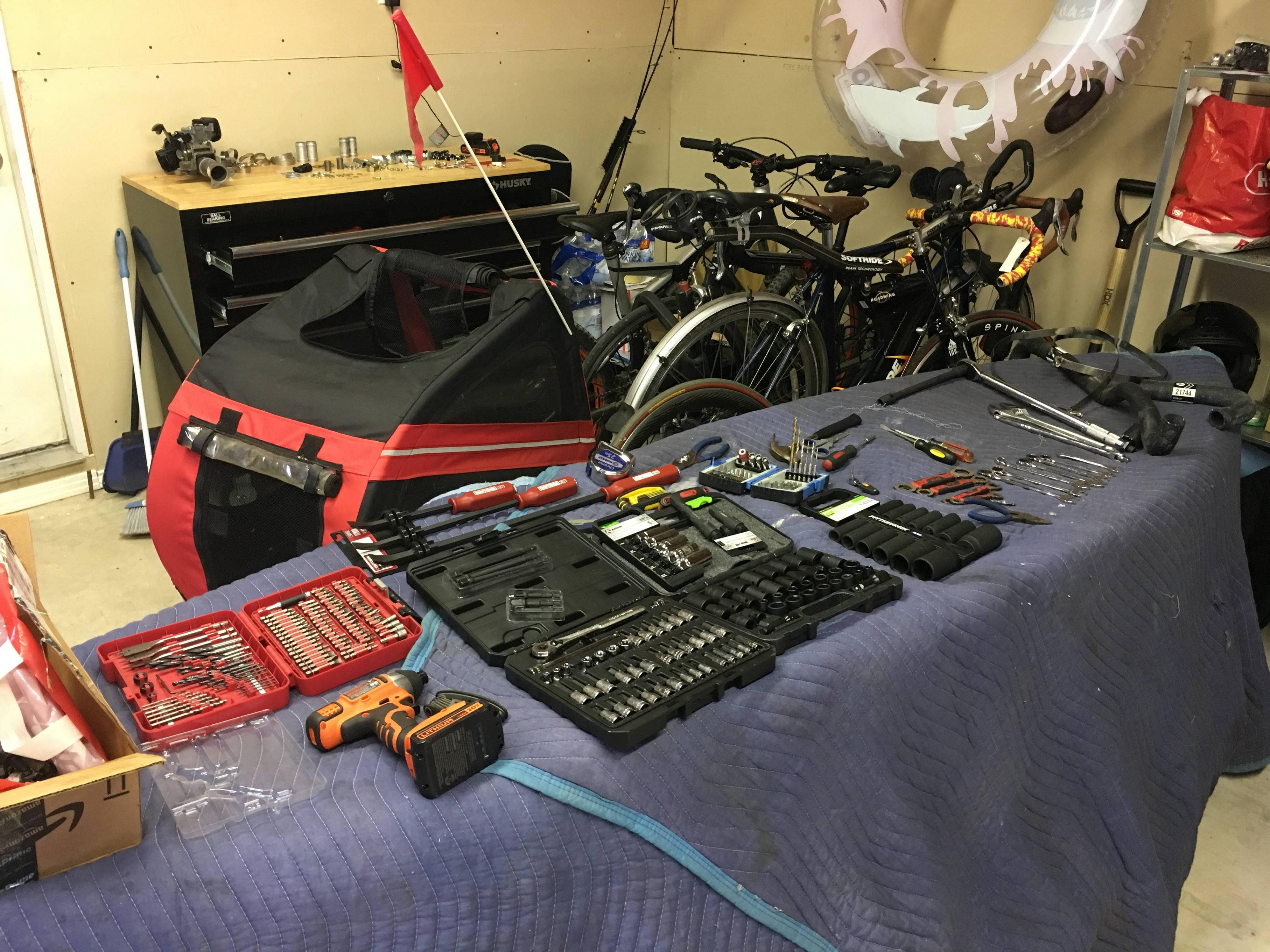

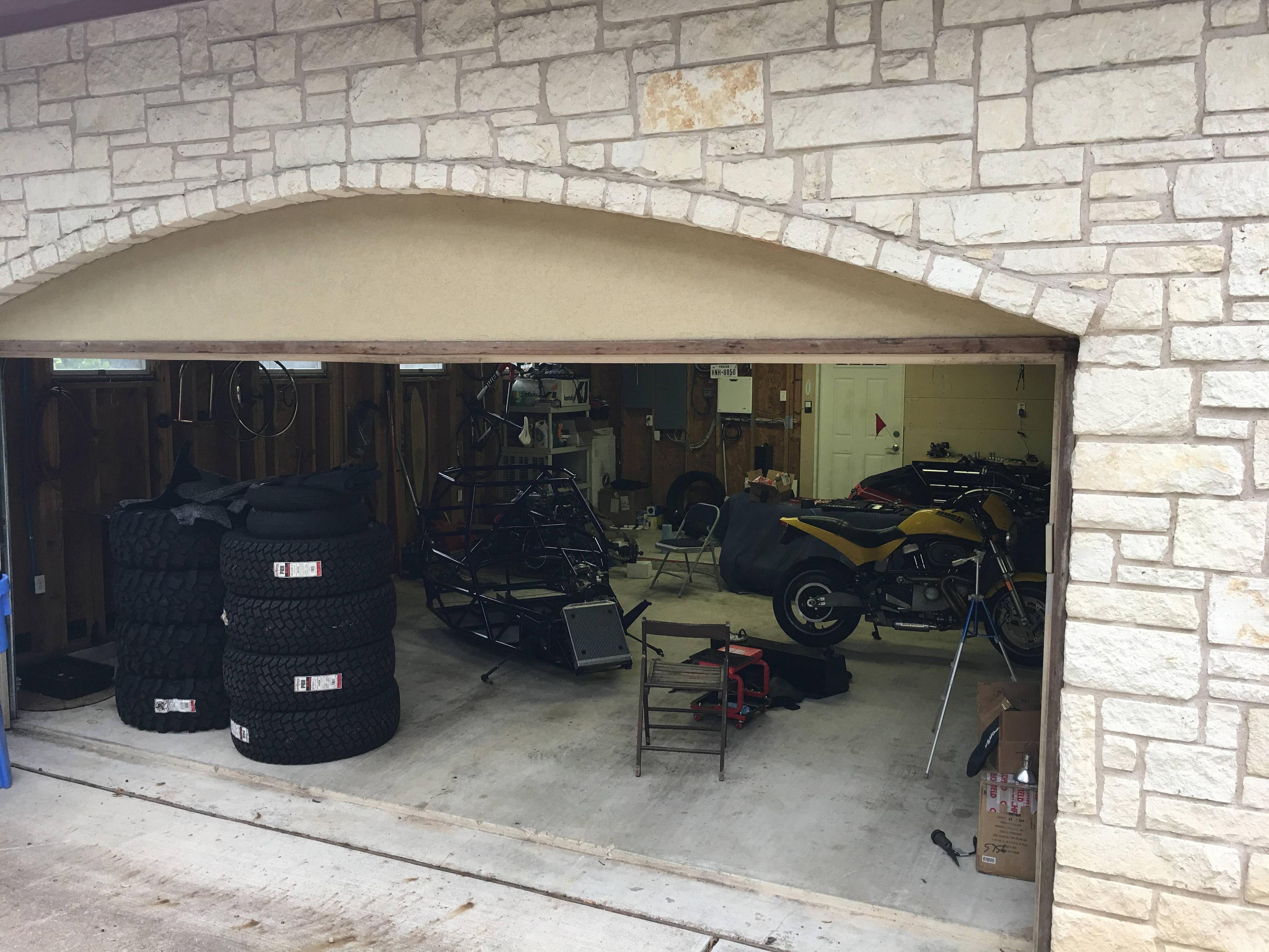

Moved into new house! Goblin quickly claimed its section of the garage. The move forced me to do a quick inventory of all of the donor and kit parts and I placed it all in boxes.
August 2017
Did an extensive organization of the garage, getting ready to get into the project again

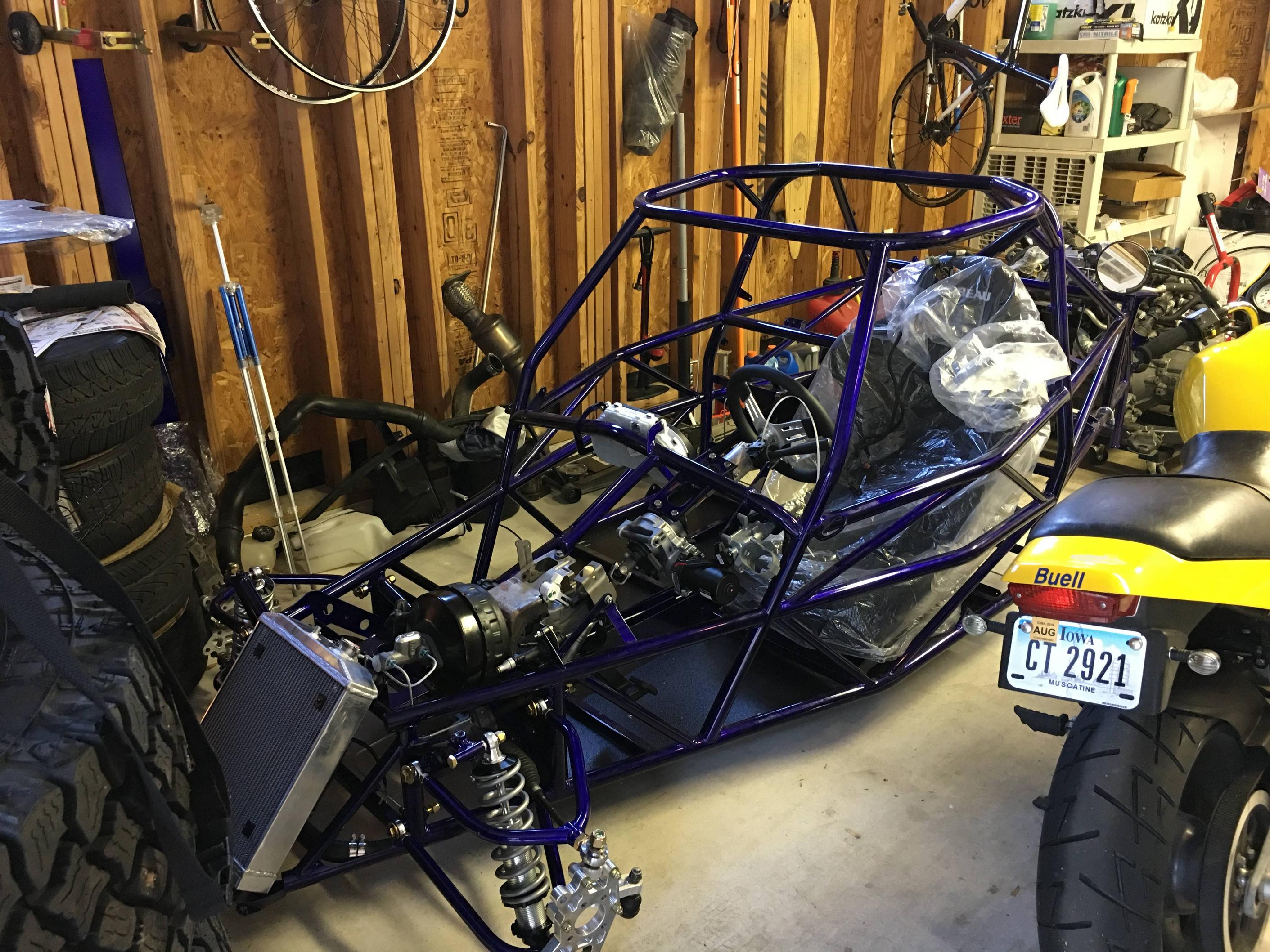

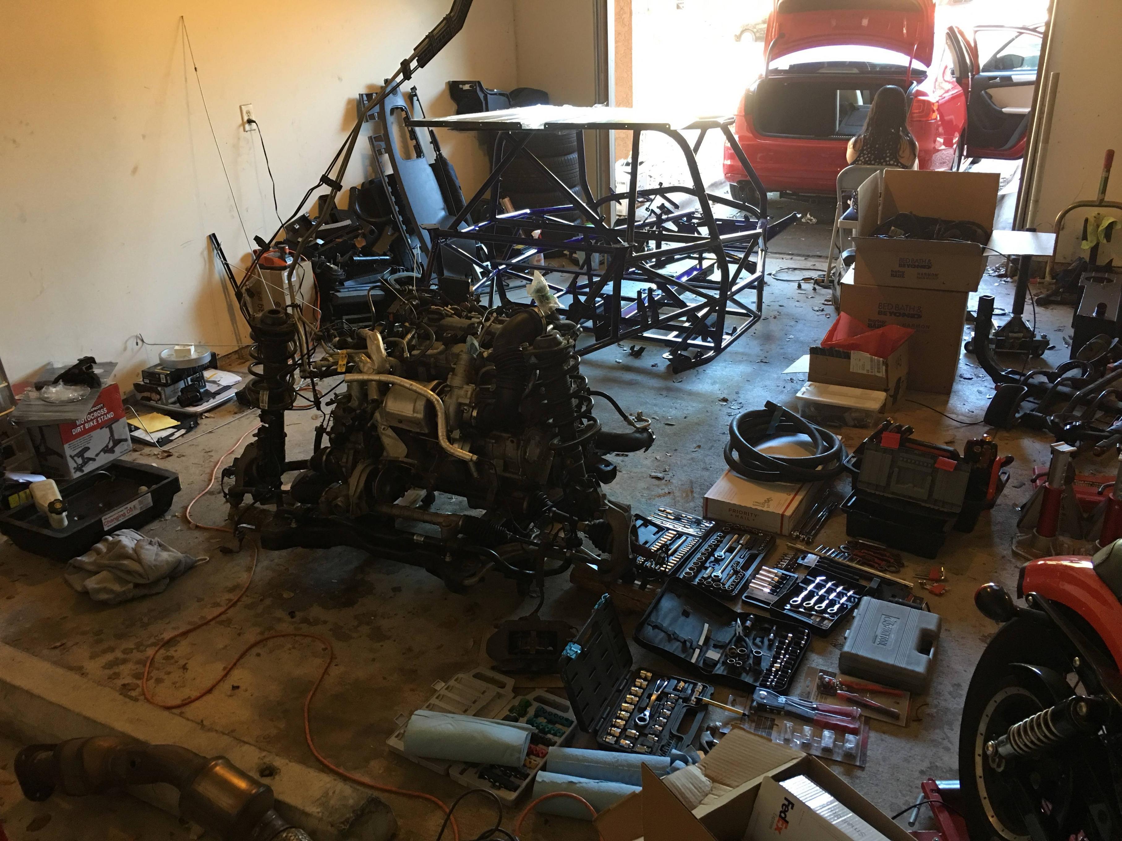

October 6 2017, Friday 7pm
Getting ready for maniac build weekend, picked up any missing tools and started at it, starting with installing the steering rack and power steering unit

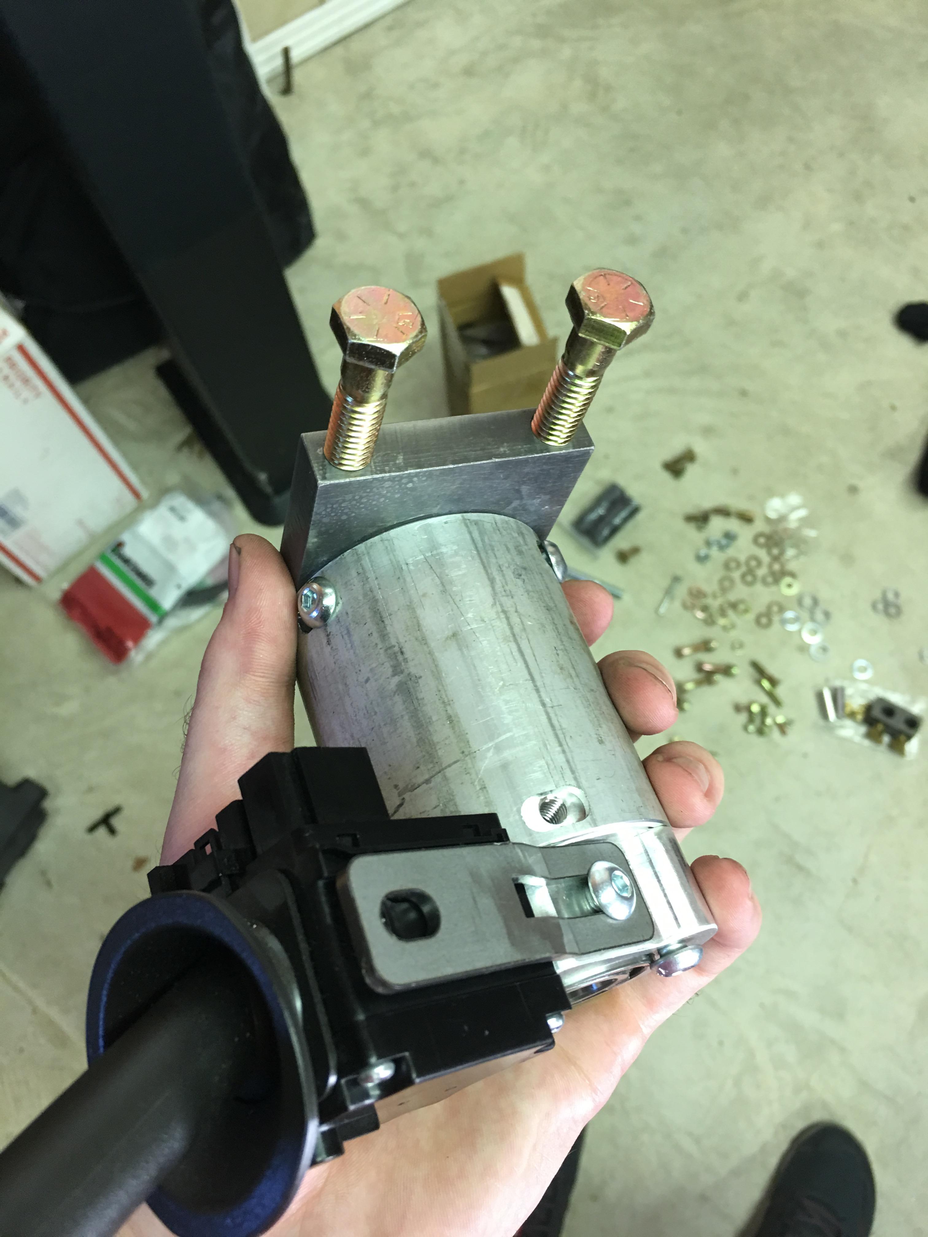

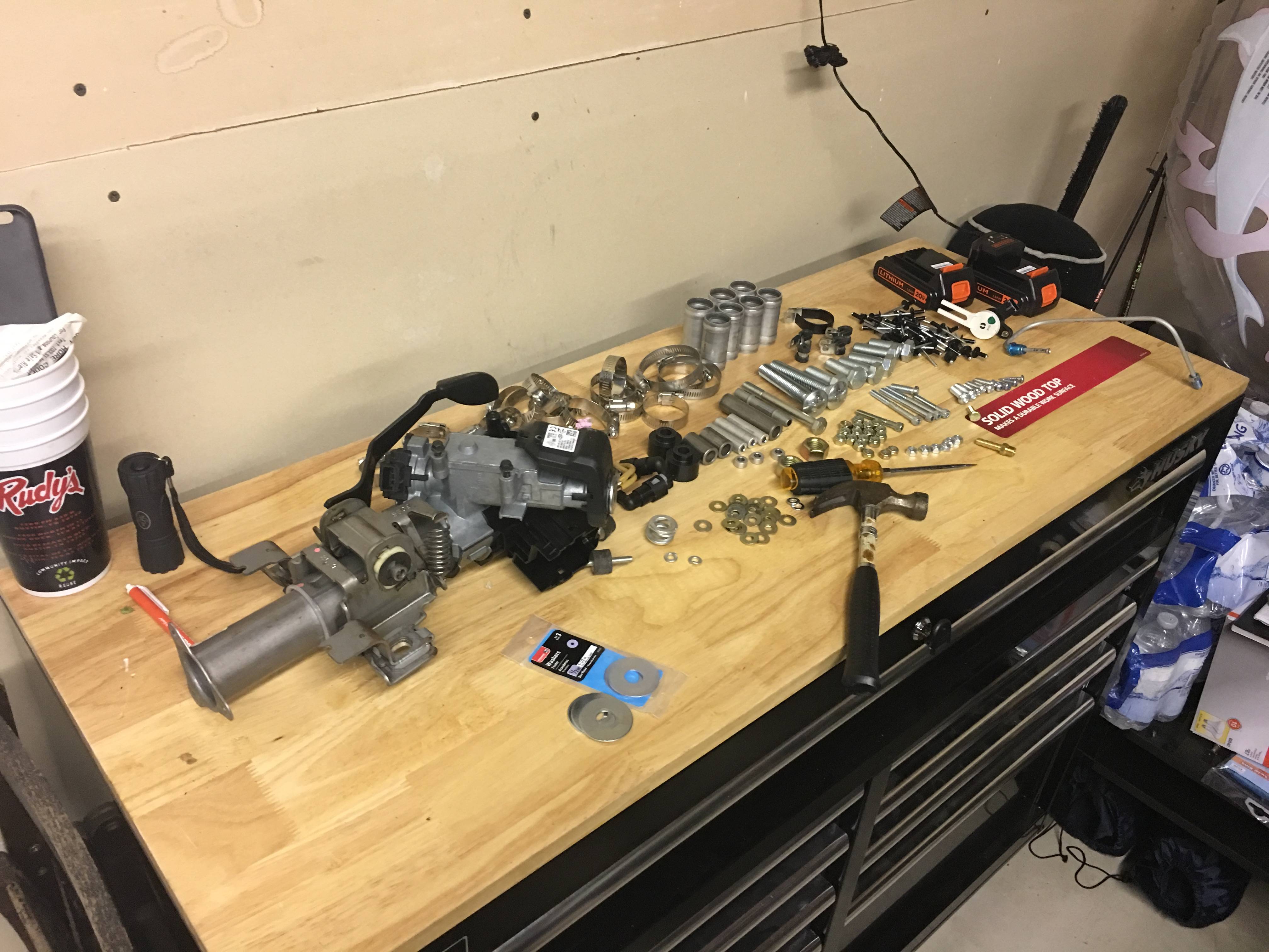

Disassembling steering components

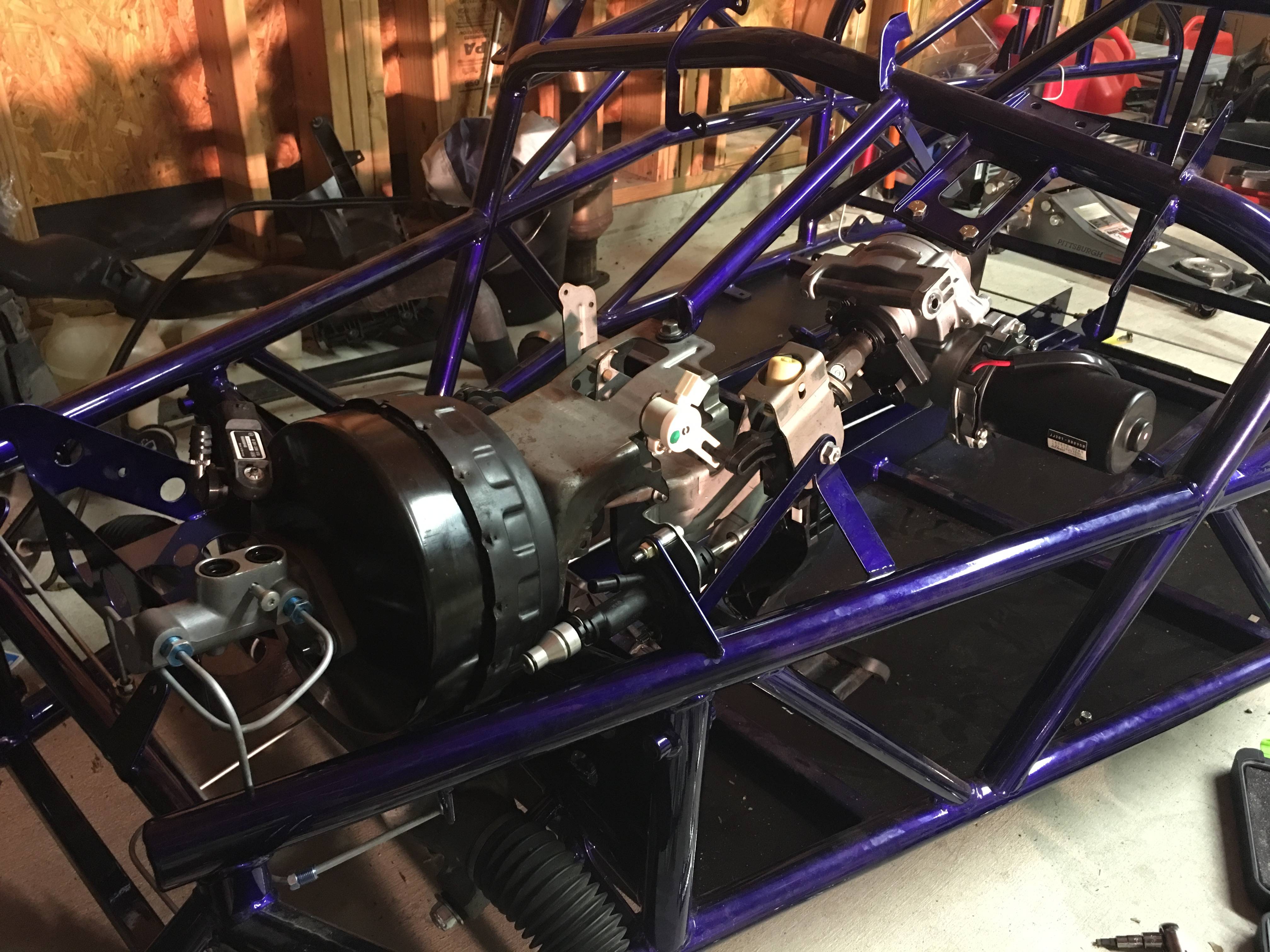

Put in the brake booster, pedal box, steering shaft

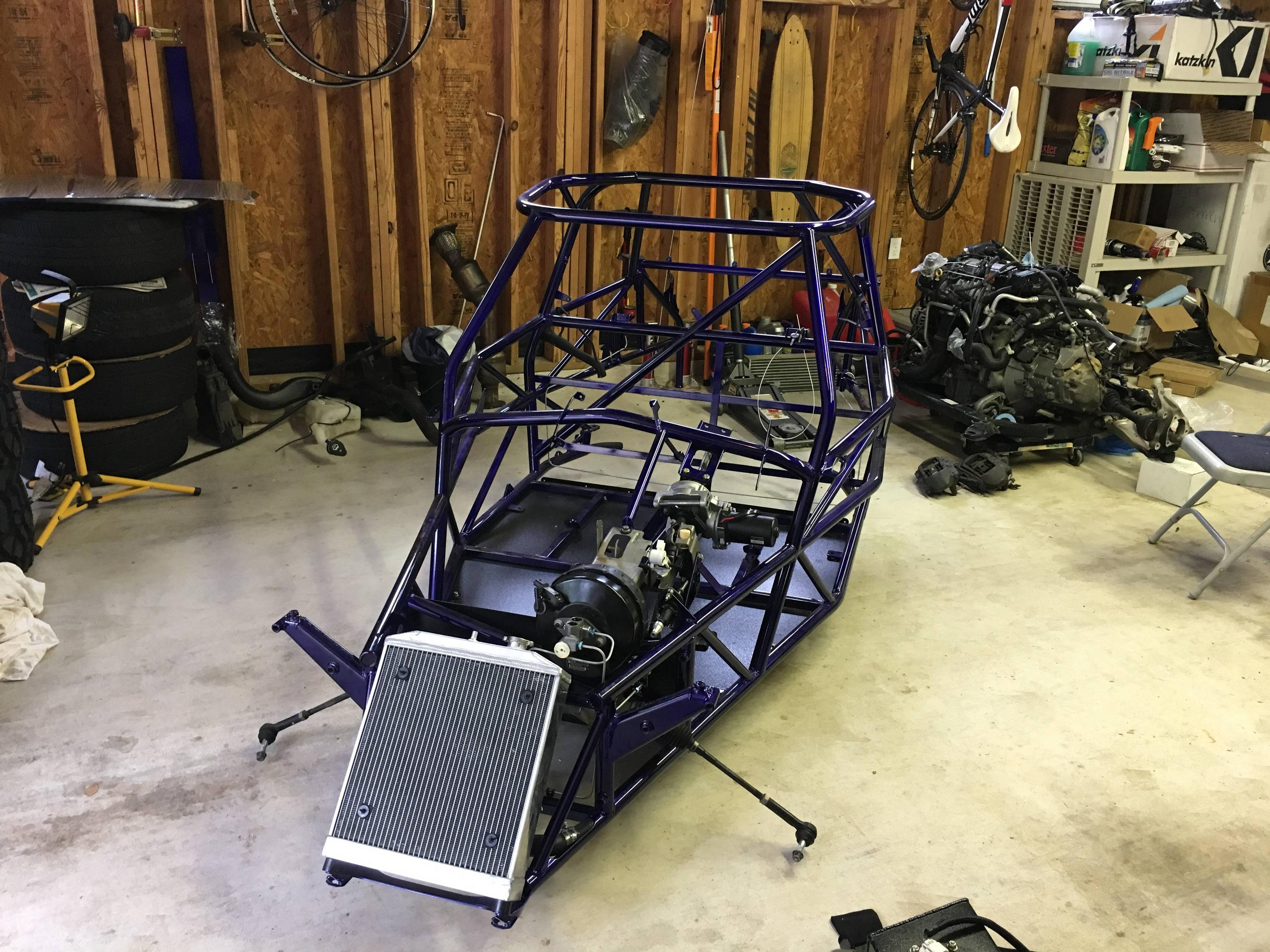

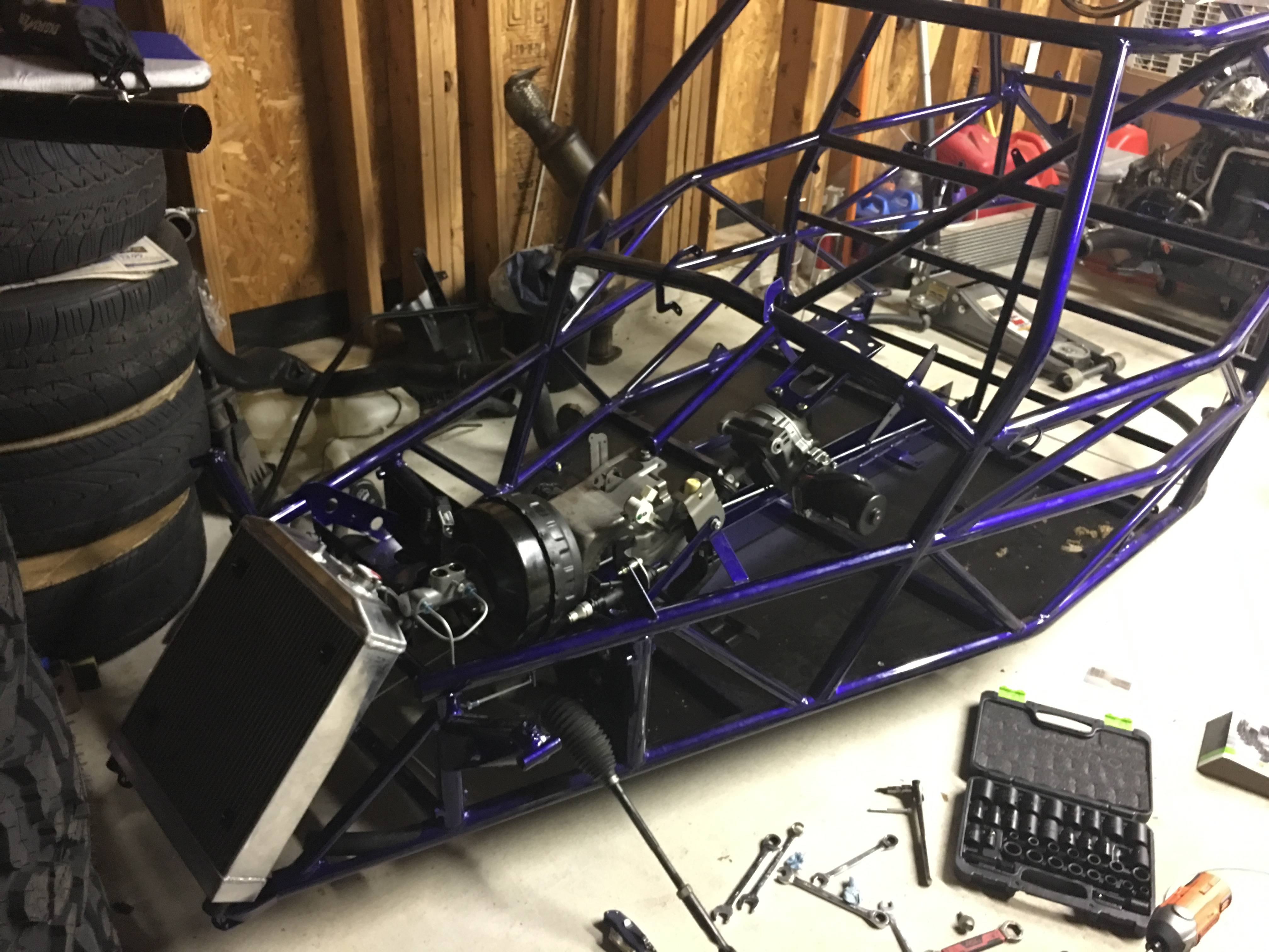

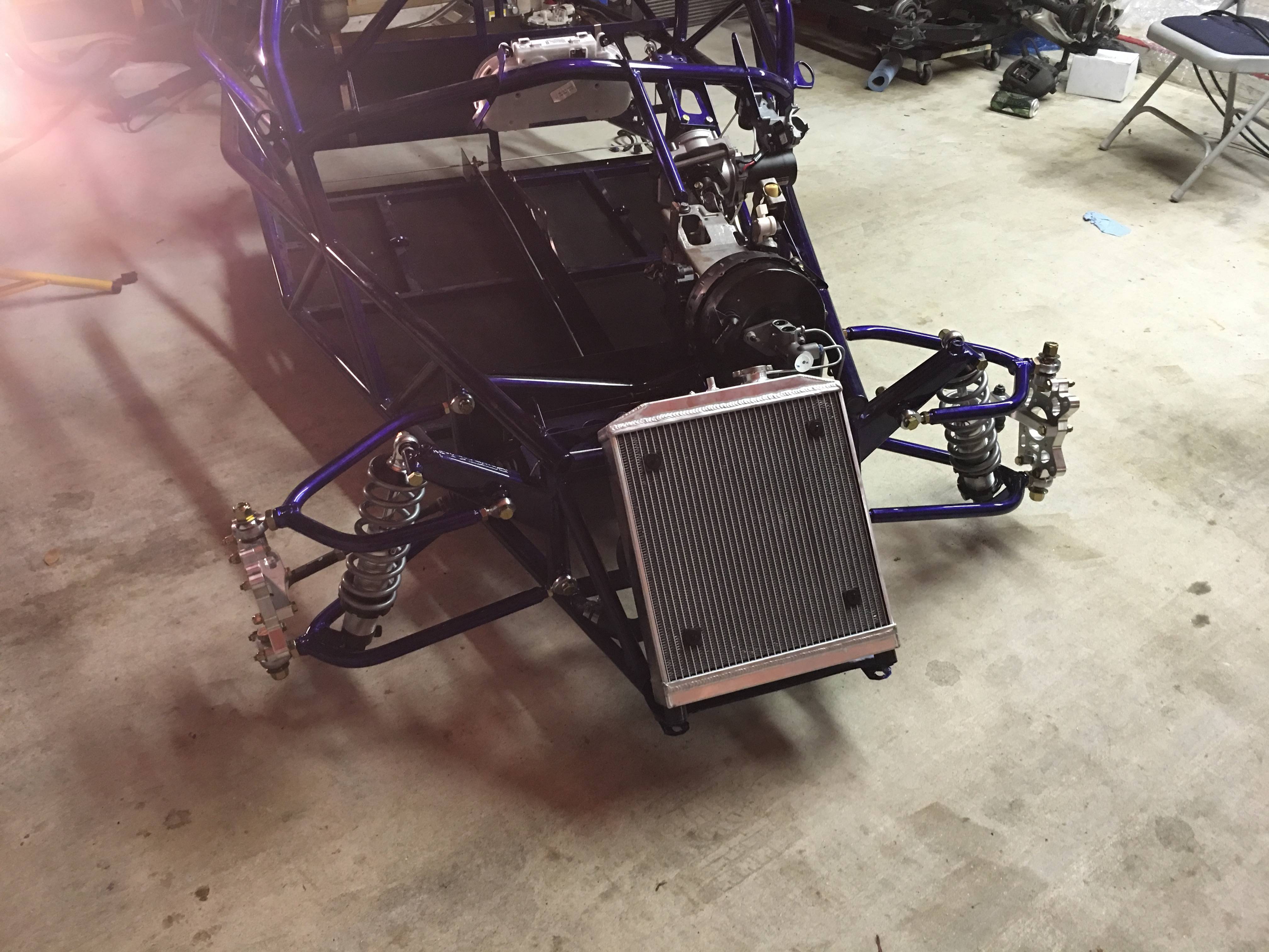

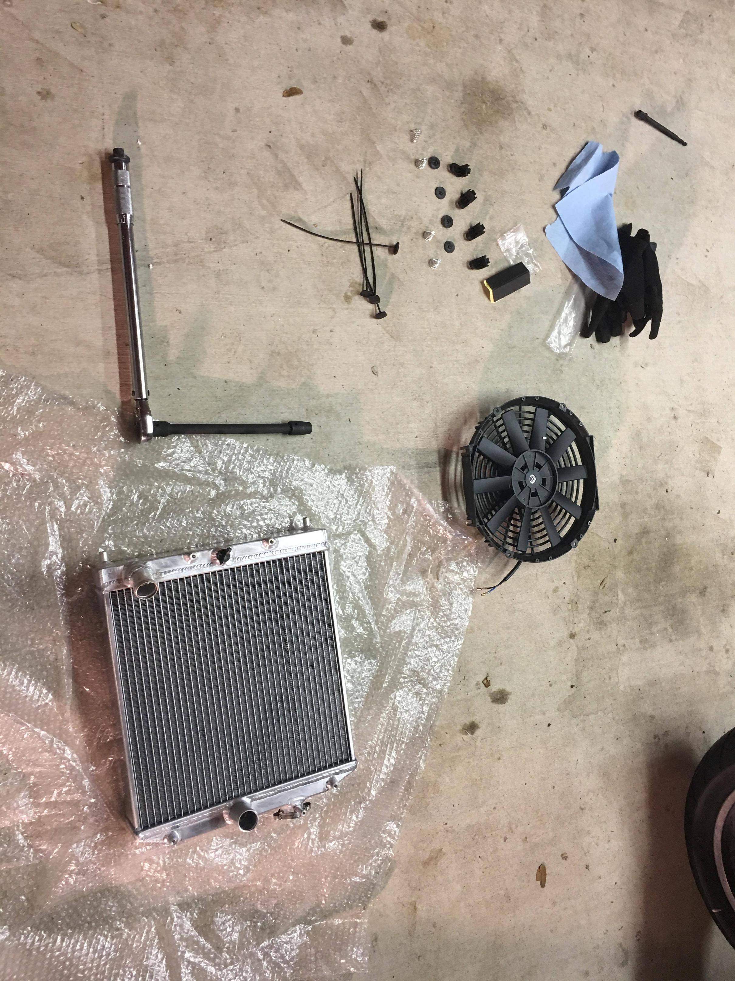

October 7 12:07am, time for the radiator
October 7 1:30am, Radiator in place, time to place the radiator hoses in place

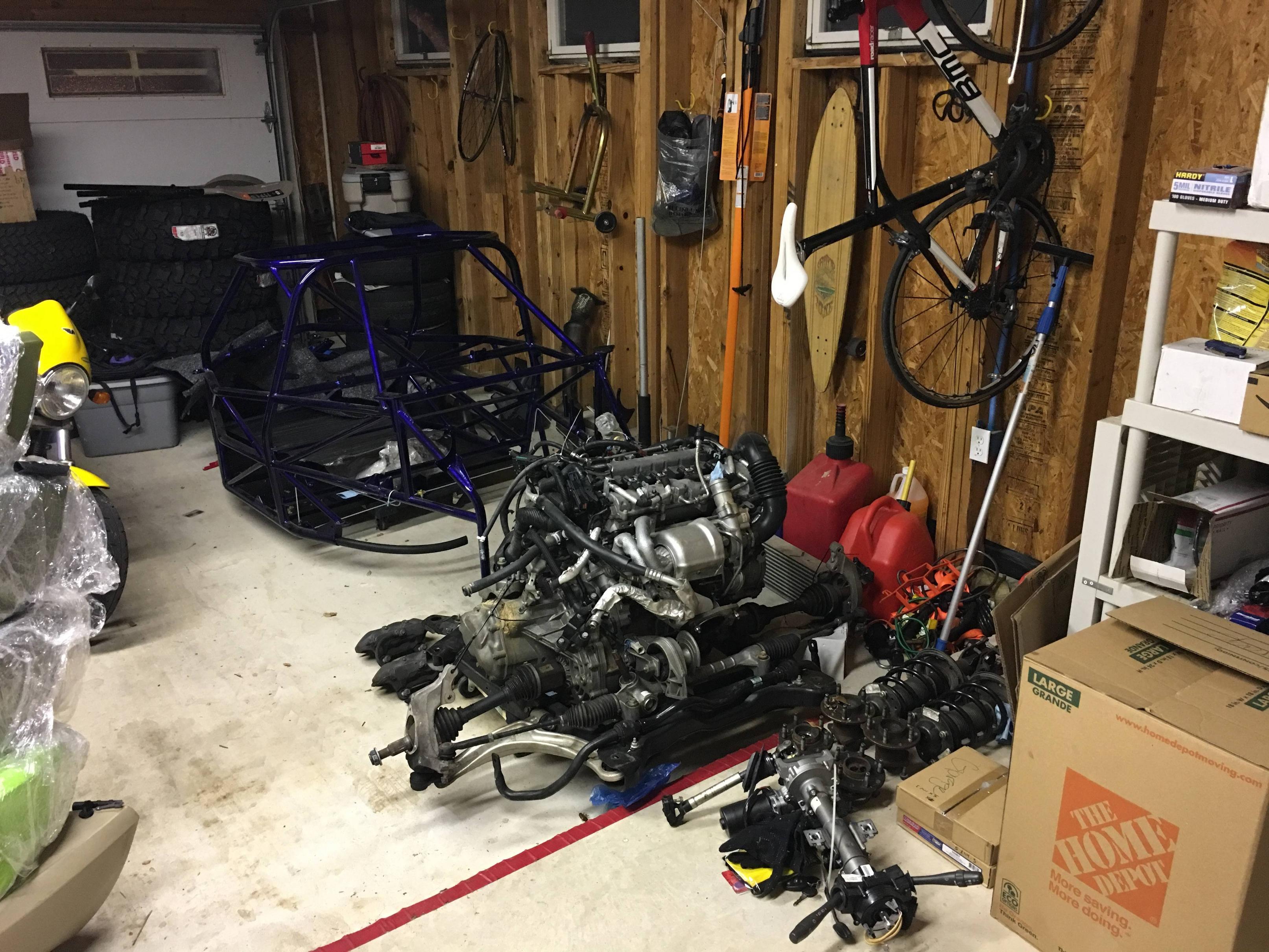

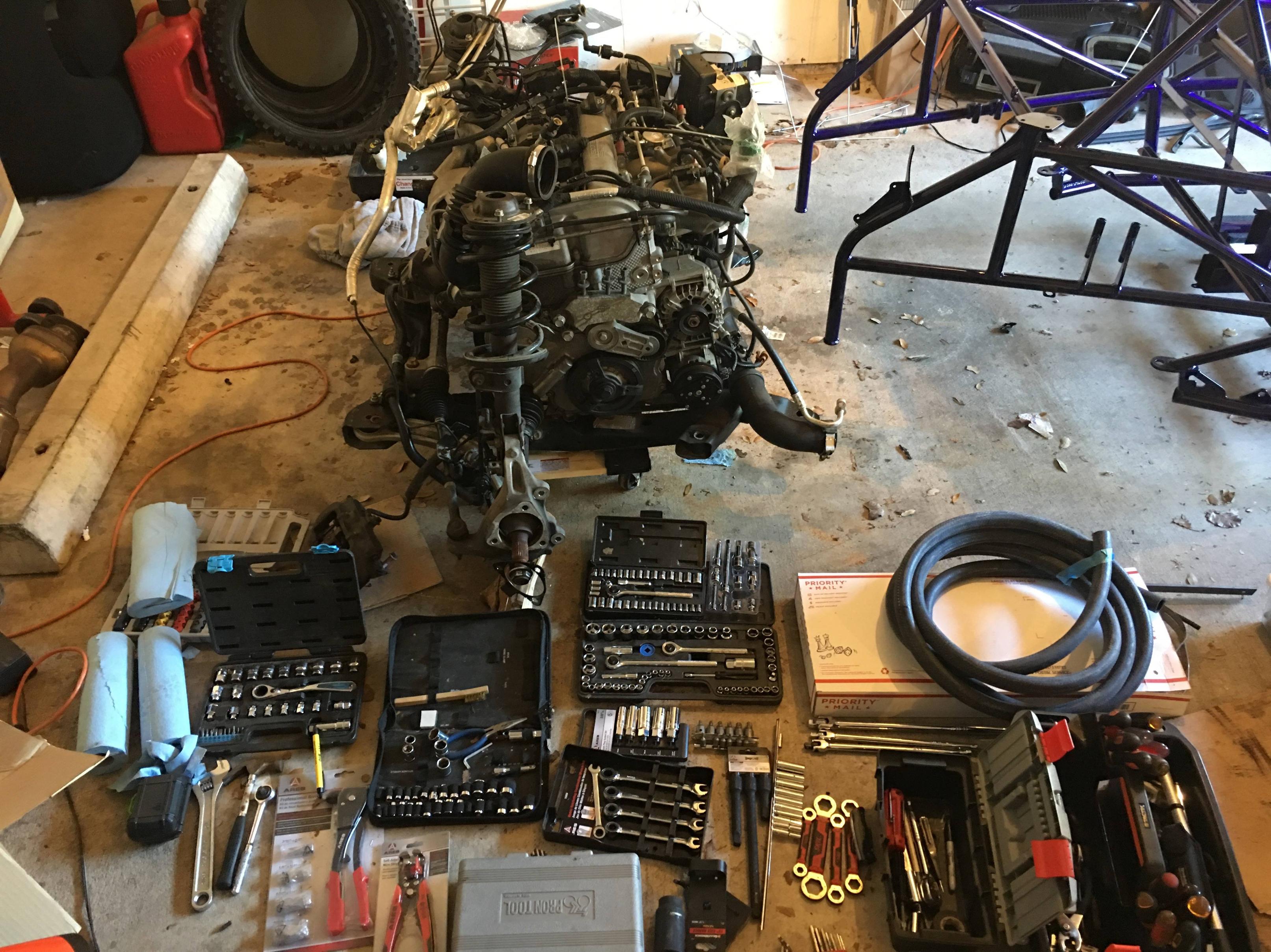

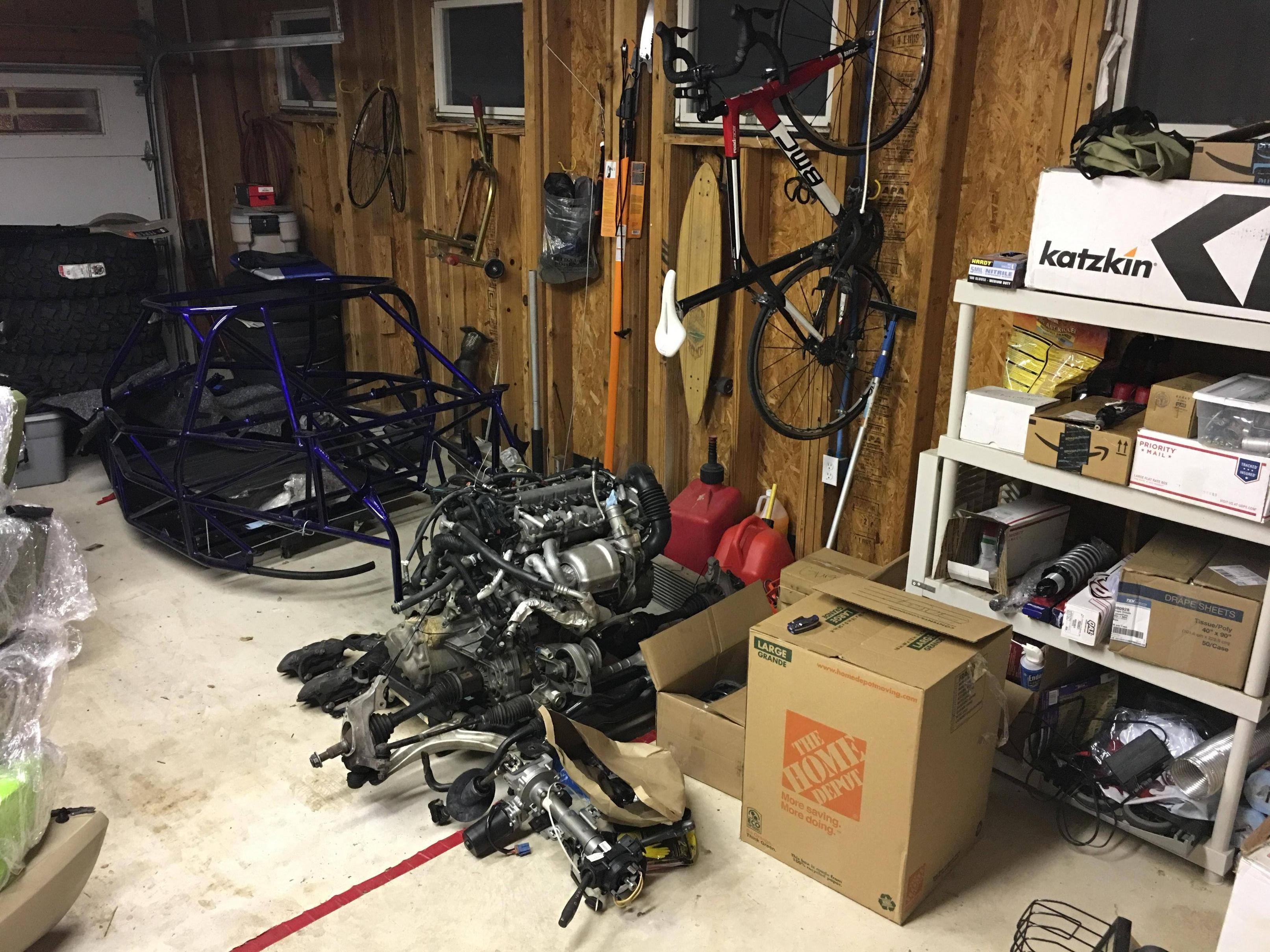

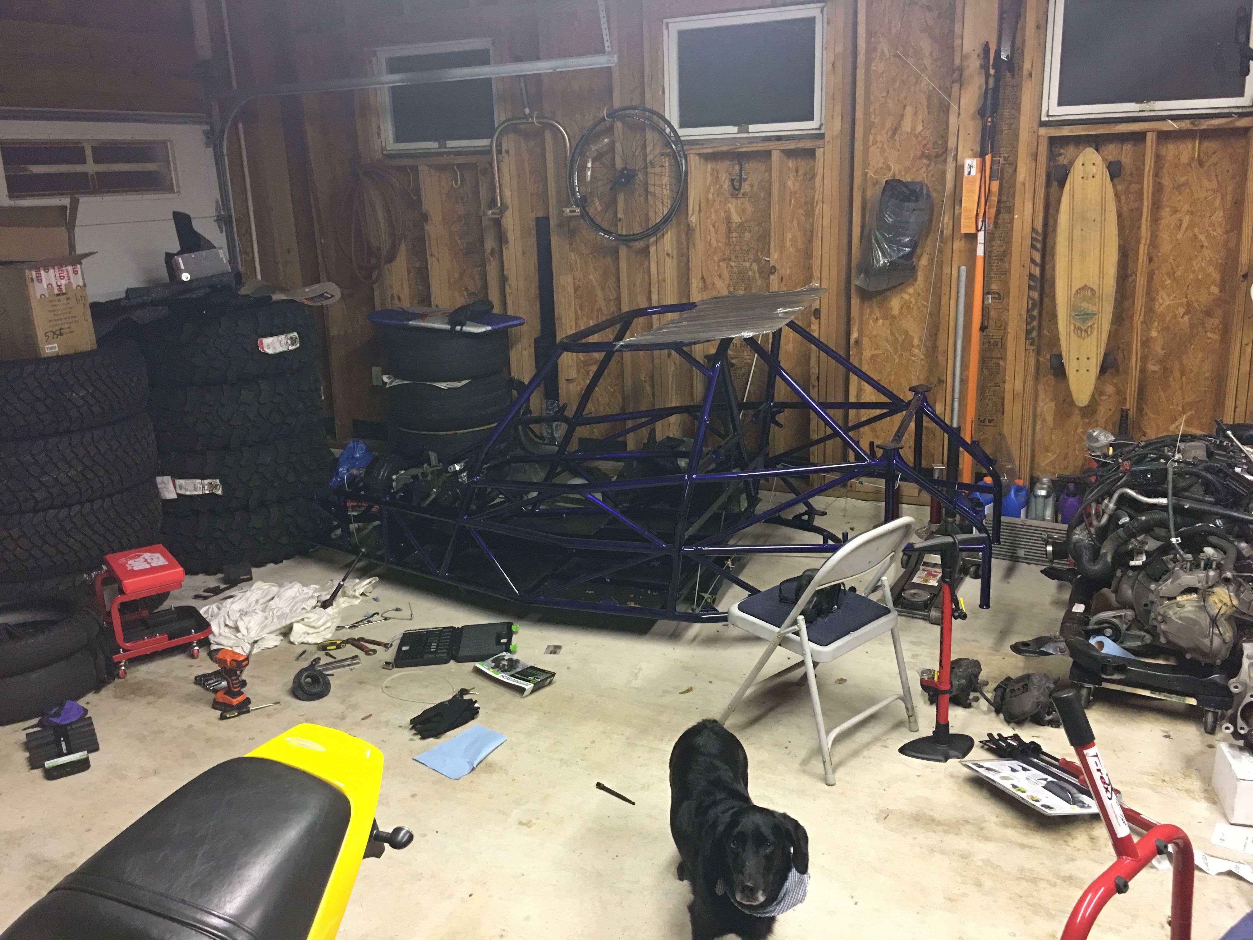

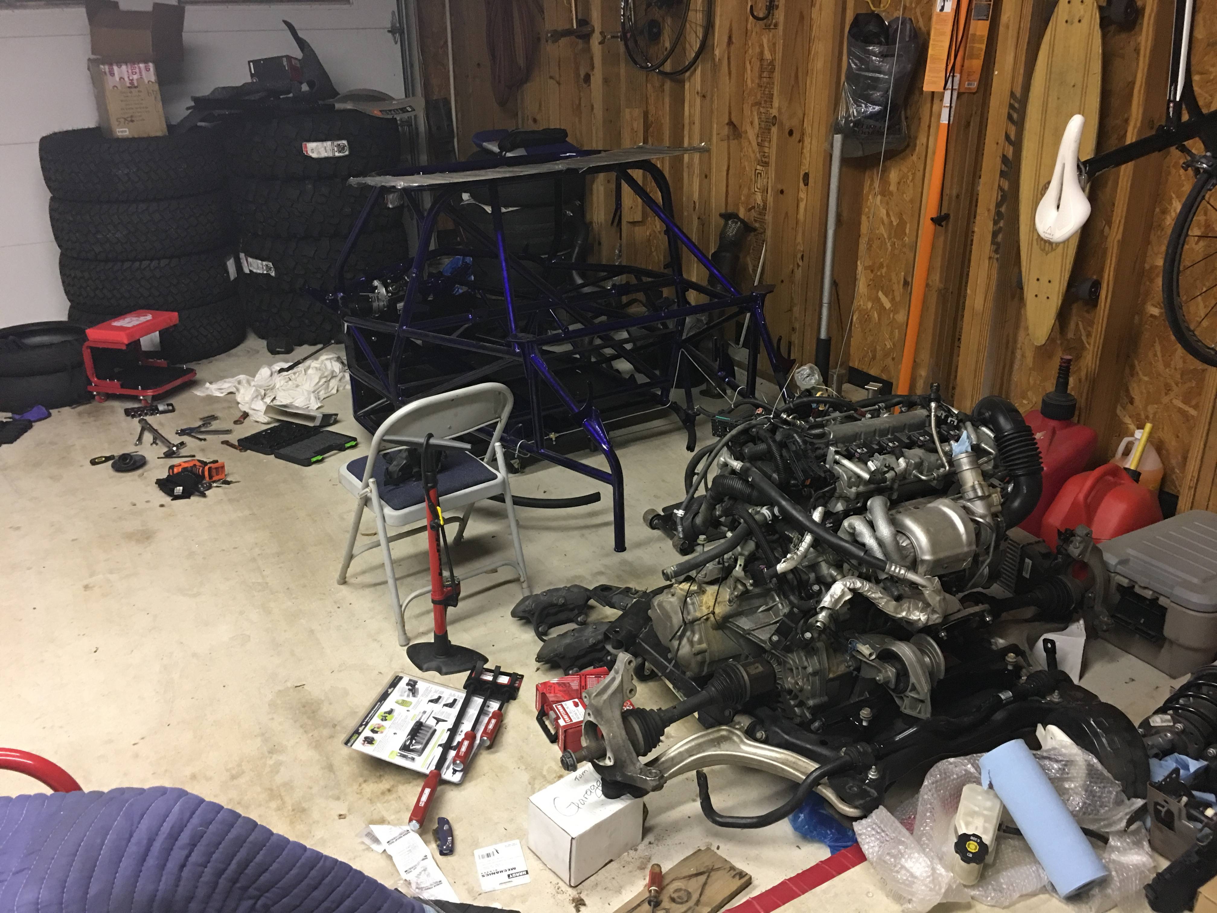

October 7 4pm

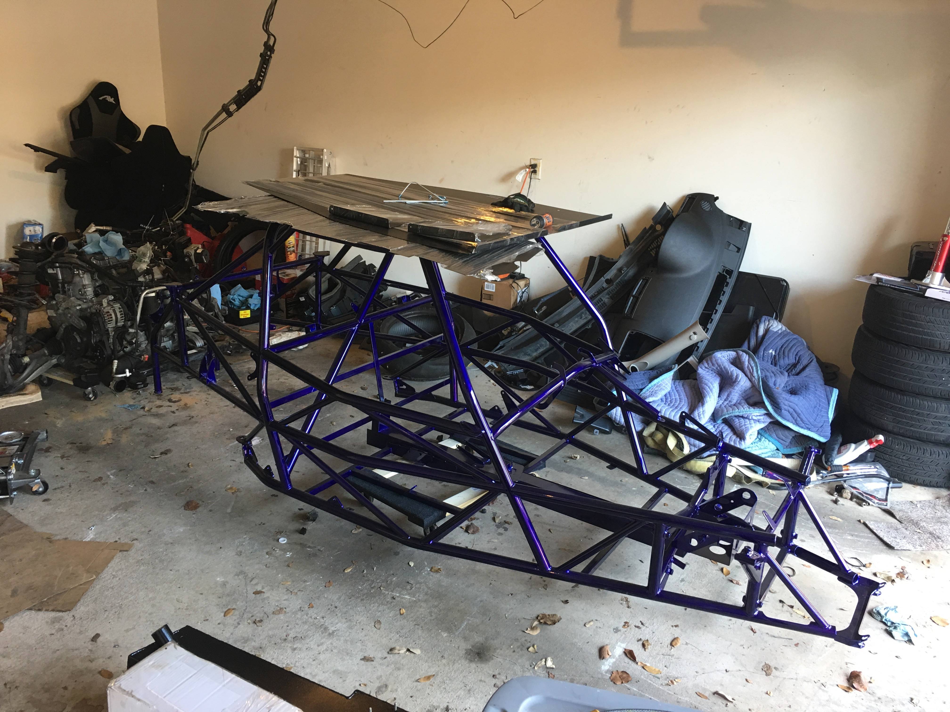

Decided to rearrange the garage again. With wife gone for the weekend the entire garage was mine!

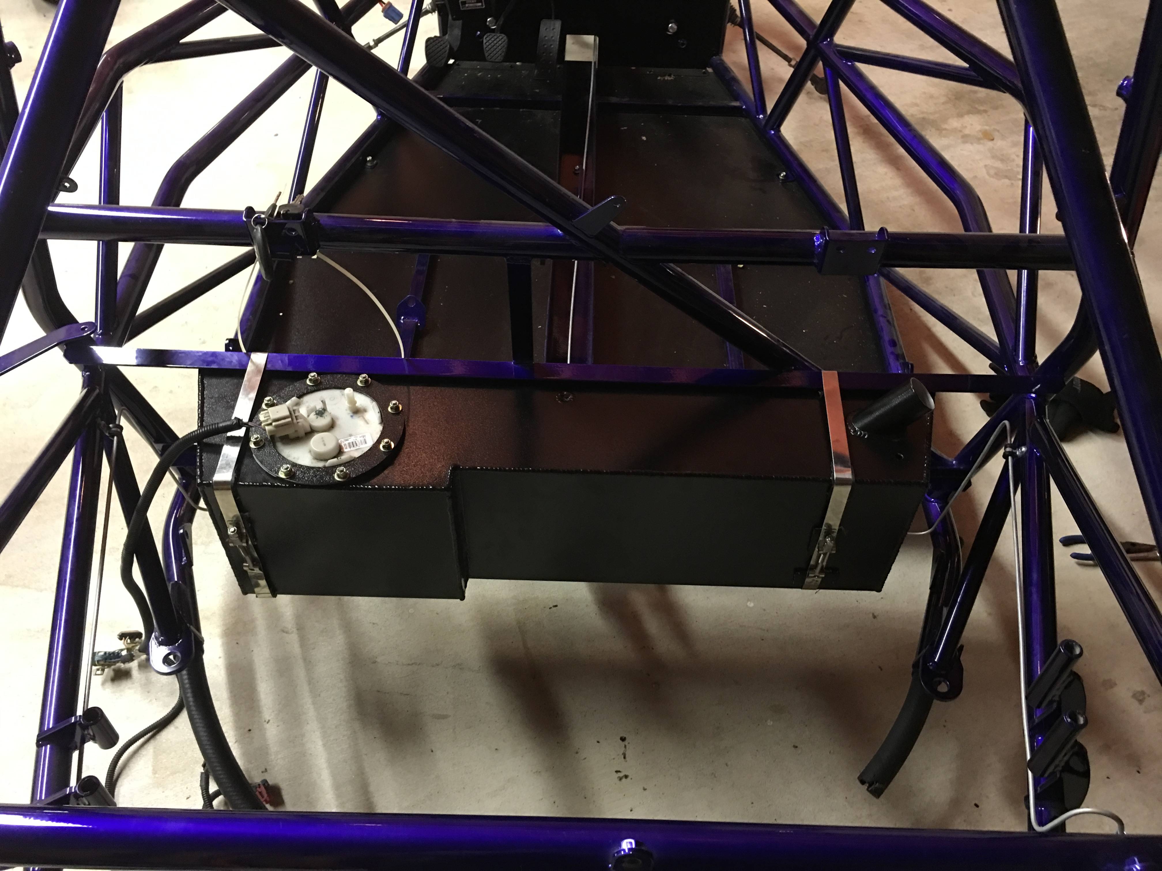

October 7 9:48pm

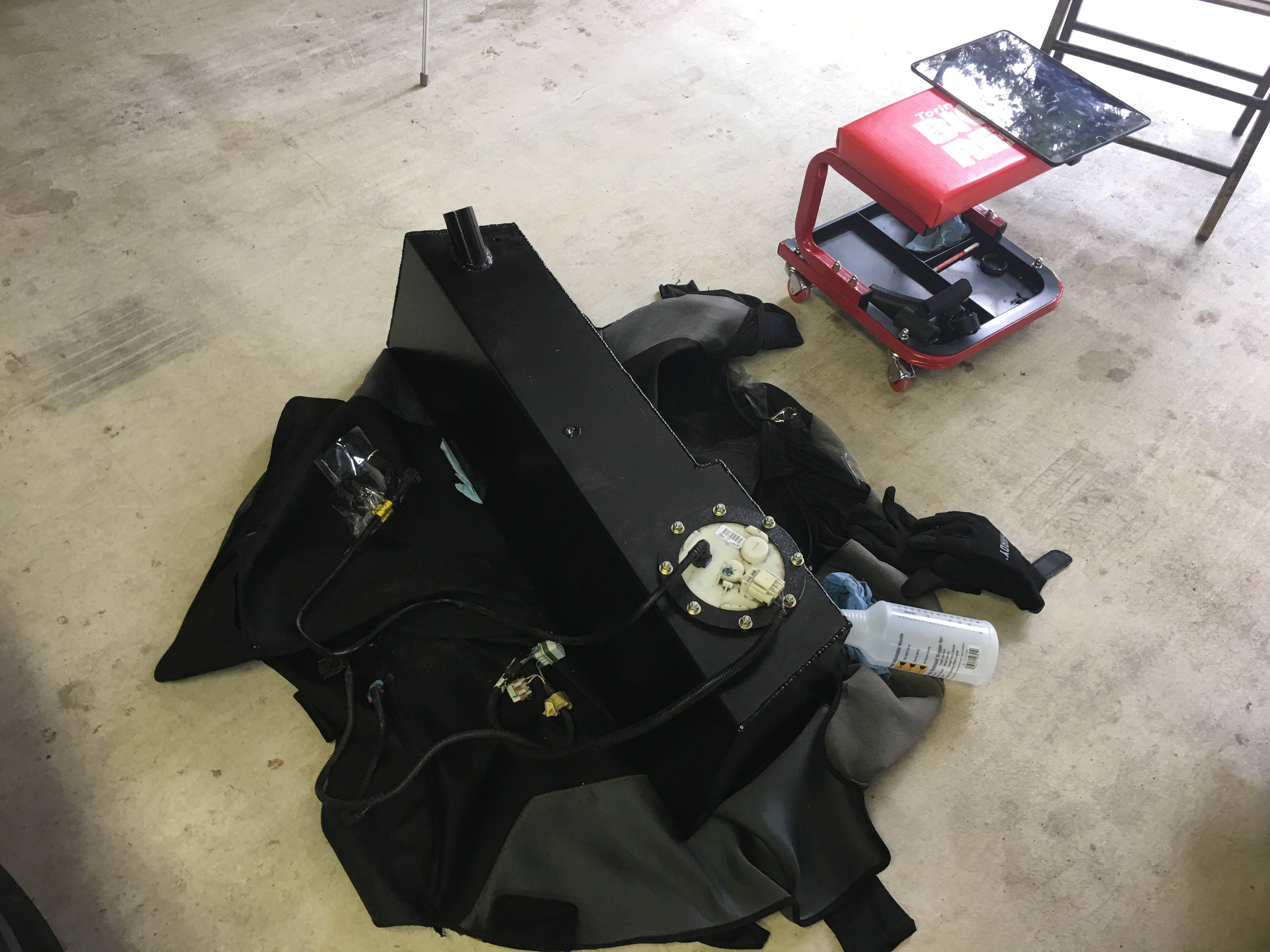

Finished mounting the fuel tank, this was a real pain because the straps were barely long enough to grab the threads.

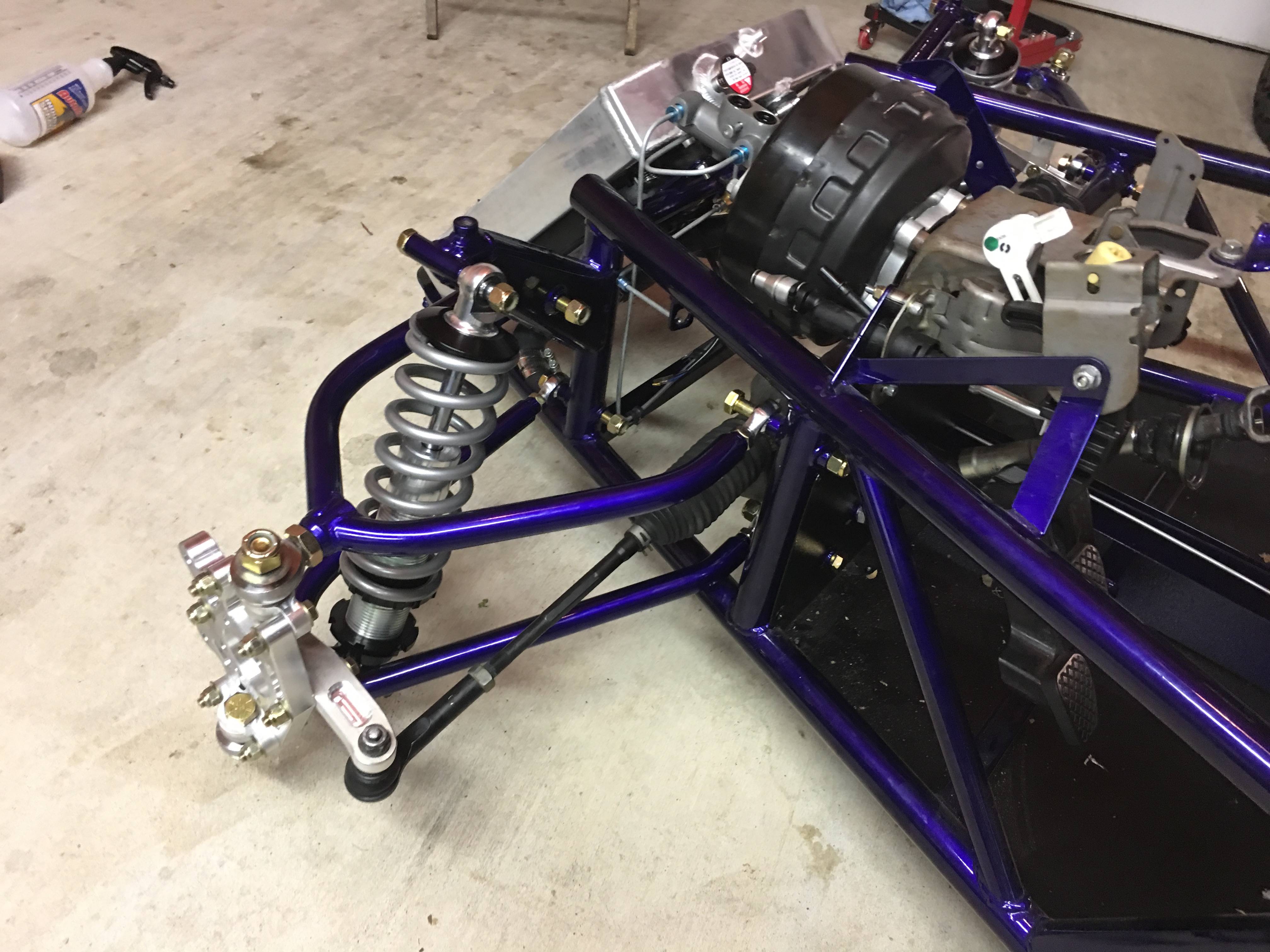

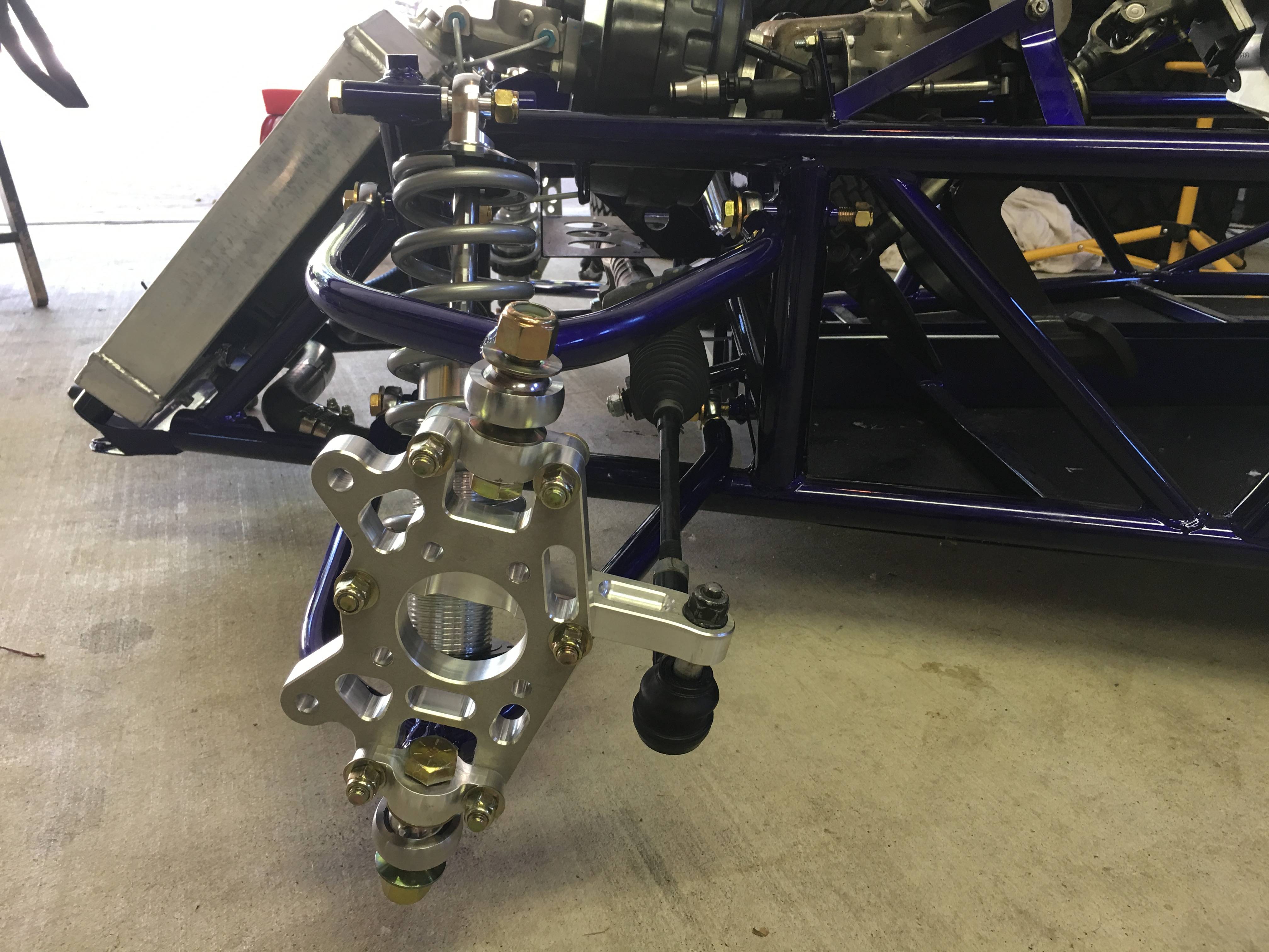

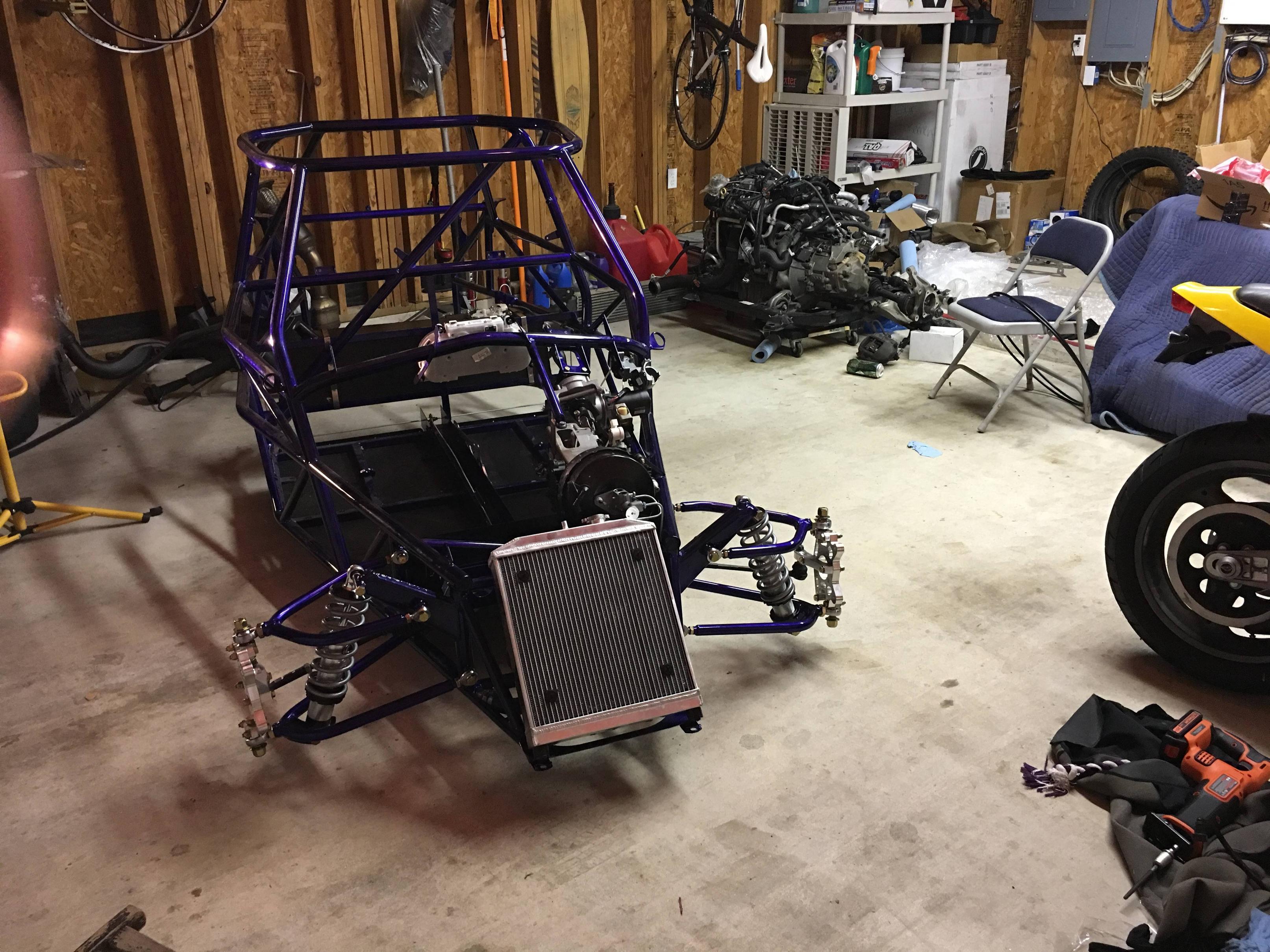

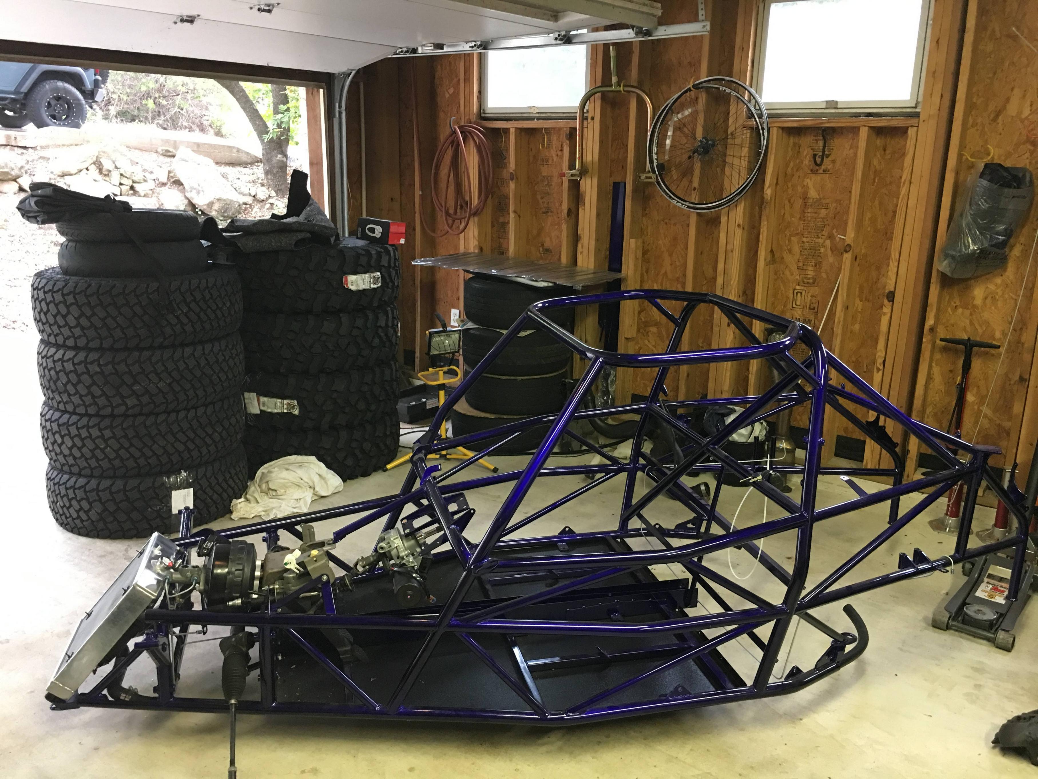

October 8 2:11 am

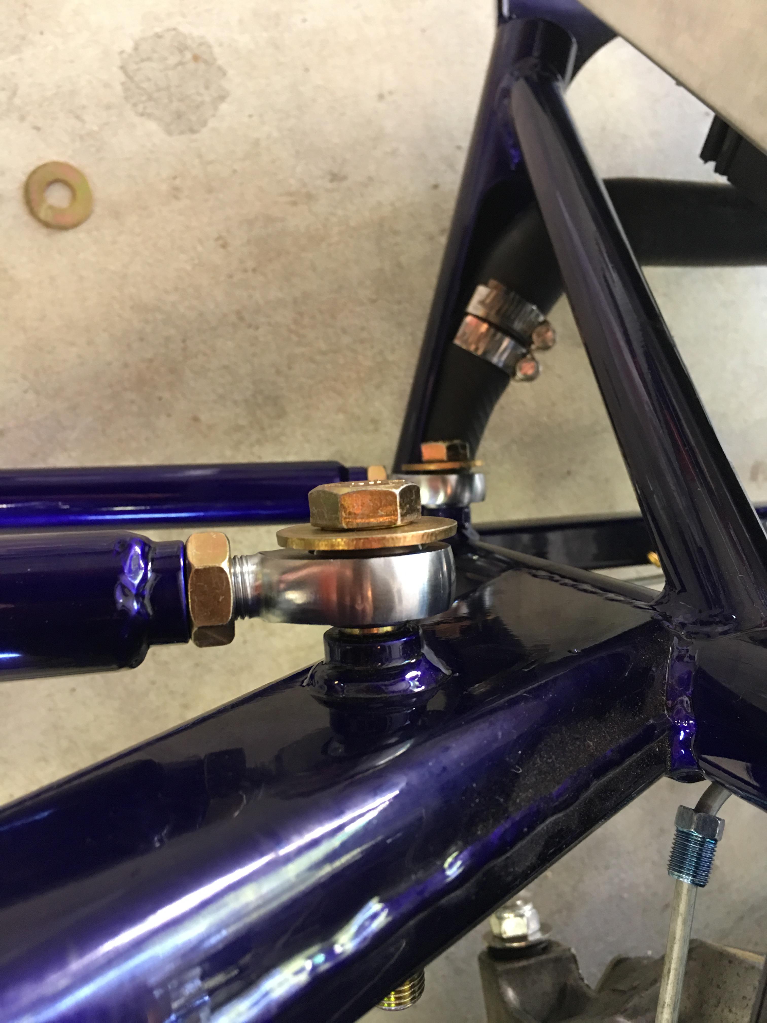

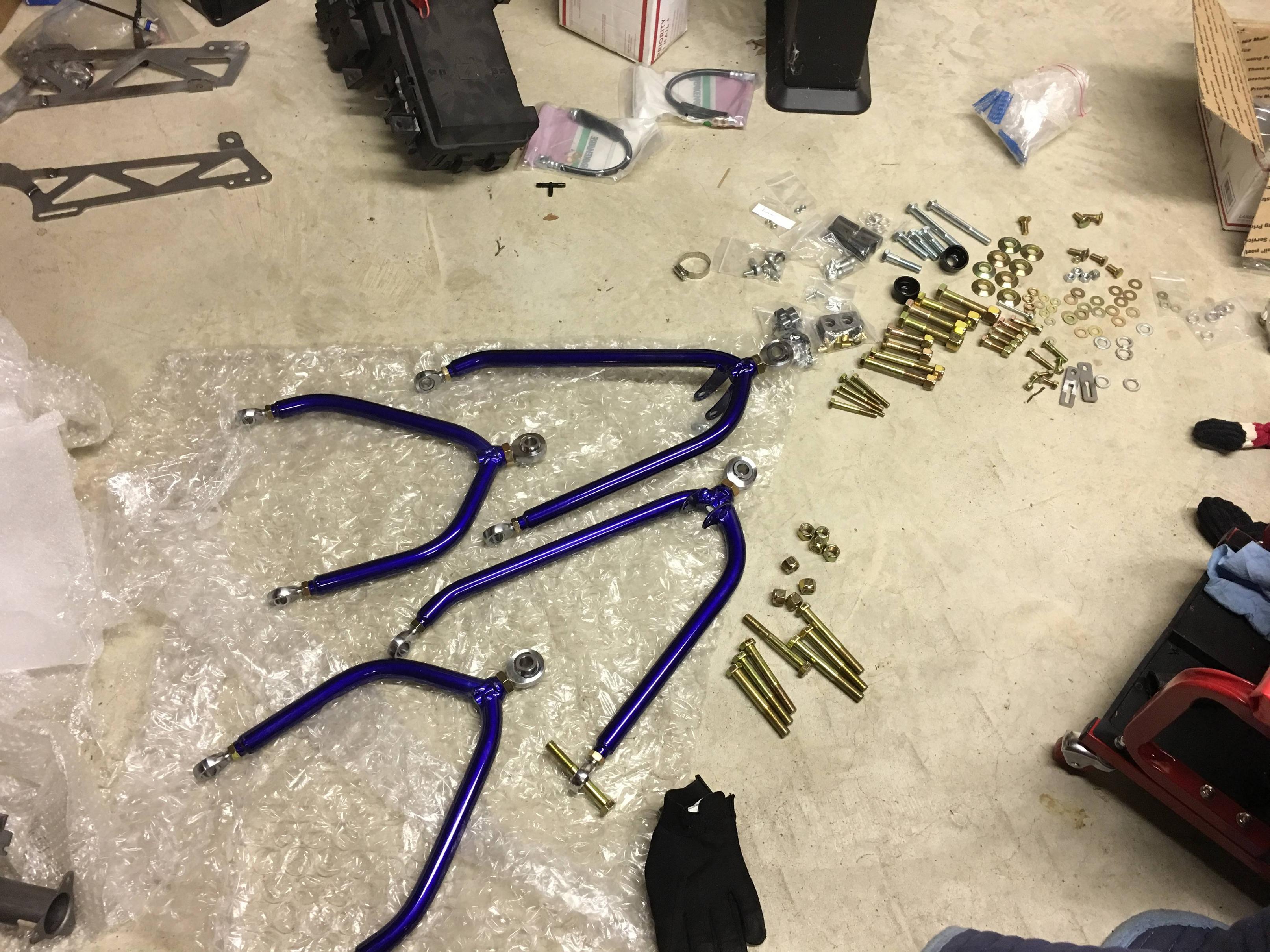

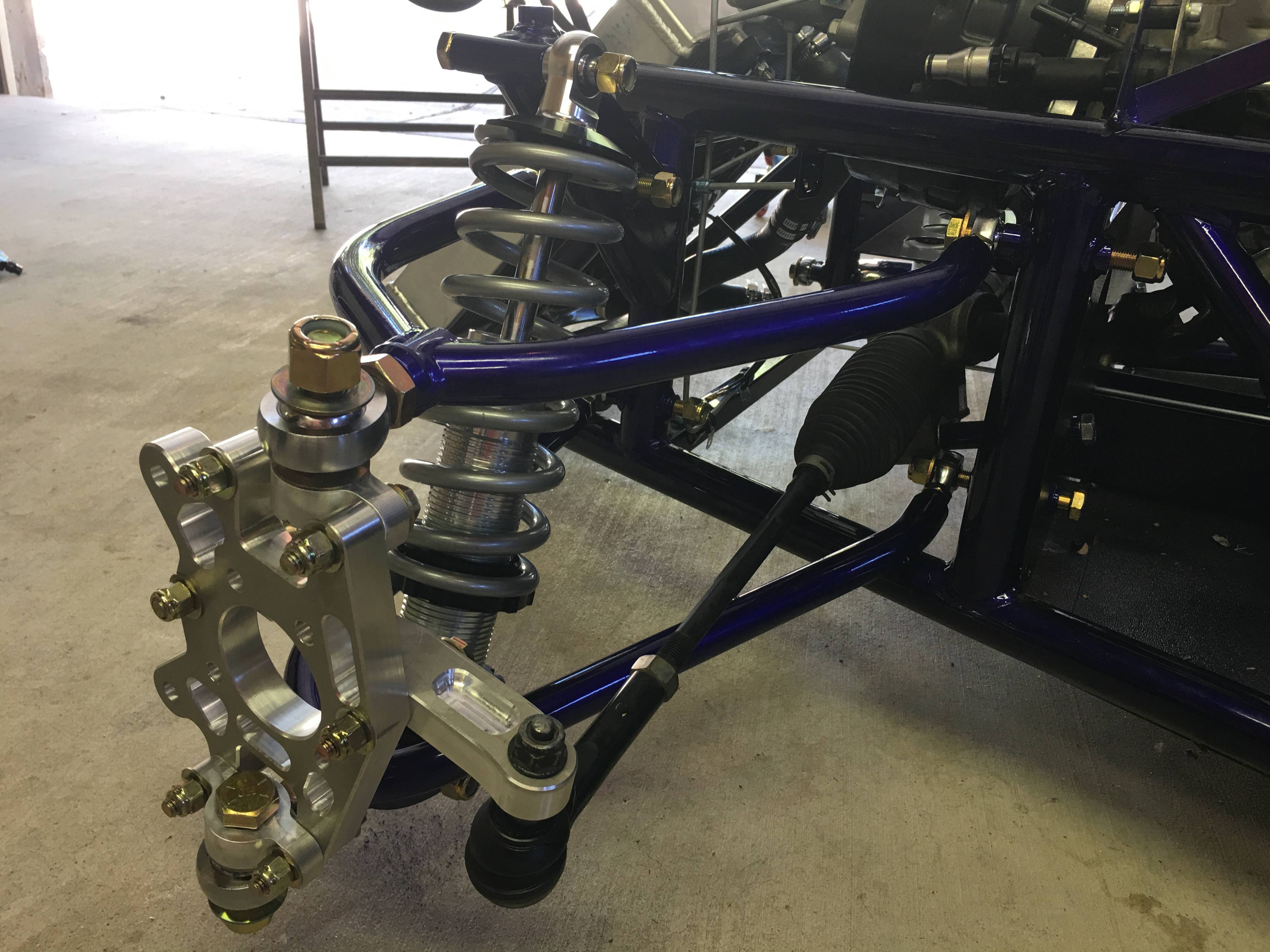

Decided to keep on chugging along and tackle the front suspension, this was the fun part of the build

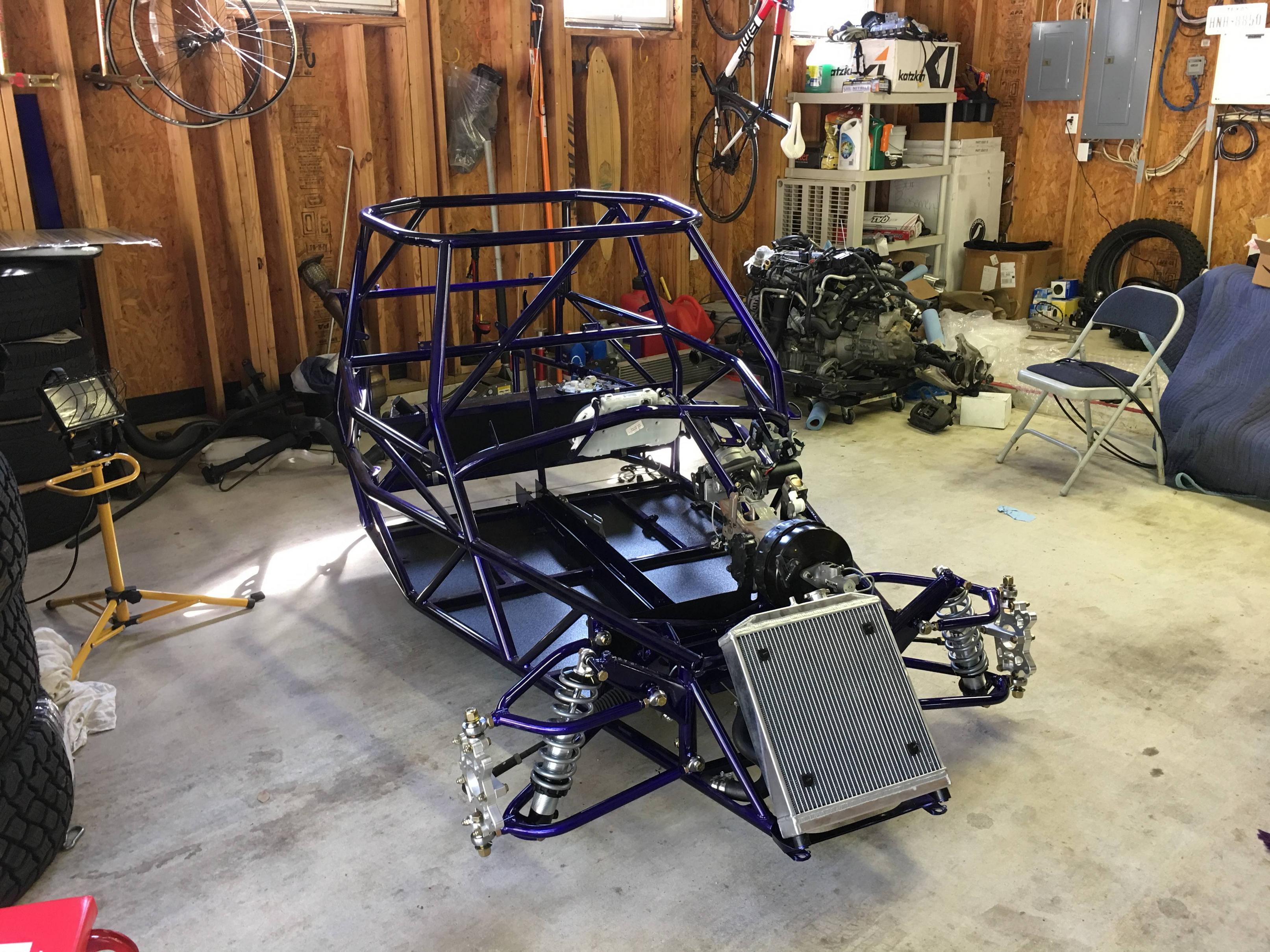

October 8 4am
Front suspension parts are in place!

October 8 1:30pm

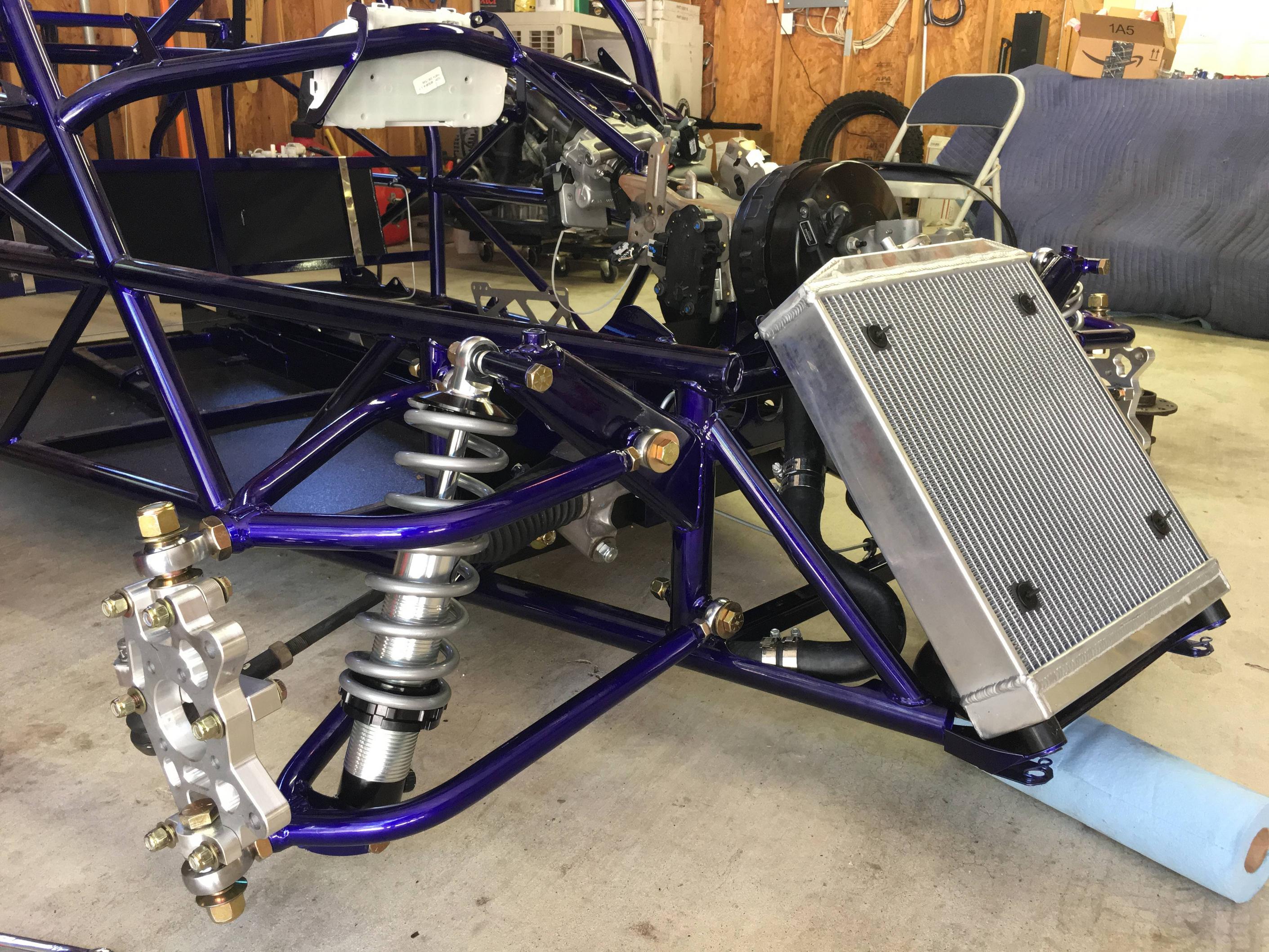

Finishing up the front, needed to swap some parts around after realizing that I had some pieces backwards

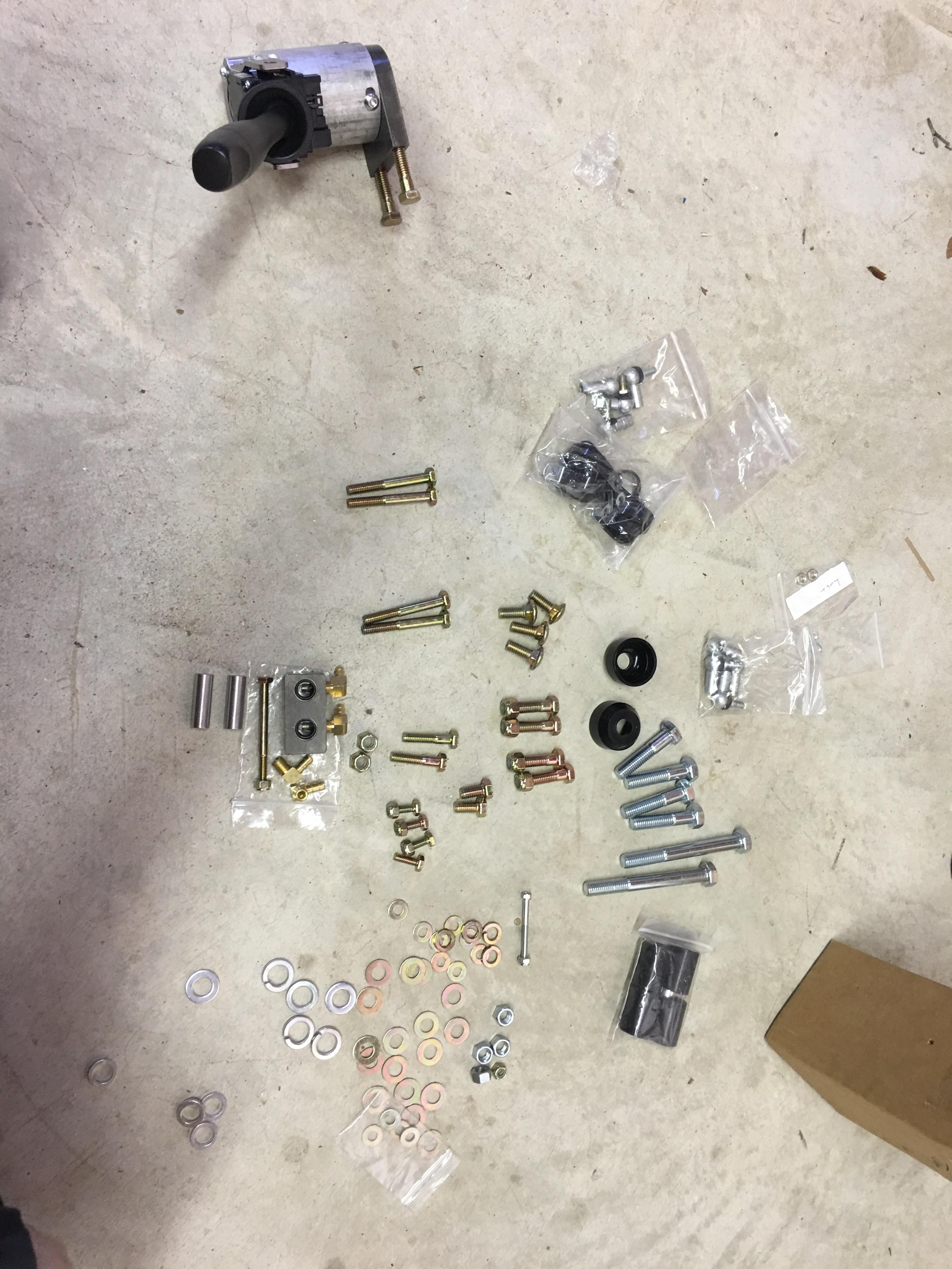

Remaining parts at this point. I also got antsy and installed the seat and steering wheel to get a taste of the seating position. Getting very close now!Name:  dp2IDG1.jpg
