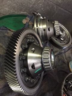

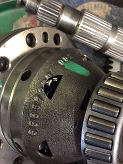

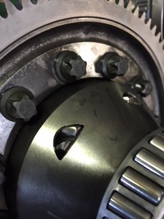

Questions you didnt ask ,but here is the answer anyway
LSD .
Quaife did not manufacture the 08-10 Cobalt torsen style /quaife look alike LSD. The transmissions with the real quaife have tags on the top of the housing marked "LSD" and are 4.05 cwp. and the pseudos the tag does not say LSD but has a number, and X and a 3.82 cwp. So looking for a used quaife at the scrap yard, you know what to look for.
Quaife did not tell me who made these different units 08-10 but it must have surrounded the bankruptcy, Gm were pretty brutal with suppliers at the time, arrogant and demanding as they burned suppliers to the ground. GM Powertrain is the current name afaik of the previously named "Fiat/Saab/GM transmission"manufacturing joint venture Oor whatever you call it) that made the transmissions (F55/35 or whatever) that were stuffed in the 2.0 SC and Turbo versions of the Cobalt and Saturn Redline (SC only)
For some bizarre reason, ( possible slightly more torque capacity) GM chose to use the Saab based F55/35 variant for the SS/Redliness and not the Getrag non LSD/ F23 three shaft design that was used in a far larger production volume of manual shift base Cobalts and Saturns ( 2.2 and 2.4 naturally aspirated models.
But back to what Quaife told me via email overnight
"The cast housing differentials are definitely not Quaife as we have never cast our bodies they have always been machined out of billet. These must have come from a different manufacturer."
I had asked about my 38 degree Quaife which was a development part I had which we tested, and John Heinricy did not like, due to understeer. I used it, but with the new YYZ progressive Hyperco spring rate configurations I have made for me, and run now with the rear bars we make, works geat for me.
"Essentially the TBR is a complicated way of comparing the helix angle of the internals (sun gears and pinions) and the vast majority of our diffs have the same angle internals although some of the very large and very small diffs have different angles. A few diffs have options (eg QDF9U) as they are used in different applications, i.e. QDF9U (31dg) in a Honda Civic Type R or QDF9U/23dg in an Ariel Atom. If you put a standard QDF9U (31dg) in an Atom (very light mid engined car) the diff would push too hard for the amount of grip at the front. The 38 degree you have there is probably from the development stage."
So good info, and as a member on Saab Central points out, and I have found, those cast housing pseudo quaifes have never broken for me in use, but must have been made, I am guessing, in China. I will look closely. Pictures for reference.
Genuine
Psuedo
Compared

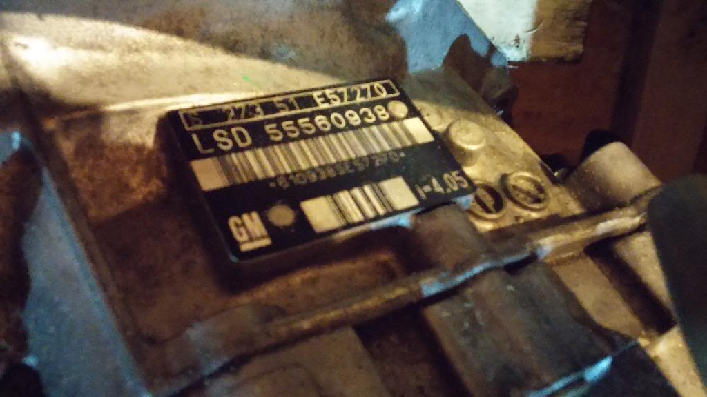

  #1635
also judging Johns post, looks like i got a legit Quaife LSD trans! got it off an 07 LSJ with 15000 miles reported on it, which puts it around 25k total miles now : sure feels good when on the gas around the turns; it really pulls the front end around. Haven't really gone any burnouts in it but kinda been wanting to try to peel 2nd gear just to leave a nice long 11 somewhere haha
LSD .
Genuine
Psuedo
Compared
