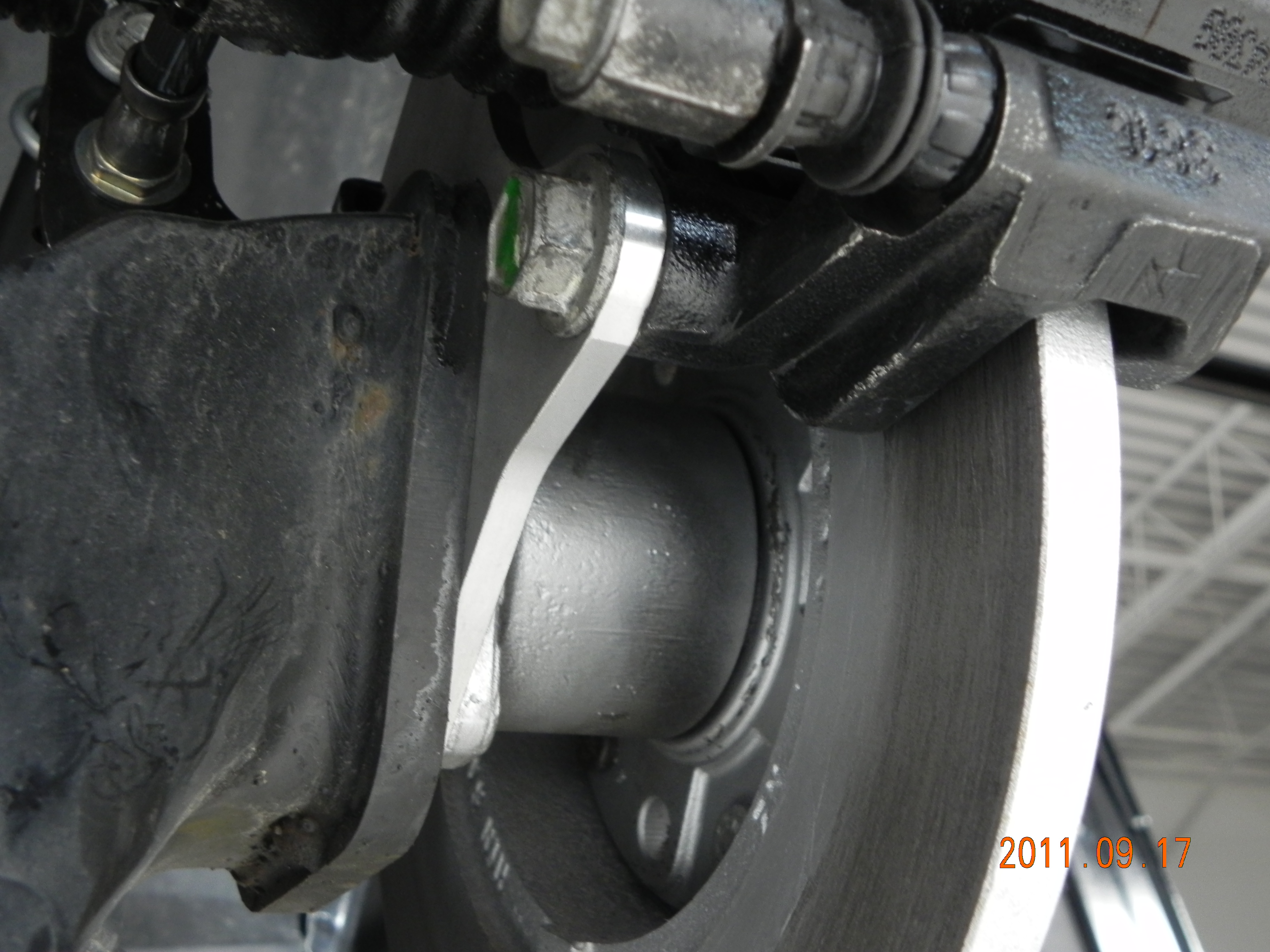

John I didnt read it on the first page, or the next few following then i got lazy, how much is your twisting beam set up? (including your updated bushings)
A shop messed up threads on the top mounting location for the caliper when Mike owned the car, probably the cause of all his brake issues. I'm worried they arent going to play nice or good business since they sent him on his way with the messed up brakes after repeated stops in complaining of issues. Unless you think chasing or helicoiling the thread would be acceptable. I'm afraid its going to be a serious pain to remove to bolt (already attempted to and learn its seized pretty good) and i'm worried about ruining the mount.

the caliper is clamped to the TWB by a bracket through a hole that is not threaded. So no problem you may only need a bracket.
check this picture. bear in mind its a converted drum brake car and your car has a welded plate that comprises what you see here in shiny alloy. The bolt goes through the hole in the bracket ( welded plate in your case) and threads into the caliper bracket. This is an LSJ rear caliper but the LNF is the same mounting system just a different caliper

Talk about having a moment there john, I guess I was irriated that a shop would sent someone out with incorrectly installed brake calipers my thinking went out the window on that. Any idea where I could source that bolt? (Pretty sure its getting cut out, there's ~1/16 between the bracket and bolt head and it won't go either way)
