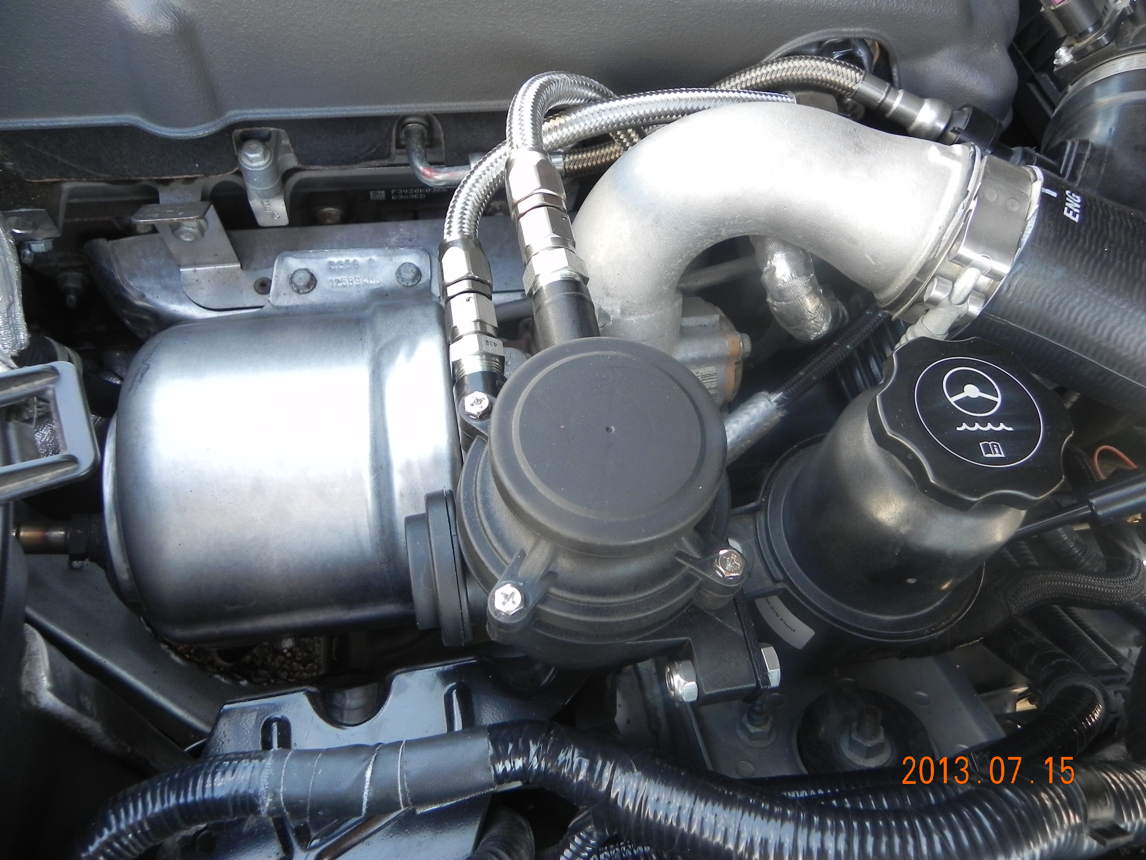

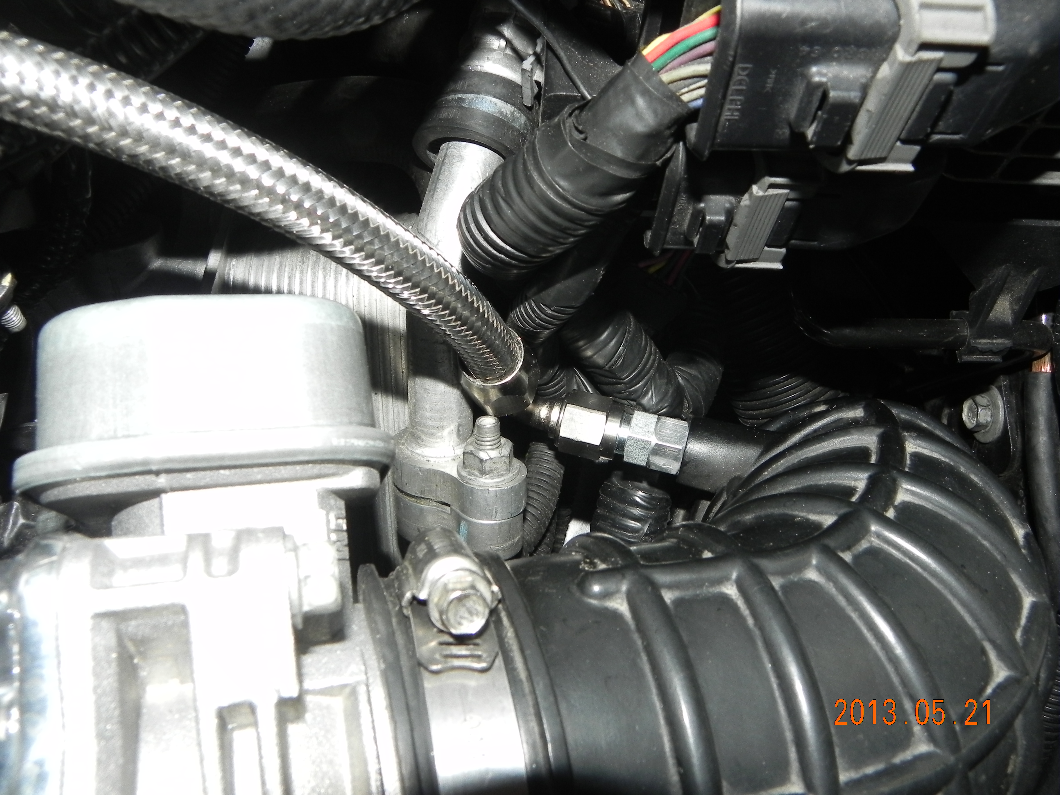

pull the pcv nipple and tap the rocker cover is preferred for a nice install. Depending on the inlet tube, a weld in /epoxy in/ push in fitting ; mount the seperator, bracket and hardware provided, and change the dipstick for the new one provided. If you have a laminova thats the longest pita part.
This is the Redline install. I have changed the hose routing in and out but thats the basic set up.

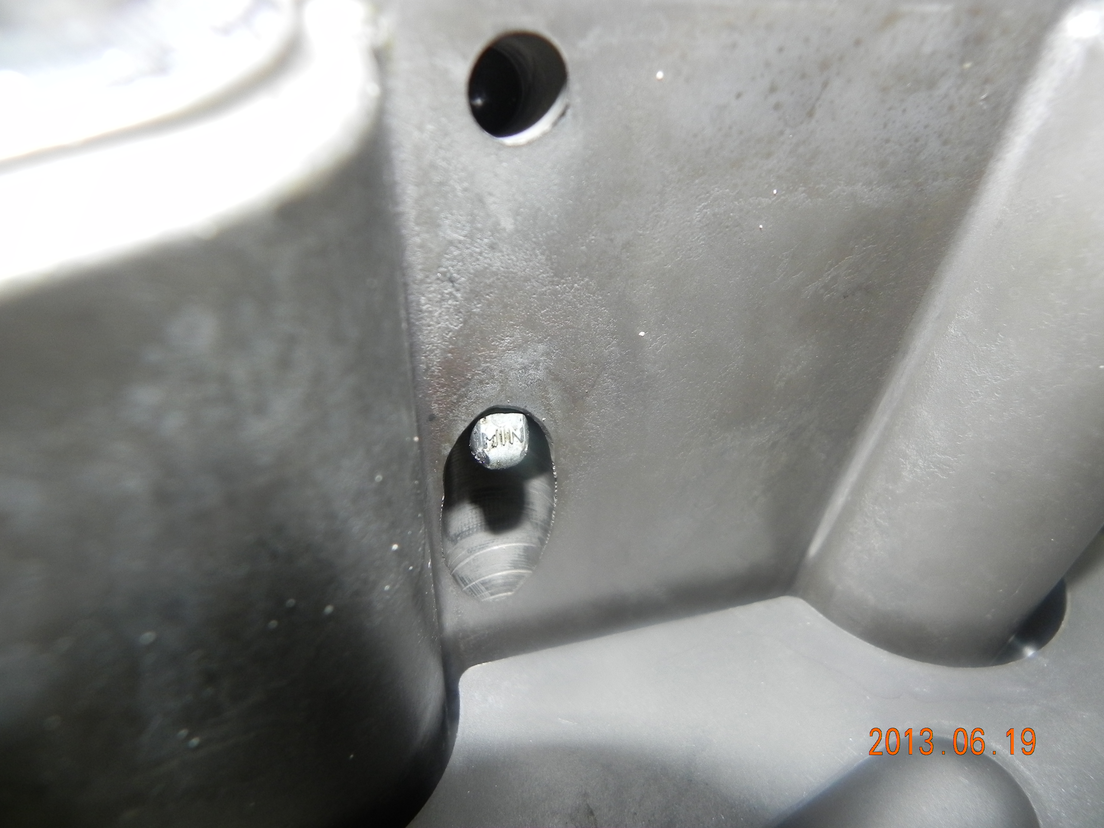

This is a threaded port on an LSJ cover

this is the redline set up to a stock Redline inlet tube:

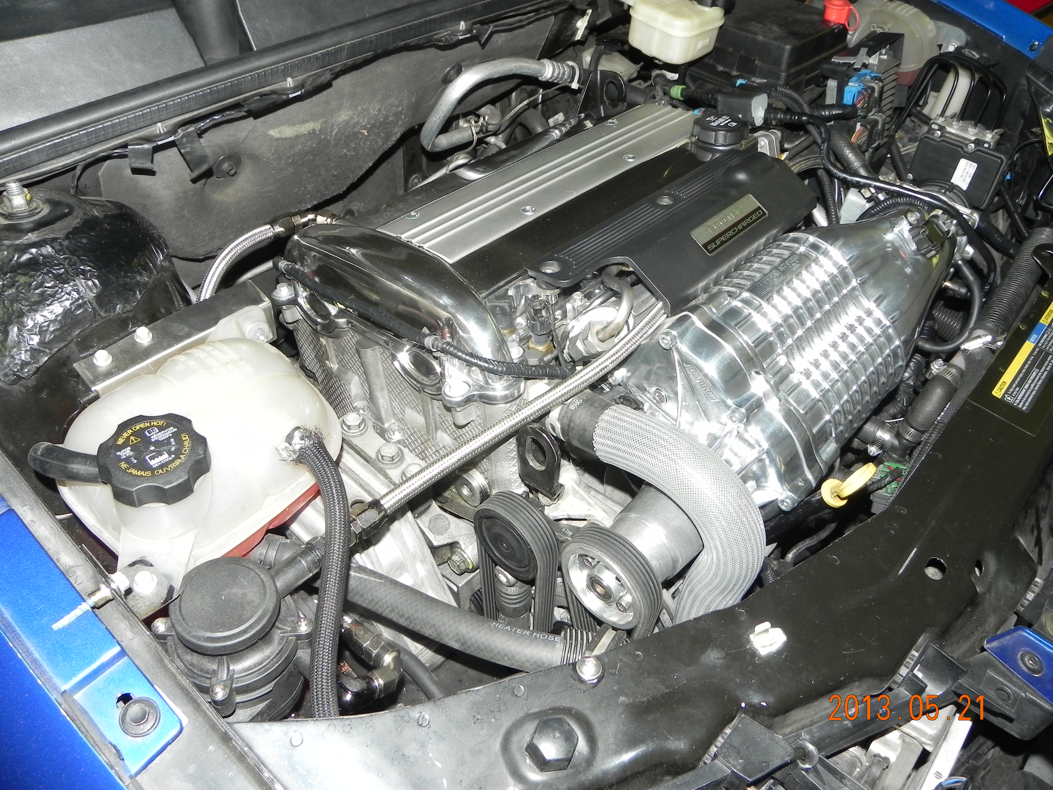

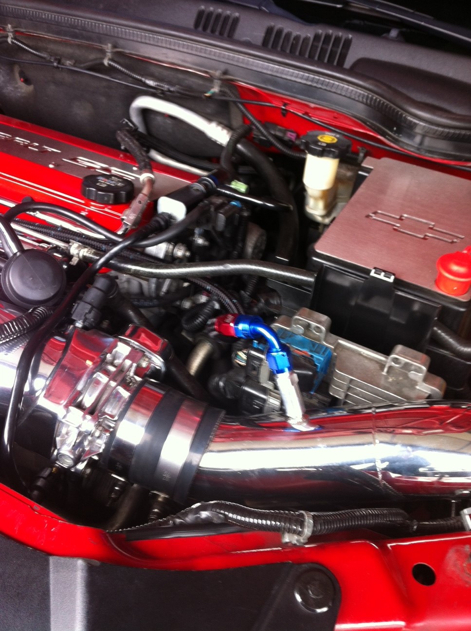

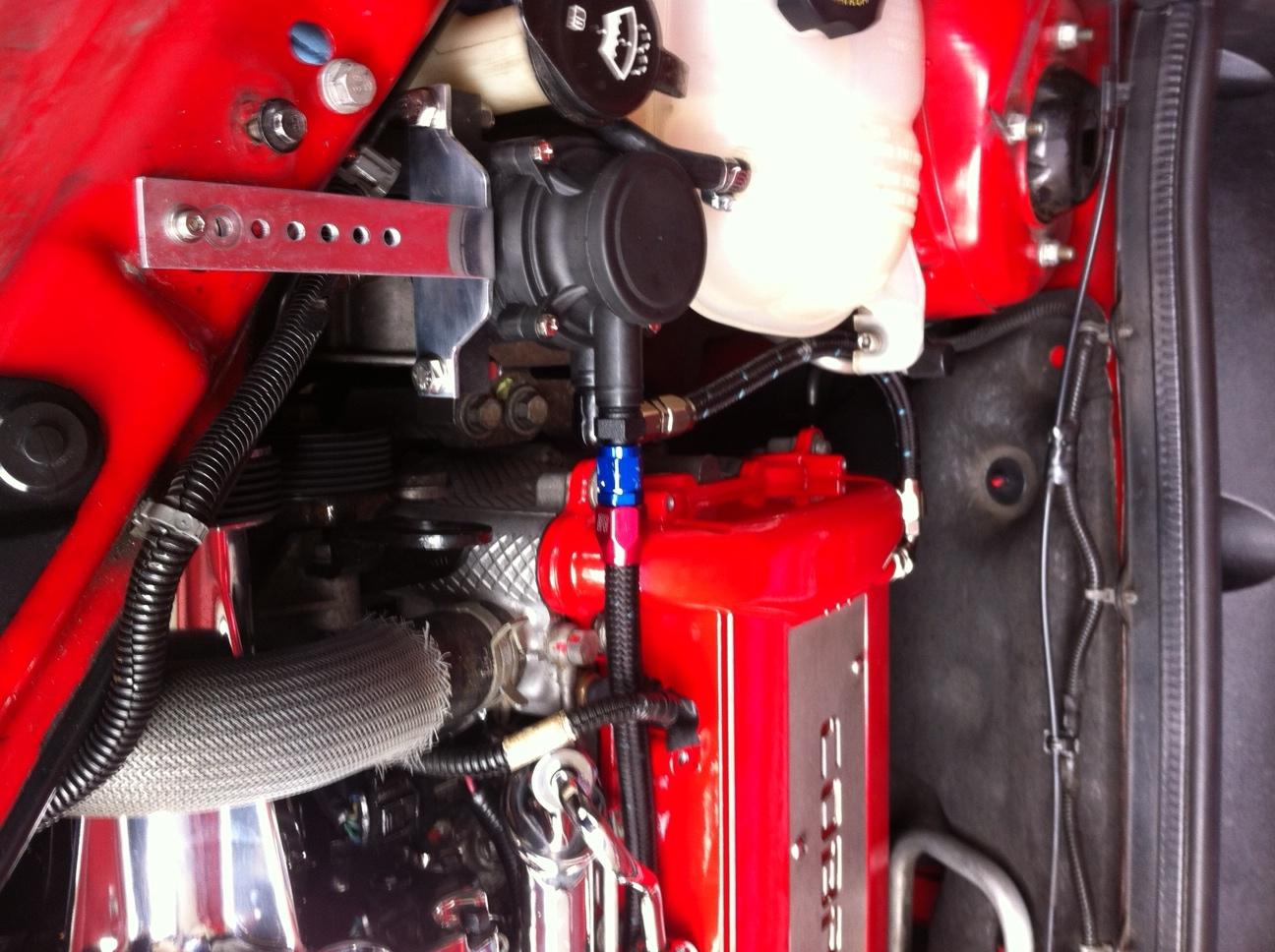

This is a cobalt set up line to the inlet tube
the cobalt bracket/ same things the line in /out has changed. And a return line check valve is now included.

So one line to the intake and then one going to a drilled and tapped hole in the valve cover. or is there already a hole on the back of the valve cover?
Old Aug 13, 2013 | 09:15 PM
  #637
Powell Race Parts's Avatar
Joined: 04-25-11
Posts: 6,128
Likes: 47
From: Port Perry
yes
