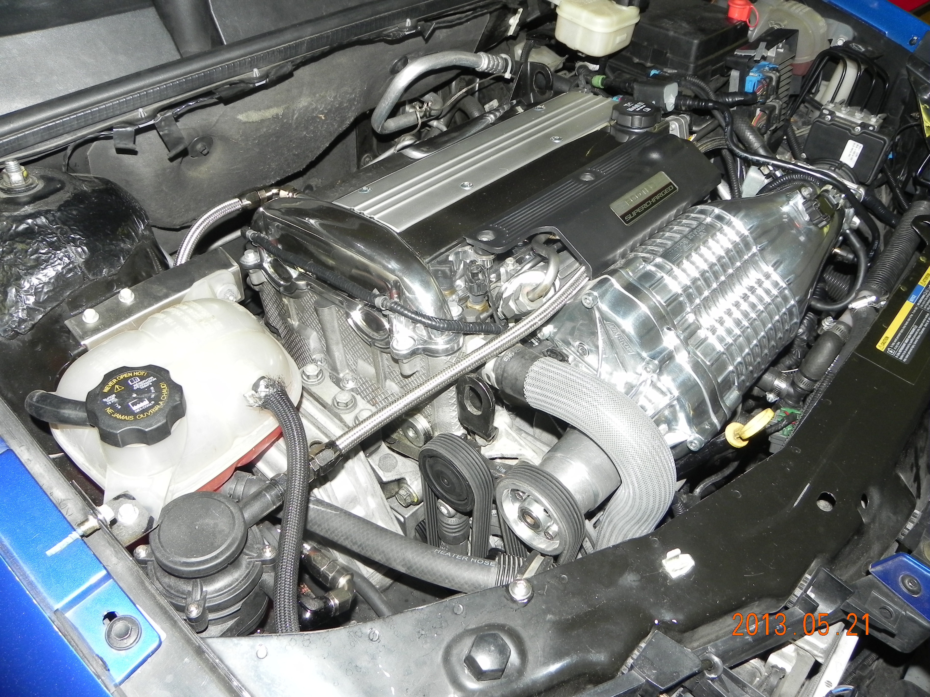

On another subject I have been producing LNF PCV upgrade packages for about a year now, and decided to do one for LSJ, I have pulled apart so many inlet manifolds and seen so much oil in the intake.
Here is my set up

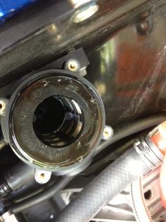

Size:  4.23 MB\and this is what it looked like when I pulled the cover off after the CED trip
and this is the exit port to the air inlet, with the seperator filter removed; dry as a bone... the exit port is top one right of picture. the middle one is the overflow vent.
good news for my motor. I am thinking this is a very worthwhile upgrade.

John the line running out of back left corner of your valve cover the stainless line where is that headed? Mine seems to be getting oil and gunk on outside of it. Mine goes to the right though?
Yes. That is stock routing on an LSJ , It has a PCV which uses one line for both inlet vacuum and vent from the cover. It goes right, along the back of the rocker cover, to the front of the engine and the inlet tube. I am thinking the engineers did that to keep some heat in the PCV hose, as condensation is an issue with the front mounted PCV vent on Cavalier Ecotecs. But the 2.2. and 2.4 kept the front mounted vent up to 2010 so I dunno if thats true or not.
I ran the hoses that way as its hard to package the seperator otherwise.

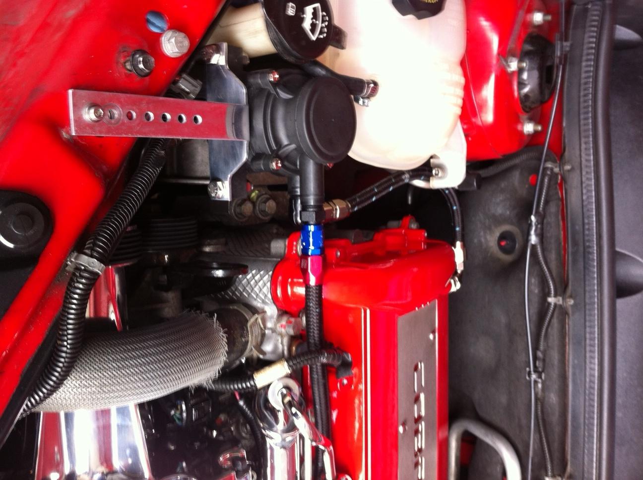

The Cobalt goes here.
Time will tell if there is a condensation issue I have to deal with. I do have a customer with a Turbo LSJ in NY , Chris there has a nice conversion but his current set up generates a HUGE amount of condensation and I am not sure as we are fitting the PVC upgrade to it, if there will be enough seperation to deal with excess moisture.
SAABS have a huge PCV issue 2001-2004 2.0 ecotec style motors, and one guy in China runs an oil seperator AND a water seperator, and for some folks motors it may require that for winter driving. Not sure. I dont run my LSJ in the winter no more, I am going to " honor the timeless classics "and keep it for ever....
