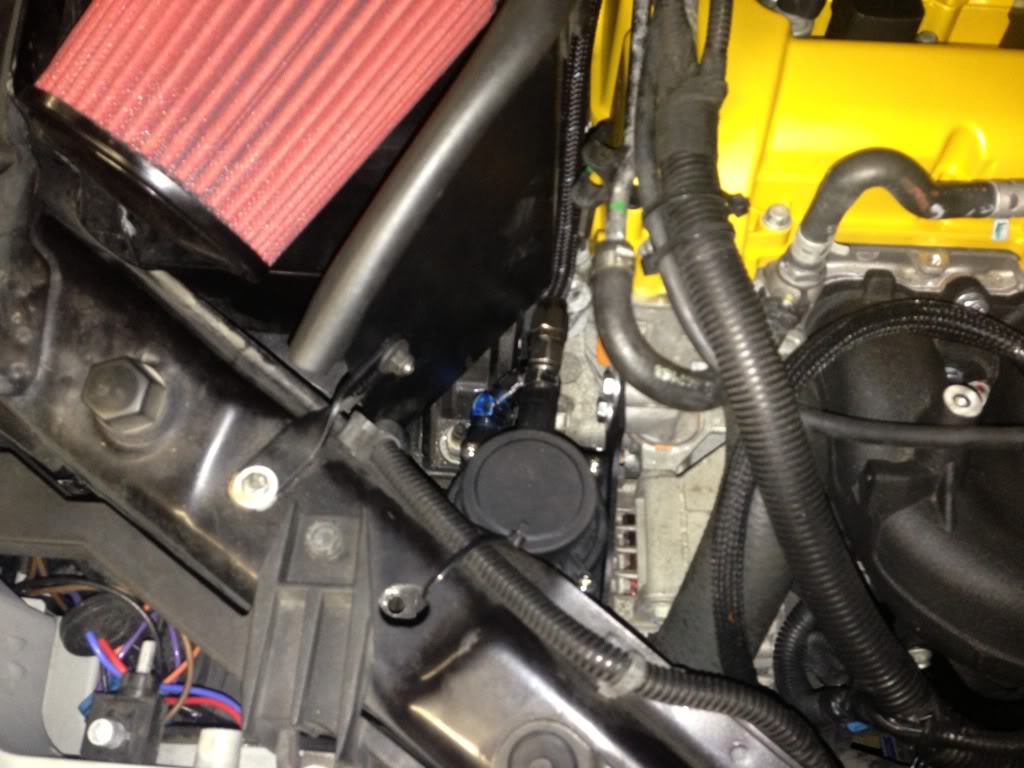

Got my PCV hooked up, all is well so far!

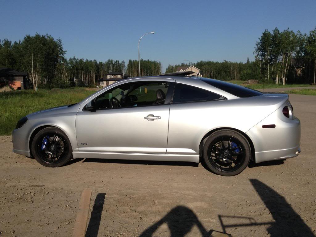

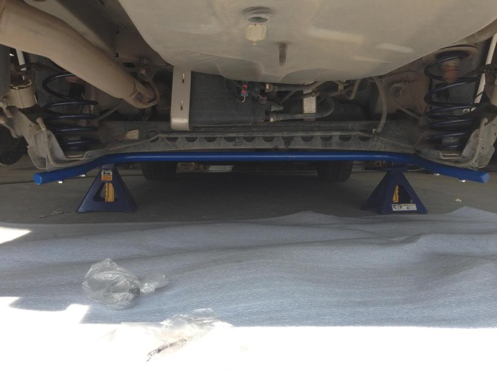

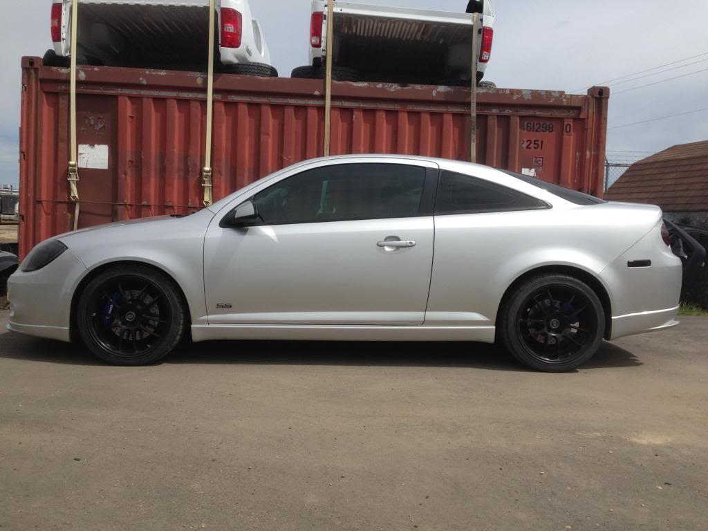

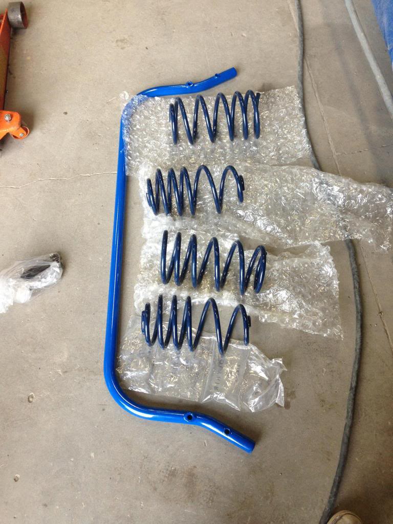

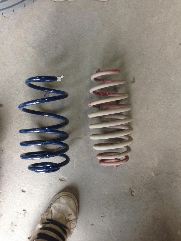

So I got my YYZ springs as well as my hardcore rear bar installed over the weekend, and wow! Car feels night and day different from my old Sportlines. Ride is 100% improved and id say on par with stock, although it has been awhile since my car was stock The turn in is much sharper and under steer is all but gone, car is much more neutral. Ill get a chance to try out some more aggressive driving this weekend at my first autocross event the only thing I don't like about them is how much higher the rear sits, which really isn't that big of a deal and I'm probably the only one who will notice lol bottom line 9/10 highly recommend!
Side note: When installing I'd recommend changing the fronts without a spring compressor as detailed by John above /\ much easier and way faster (well for me at least)
Now on too the pics!

looks good to me.

looks good to me.
Me too just when I thought I might be getting bored with it and you made me fall in love all over again! Thanks again!
