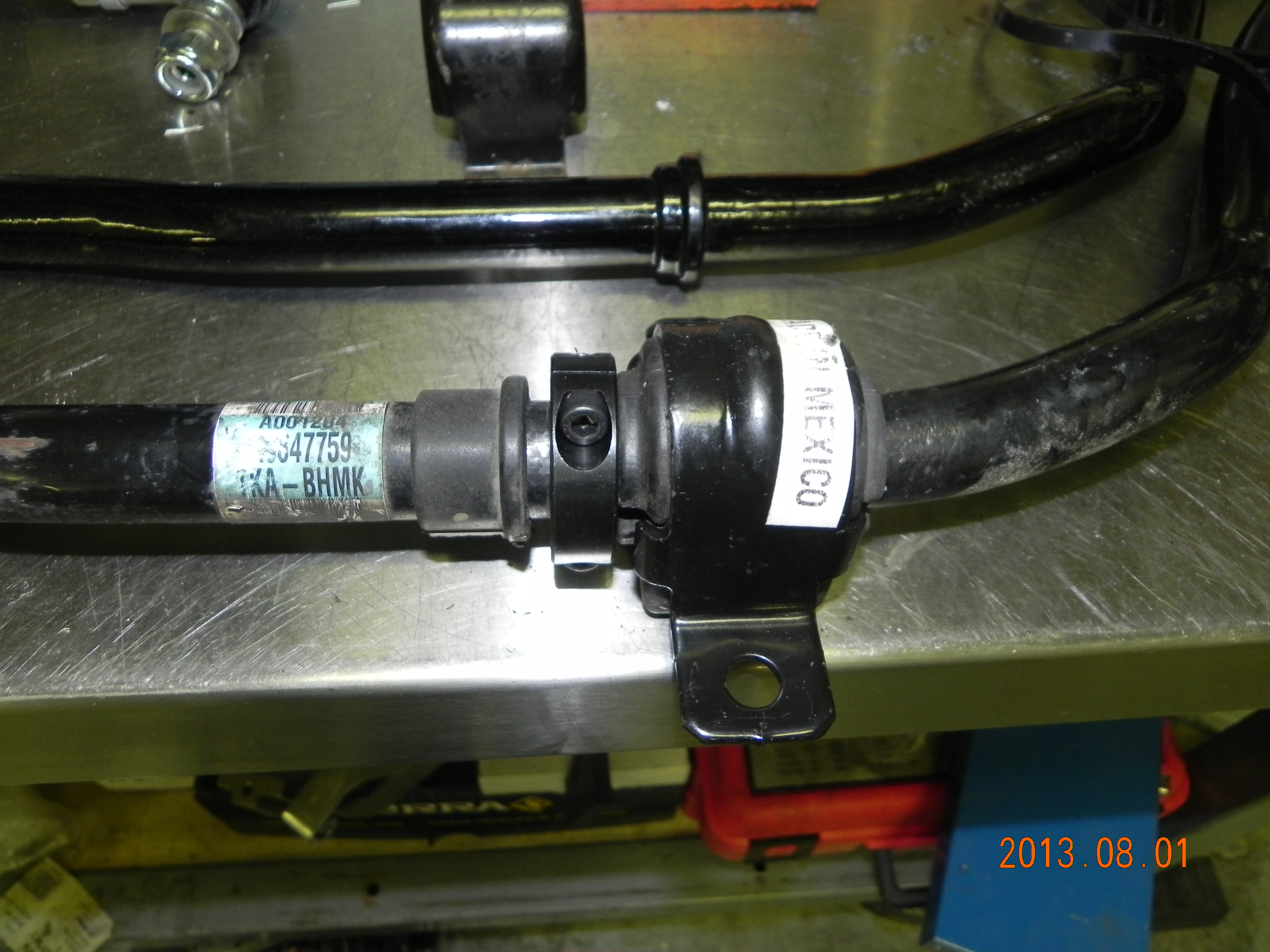

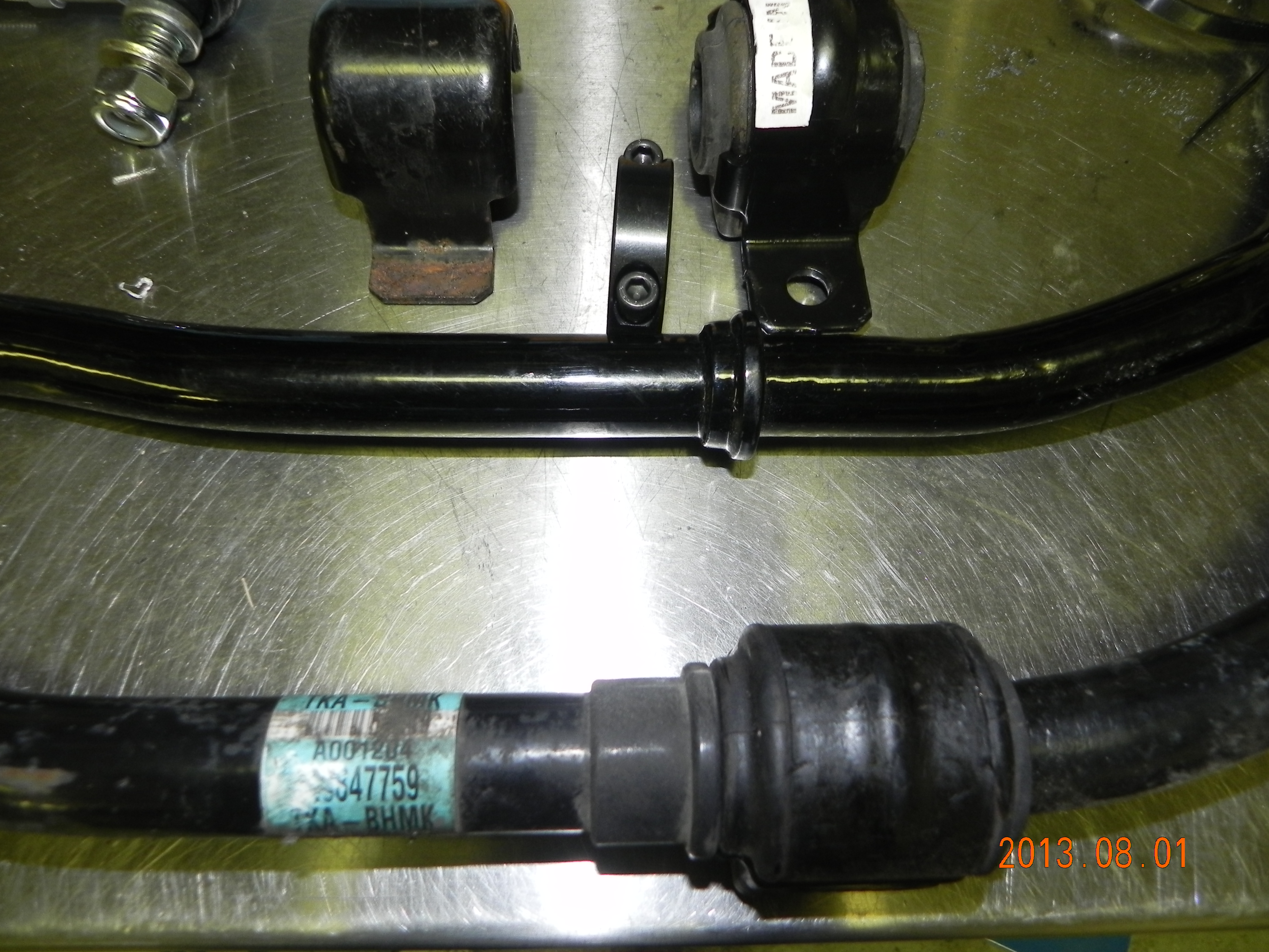

background: adjustable drop links. middle Fe3 bar.
front FE5 bar
note the pillow blocks the single bolt beside the two bolt.

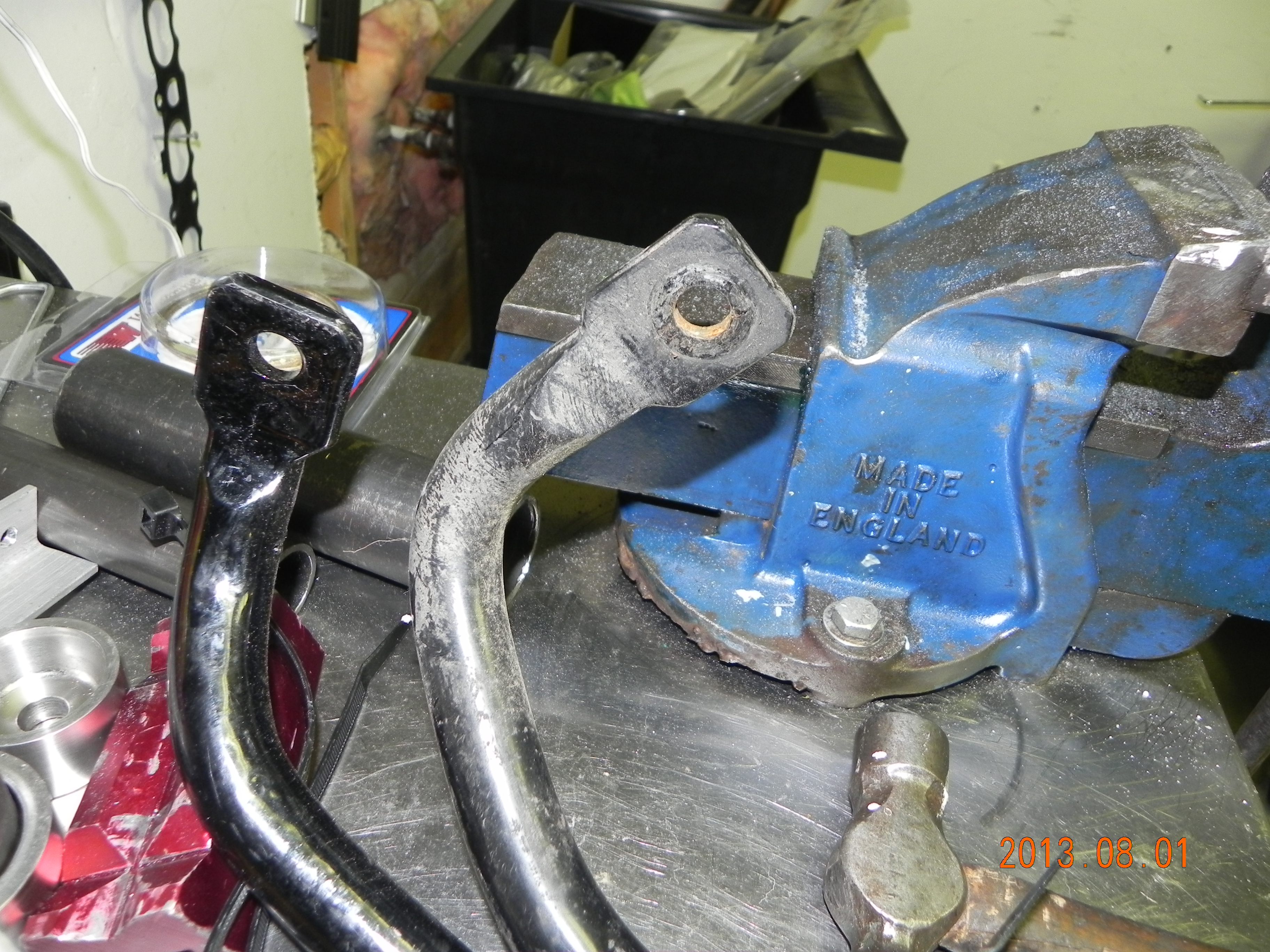

note that the FE3 has shorter plastic travel limiters than FE5, and the clamp blocks will stop the bar from walking to one side. The plastic limiters move easily.
here it has been moved.Name:  DSCN8155_zpse1d4770b.jpg

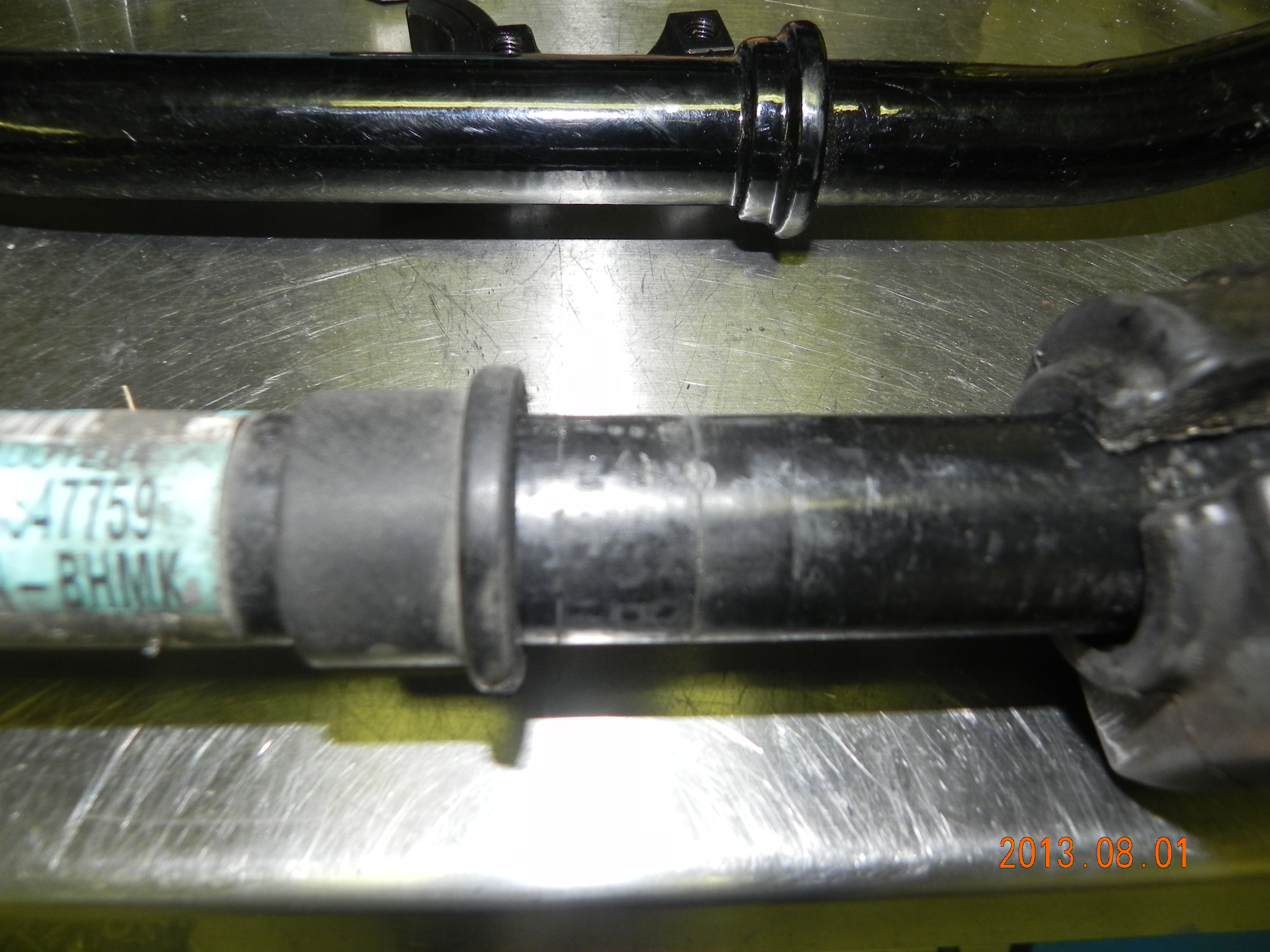

Here I have installed the clamps. The plastic sleeve is left on, I normally take it off. Its soft brittle and removes easily enough.

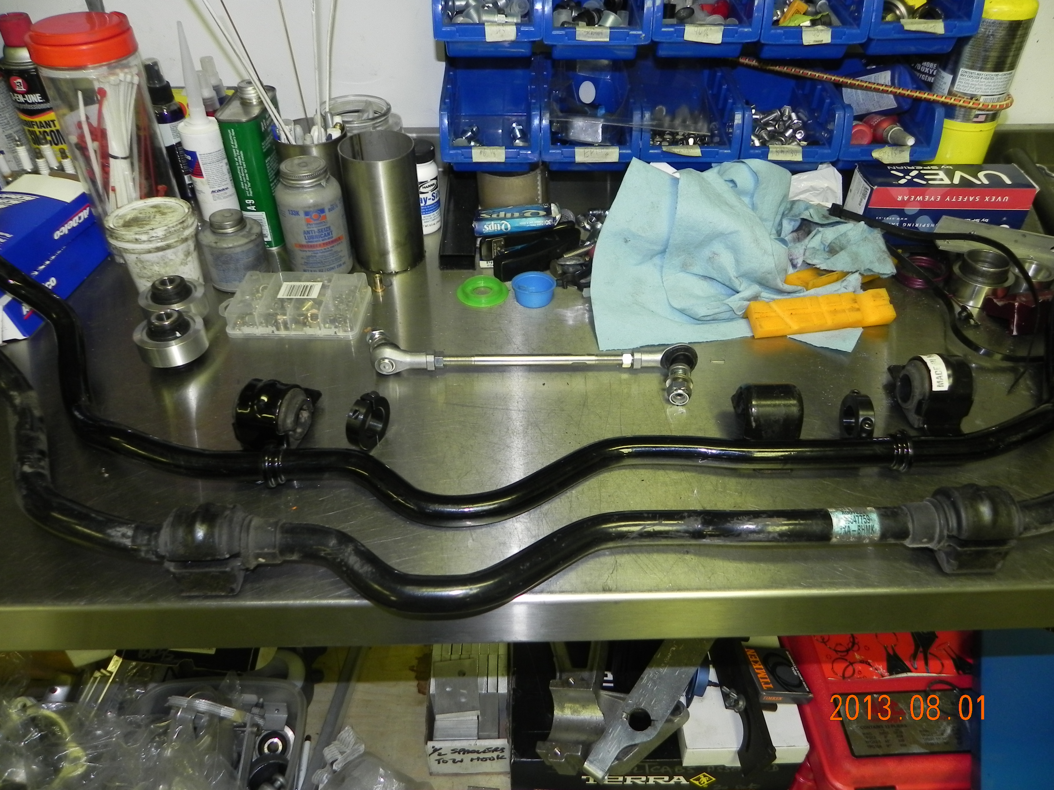

note the length of the arms ( FE3 has longer drop links and the FE5 shorter with different geometry.

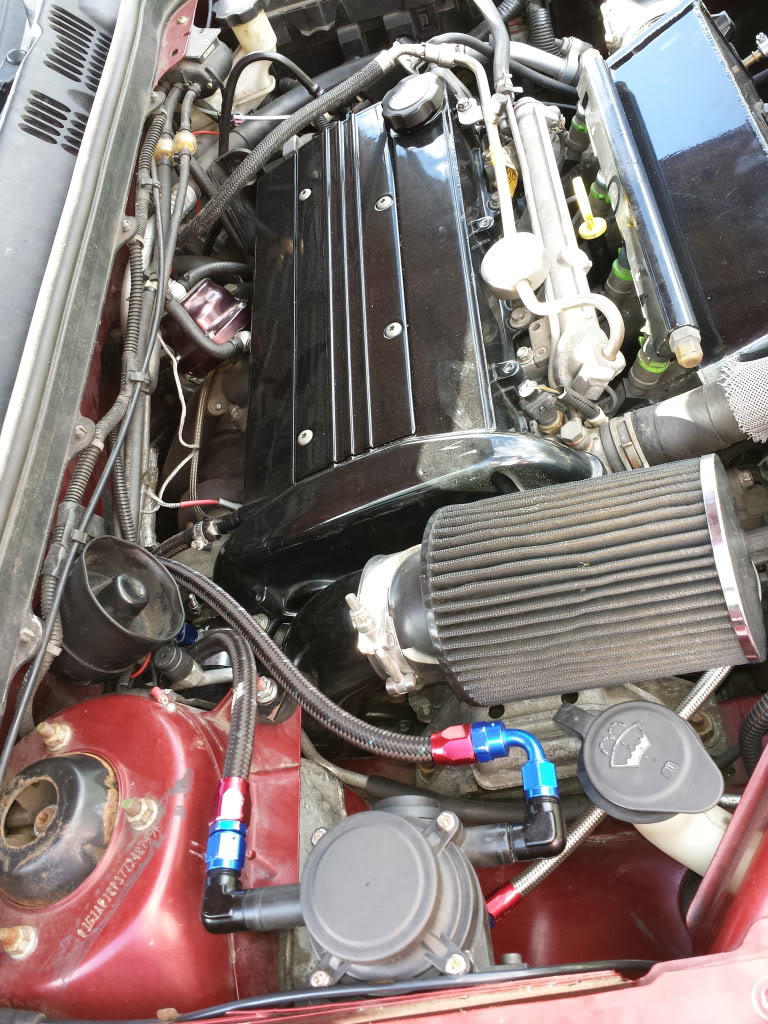

Just wanna post what john helped me out with in person the other day. Name:  20130810_175450_zps86aa5df9.jpg
if people dont see what im talking about, its his PCV solution made to fit my LSJ. seems like its working alright. i just need to plumb one more line into the front of the head and i should be good. thanks again john.
