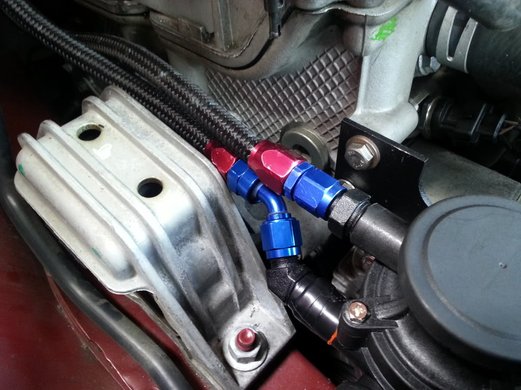

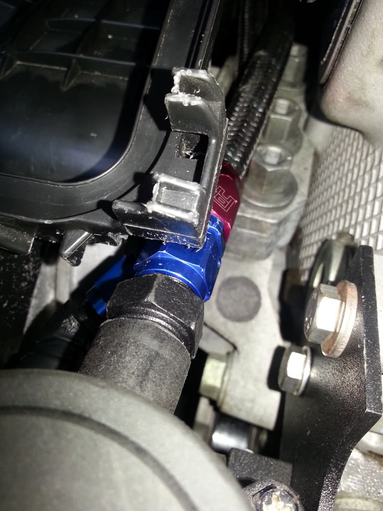

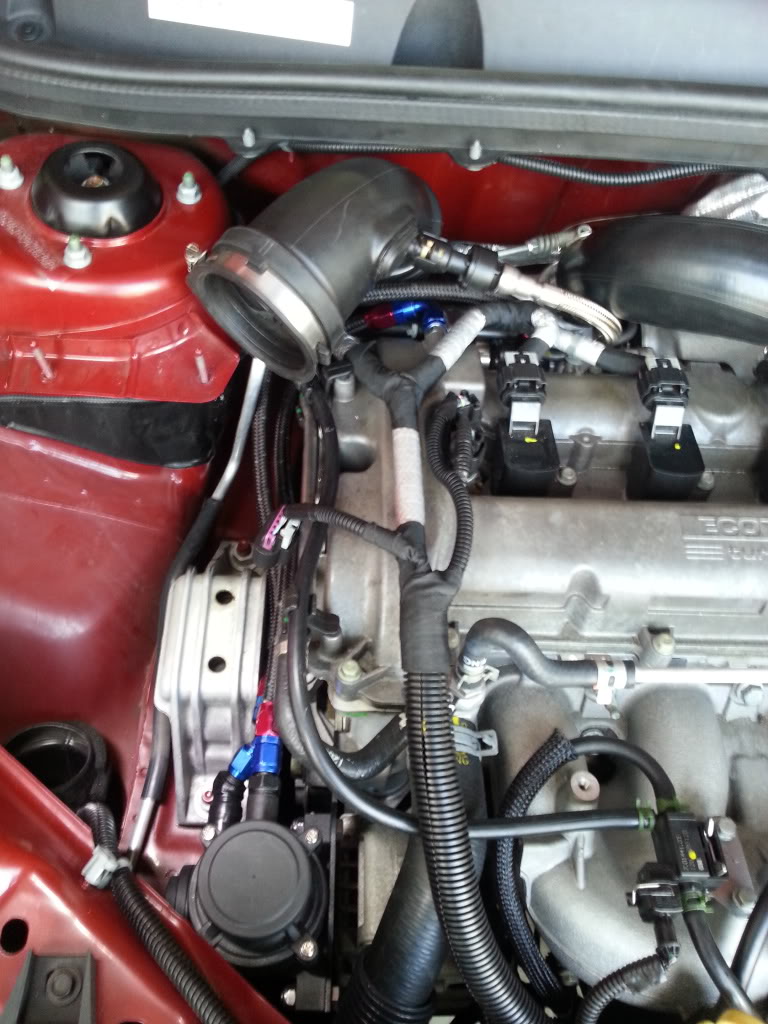

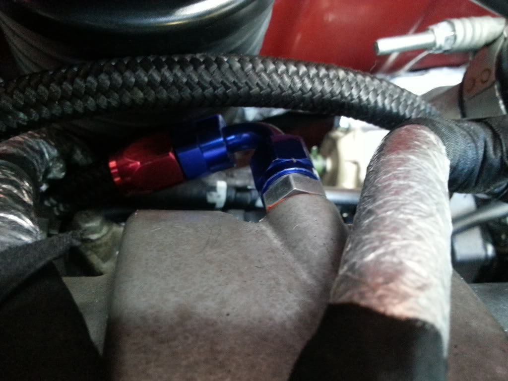

Installed my PCV separator yesterday. I tried doing it with a stock OEM airbox and it was a huge pain in the rear. I had to end up cutting off the top fitting by a half inch, tapping it with a 3/8NPT, reinstalling the straight fitting (as the bottom port HAD to have the two 45 degree fittings or else it would contact the engine mount), turning the bottom fitting in another turn, and then dremeling off a section of the airbox on the front hinge as well as a tab the lower arm.
I ended up cracking the turbo port on the PCV separator too. I apparently am an idiot...but some RTV and tape ended up fixing that problem just fine. The valve cover tapping was very easy as well as the turbo fitting install. The only thing that concerns me is the lower hose fitting is contacting the side of the engine mount so I hope it doesn't vibrate things apart...
It must be noted that the customer service John provided me through the whole process was absolutely top notch. He emailed me back idea's and possible solutions within hours of emailing him, even on the weekend., He also offered to send me a new bottom half to the separator once I get my whole fuel trim thing figured out. Super nice of him since it was my fault! That is customer service!
Pictures of how I had it set up:

great pictures thanks for sharing.
John are there mods that you are planning to make to the kit in the future for a stock airbox
also would I have the same issue with my stock hhr ss airbox?
this kit does not effect the fuel trims does it?
