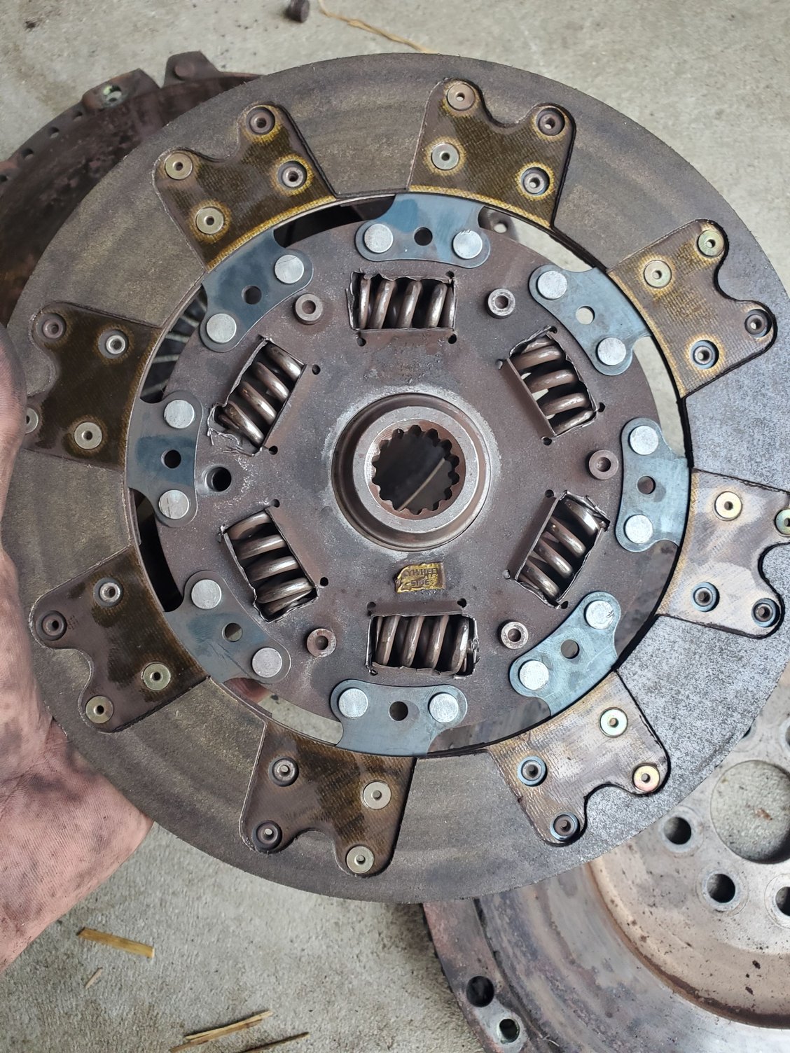

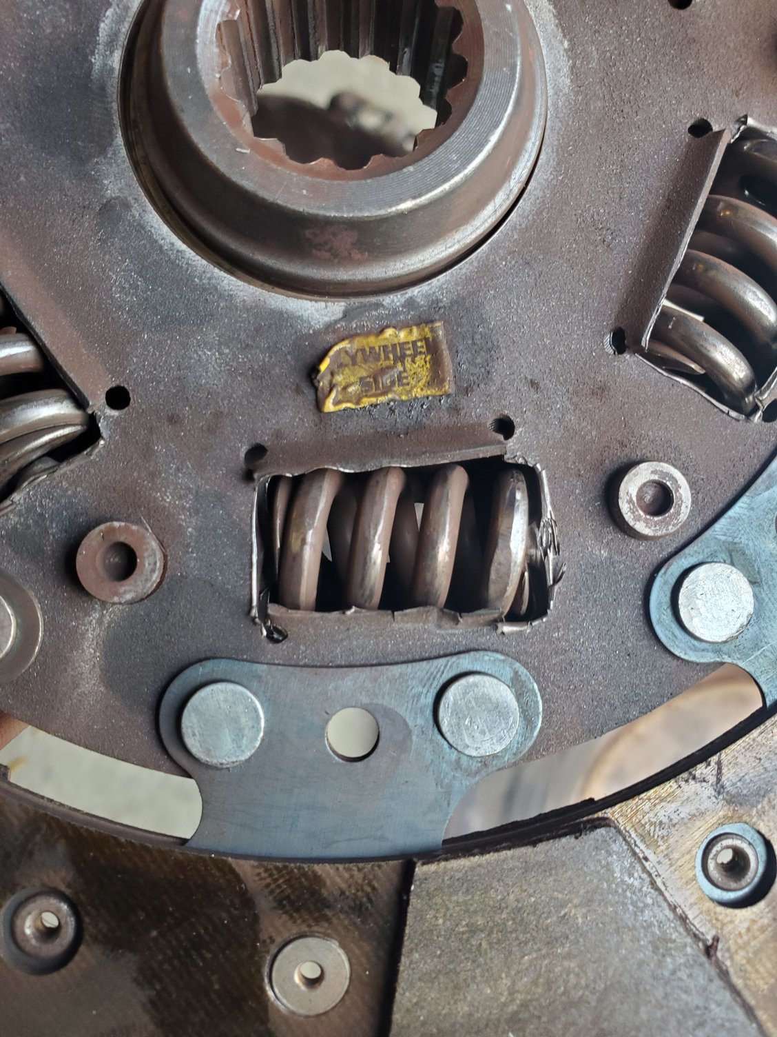

So i took the transmission out and went ahead and pulled the pressure plate and found the clutch disk like this. Bunch of metal chipped off around all the springs and one of those little hex key uts was completely out and rattling around in there.

Other than the clutch disk this is all I could find that didn't look right. I went ahead and threw a new TOB in with a new disk and everything is working good agian. Atleast for now anyways. I was able to make the trip back home from Kentucky to Missouri with no problems.
