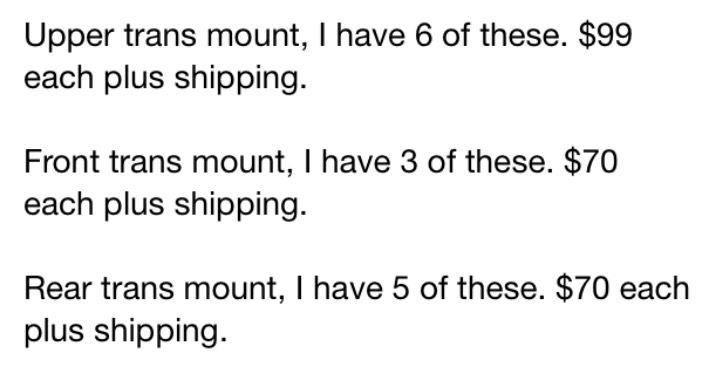

Also what is the best setup of mounts? How about zzp engine billet mounts? $150
Powell has these
