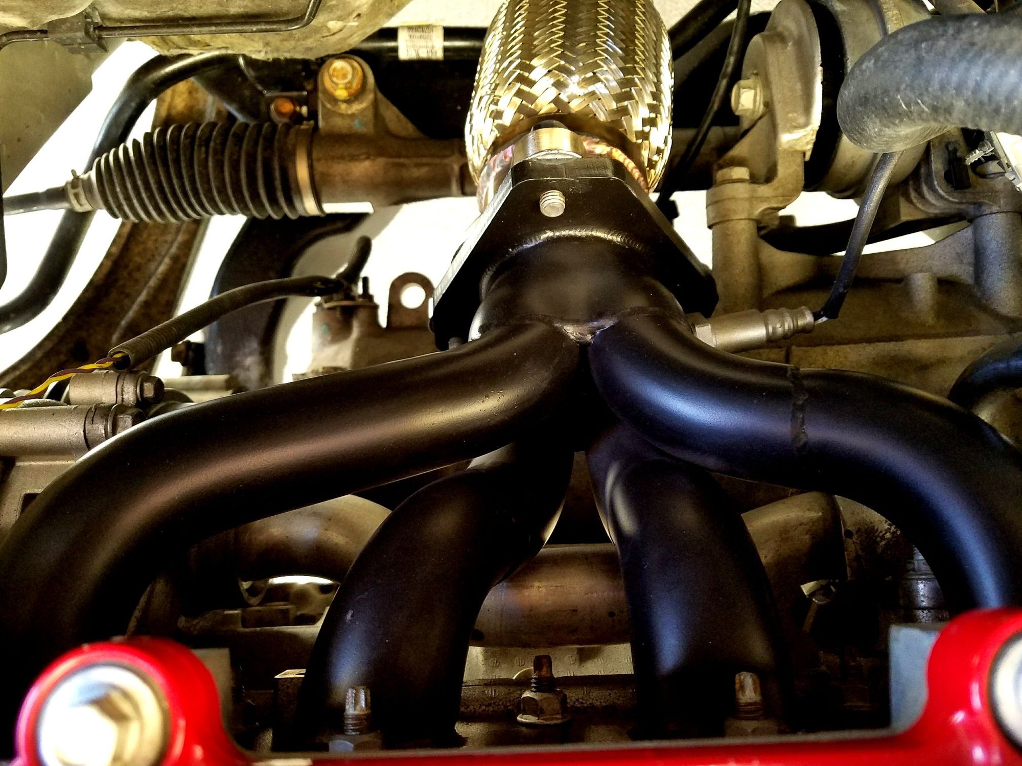

A nice weekend to get things running. Took it for a spin this way and it's running great. Waiting for a new condenser then the front end will go back on. Being the most forward item, it has been beat up from bugs and anything else that makes it through the grill.
Just a few more wiring needs, a couple fittings and it's done.
High temp powder coat on the headers is holding up better than I thought.

Thanks...
The dual pass and addition of the OEM heat exchanger as well as the secondary heat exchanger is making a very nice difference in how quickly the temps recover. Bleeding at the Manifold and heat exchanger makes it a snap to get the pump flowing coolant.
Still need to machine a "Y" fitting so both can vent to the reservoir. Something I'm not liking is the raspy rattle of the down-pipe at certain RPM's. If it is the flex section I am considering wrapping it but it may be the inner section rather than the outer mesh.
Nice! Still not a huge fan of where that cai puts the filter on the lsj's.
I have removed the shielding from the bottom of the front grill area so air can get right to the filter but road spray is still blocked. I heat wrapped the pipe all the way to the MAF. Rather than fiberglass, this wrap uses a crushed lava rock woven material that is rated higher than fiberglass.
