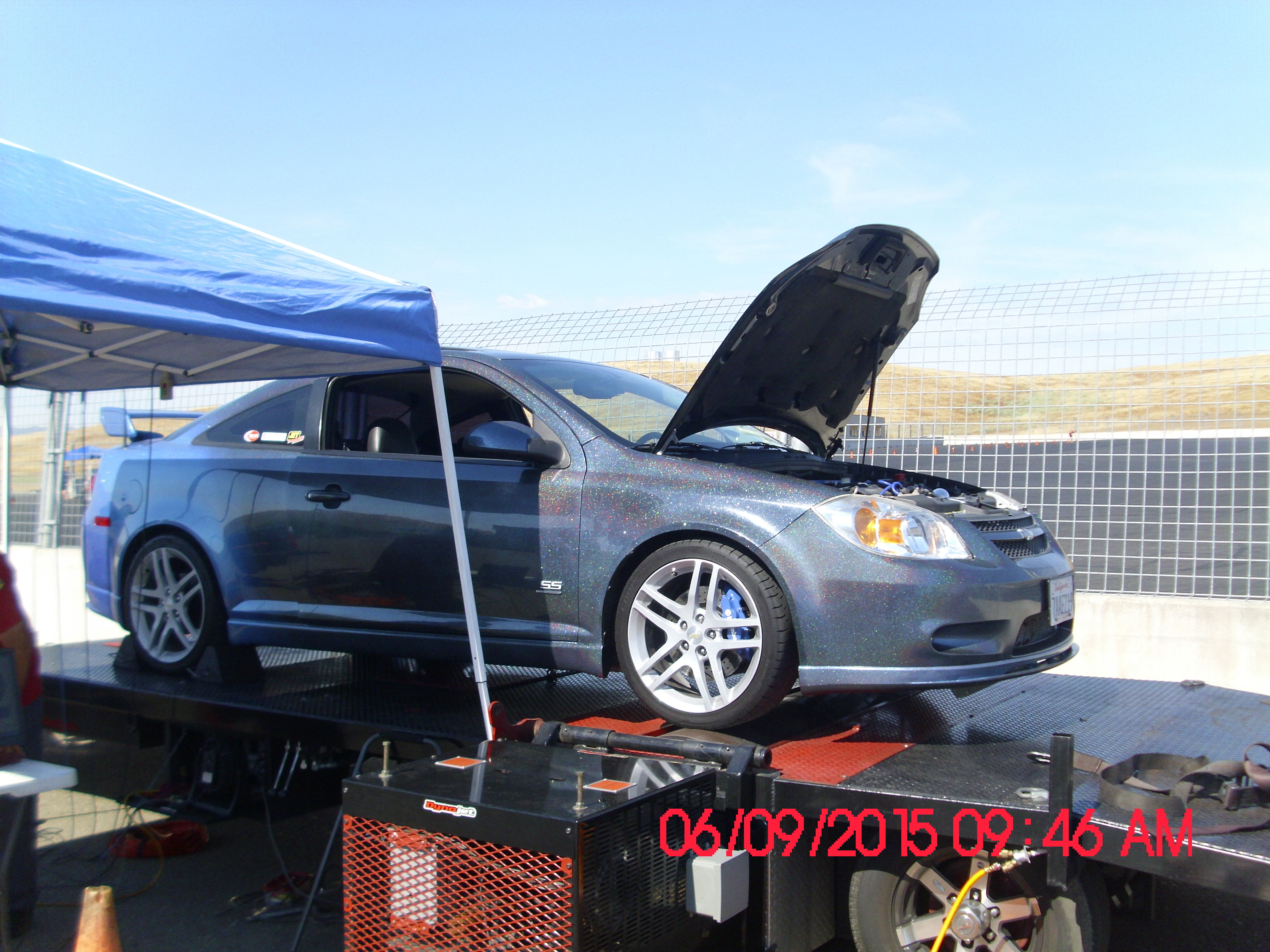

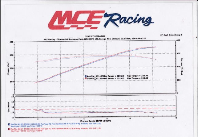

Dyno 2006 chevy cobalt ss sc
We took our car to Thunderhill Raceway in Willows, CA. There is a shop there called MCE Racing and they have a great Dyno. We learned the importance of using a dyno that can put load on when testing a car that is boosted to get an accurate read. We used a 5% load on the dyno and pulled an incredible 351 whp at around 6800 rpm and 296 max torque. We had ran it once without using any load which the shop owner said is not accurate on cars that are boosted with pulleys and such and it ran 241 whp, Again he said this number is not accurate because the pulleys and blower are not working properly if load is not used which represents the power you would be obtaining actually driving your car. Our car has a complete stage 2 and everything for a a stage 3 except the smaller pulley, bigger injectors, and updated tune, but that will be coming in the next couple of weeks. SO we will see what that does to the numbers. The best part is our car is fully street legal.

^^ is that glitter?

The 241hp is in the ballpark for a stage 2 car. Do you have a tvs? No way your hitting 351hp with an m62

It sounds like his dyno correction factor is off. From my understanding of dynos they don't care what he car has on it, it takes X amount of power to accelerate mass X. Since dynojets are just a rotating mass, even mustang dynos are rotating masses with build in resistors (for lack of a better term at this hour for me).
His correction factor was way wrong for the 351whp, not the lack of load. 241whp for a stage 2 LSJ is normal, he's just butt hurt a little 4 cylinder can put down that kind of power. To bad you don't have a TVS, or better yet a built turbo'd LSJ like some of the senor members
