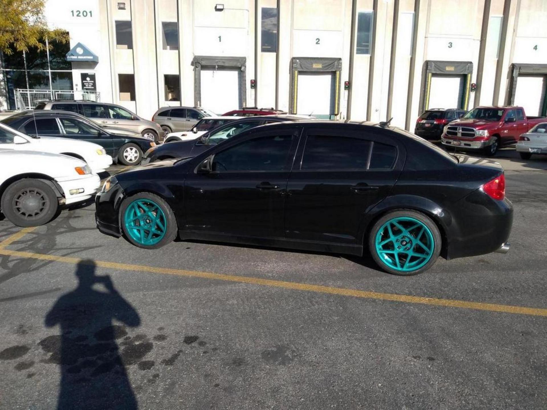

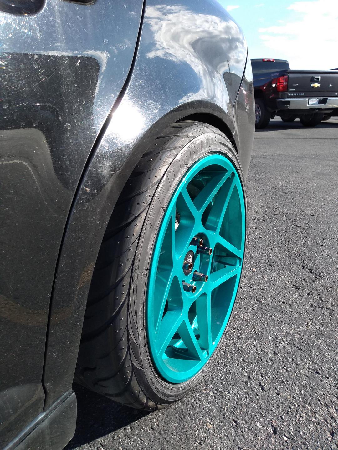

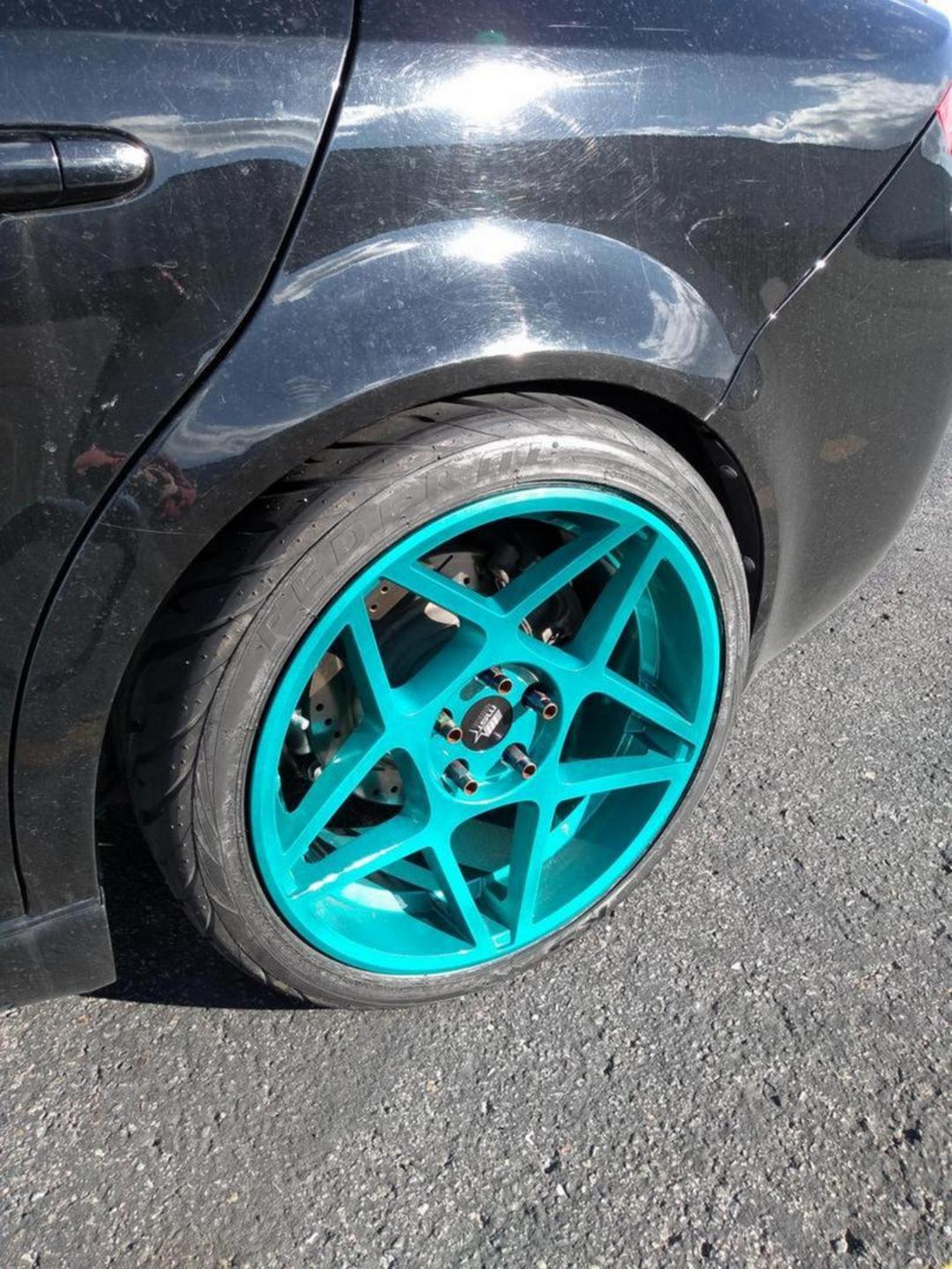

Spent all day getting these put on. Had to run 15mm spacers to get them to clear the Brembos. All in all I'm happy with the fitment. The rears rub a tiny bit on big bumps but nothing too serious. Sorry for the dirty car pics, haven't washed her in a bit.

Not a fan of the color but that design is pretty wicked. Looks good.

Originally Posted by HGT
What size rims ant tires are you running
They are 18 x 8.5 offset +35
I am running Federal 595 RSRR tires 225/40/18 all around.

poor paint! but wheels look good.
I am with you there! I have a buddy that does detailing and he is planning on doing a full wax on it soon.
