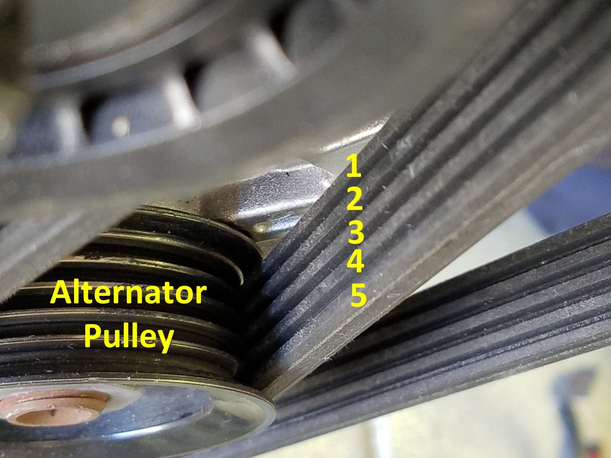

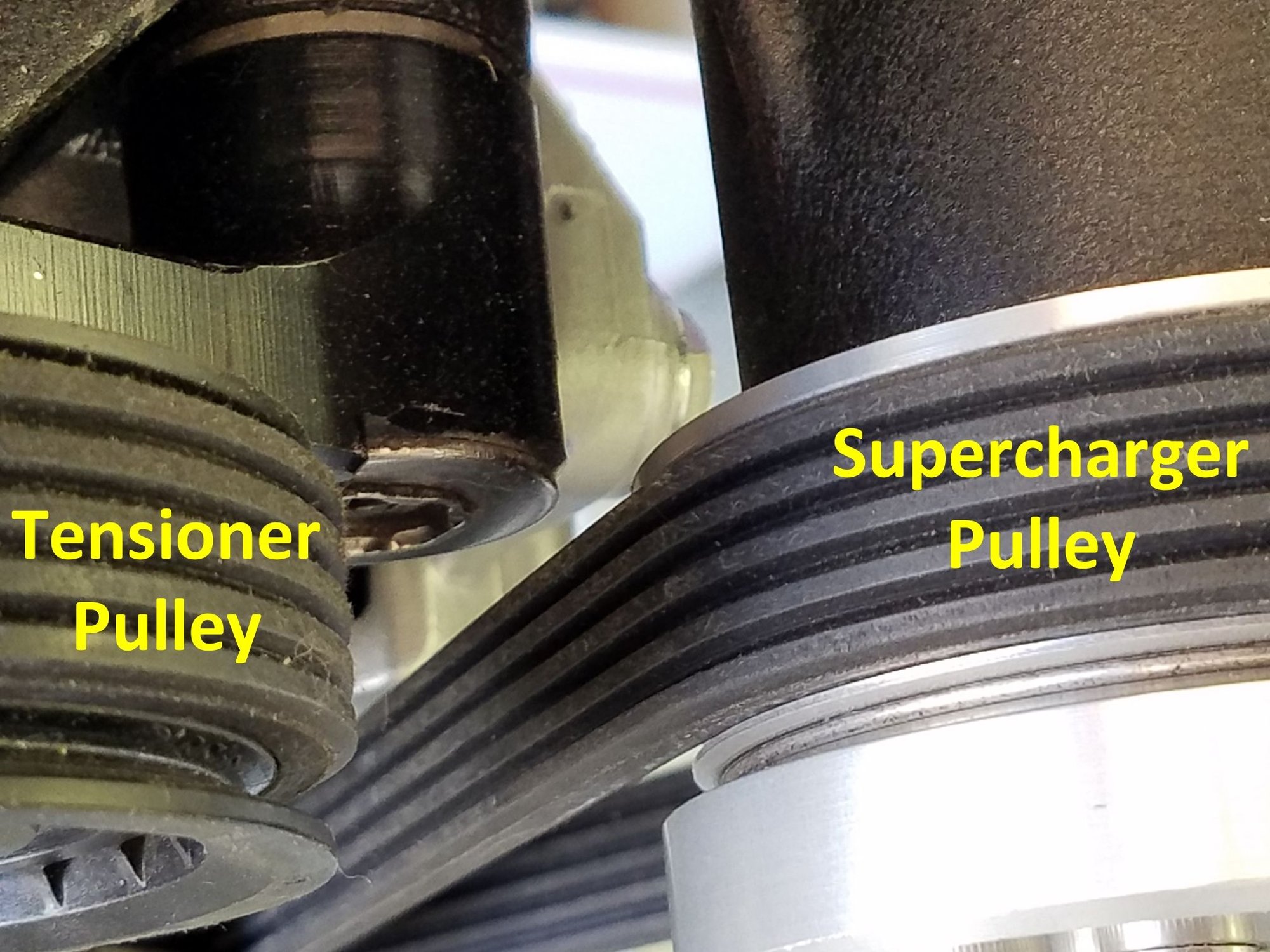

Hi there - I was reading the parts list for the LSJ supercharger swap - one item is a bit confusing:
Stage 2 Belt (Part# 12597993; requires one rib be cut off)
Ok can someone show me what is meant by cutting one rib off the belt?

The OEM belt is a 6 rib belt. The LE5 has 5 rib accessory pulleys. You can either source a 6 rib balancer, AC Compressor and alternator or cut one of the ribs off to fit the OEM accessory pulleys. A new utility knife can easily cut an entire rib off if done safely.
