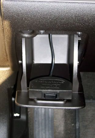

okay the tilt on the steering wheel pull it down push the steering wheel all the way up. place the box between the steering column and the plastic lower dash that goes around it. push the steering wheel all the way down ontop of it as hard as you can to wedge it in there then push you tilt level back up to keep it there.

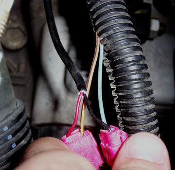

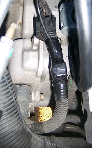

ok finally here are some pics of my hook ups and my placement. its been a long week haha

its hooked up just like mine and mien also goes in and out of stage I with no issues... don't guess i ever did it before but if you read the above post you know that already.

yea I dont have any pics yet but the 07 is a little diff. from yours, the pcm wires run diff on mine there is 2 other wire looms running out of it and its more to the left of the coolant hoes, it was a bitch to get to. but I'll get some pics tonight and post up.

well no complaints and never said it was hard took me about 30 mins also, just it looks easer to get in his photos, my wire loom ran to the left and under the coolant hose, and I just had to hold it and wire at the same time, but it wasnt bad, and at first the taps were not getting a good connect, so I had the guys who work beside me soilder it up. Works fine and hits hard in stage 2.

Yea, its a little different but i was to pull the wire loom up above my coolant hose and work on it, so it was a little easier.

The taps that are in the photos that dave104 posted are thoes the ones that came with it or did you use your own?

they are done by colors = diff sizes, i'm pretty sure those are ones given with the product.
i used my own i think haha its been a while but looking back at the 1st pages pics i did use my own because the ones shipped with it were POS's
just it looks easier to get in his photos
i moved in really close for the pic so it just looks easy to get to but i agree its a bitch haha
