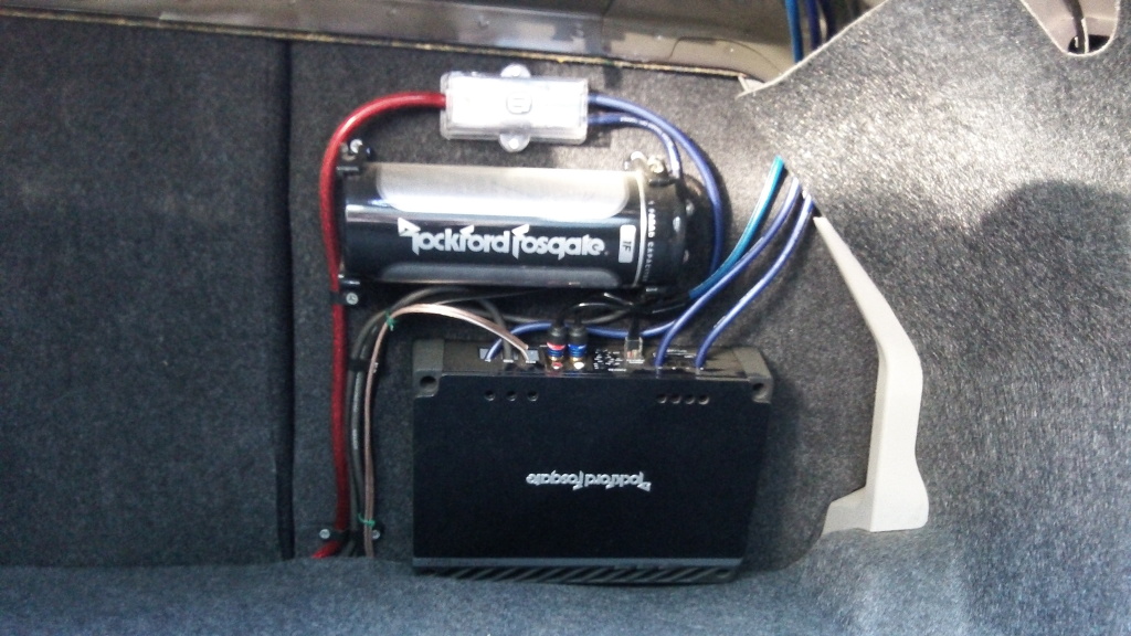

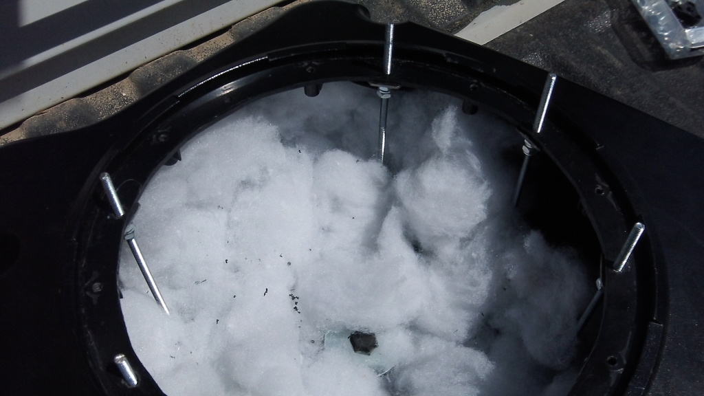

I've installed a Kicker CVT 104 in the stock pioneer sub box. I had to drill new holes and cut out ~1/4" for the opening.
^^^^I reinforced it with some #10 threaded rod to help keep the box from flexing.
This is what I have running the sub.
