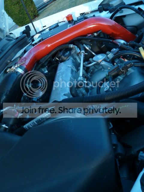

so has anyone here tried putting it in their vacuum line?
can someone post a pic of which hose this is?

yea, pics of which line an what... ya gotta break it down barney style man

what ever hose that goes onto the nipple thats connected to the mani, best way i found was grab a hose the same size as the one ur pulling off connect and suck how ever much u need, an its normal for the engine to act rought when that hose is off

wat does that sticker say on your airbox?
k&n drop in warning ****, its all removed also wit the css sticker, best pic of it rite now
