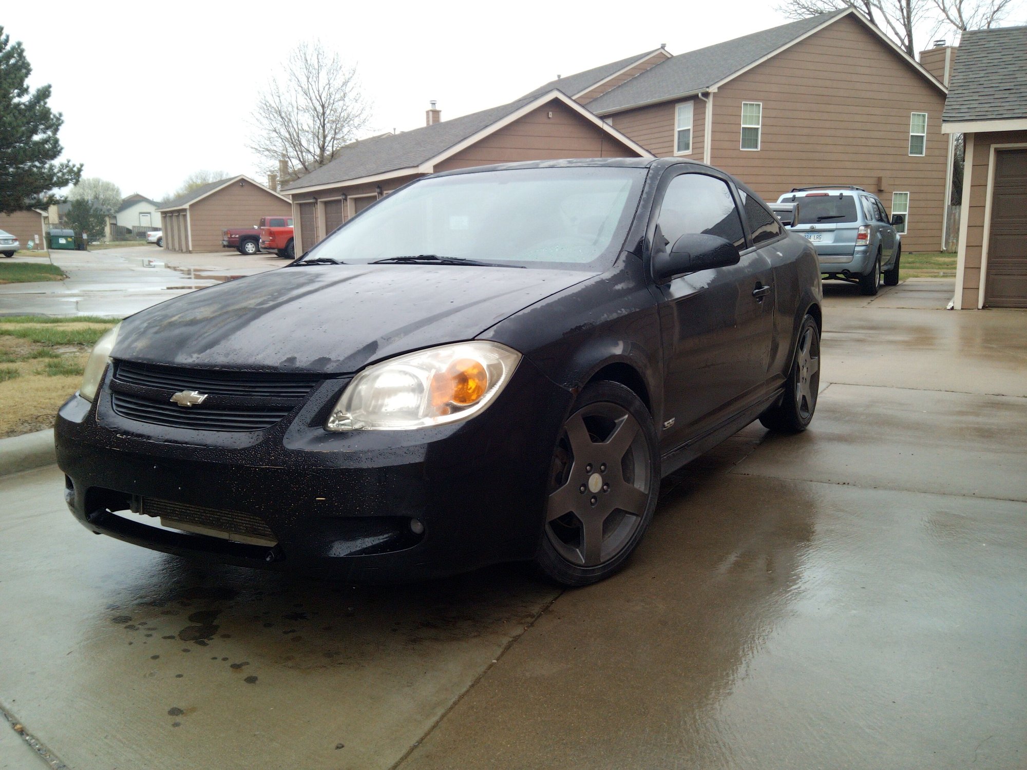

Just picked up my first 06 cobalt ss sc. It's a fun car so I'm looking to get to know it better and build it up.

Thank you and will do. I still have some body work to do on it. Right now it's one part at a time. Doing my intercooler pump this week.

Welcome aboard. Nice clean Cobalt. For mods I just start with basics intake exhaust and tune. After that look into suspension work.

Thanks guys. Monieg5gt I appreciate the info. This week I'm changing out my intercooler pump. It still needs some body work also before I get into the paint job. Then I'm looking into just what you said with the air flow. I might do the suspension a bit sooner due to needing to get my bushings replaced.so I figured just get a coilover package. Does anyone know some budget conscious mods? As far as air flow and coilovers?
