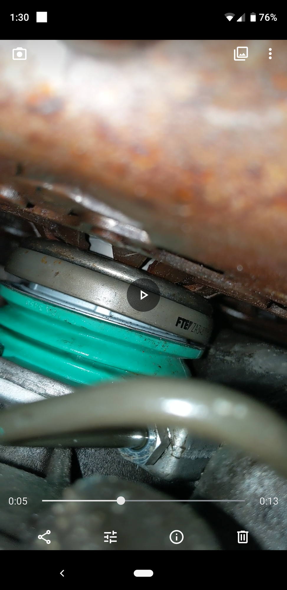

if you can see from the photo the slave cylinder does look like it is sideways a little. How ever. When I took off the elbow on top on the trans it looked like the rubber insert inside the elbow was sideways as well , creating a leak for air to get in. So I'm wondering if it is just not bled the correct amount since air would have gotten in. When I had it changed out. I took it for a ride around the block. The clutch was hard to use but still engaged for about. 6 shifts. Then I had nothing. I'm thinking that it ended up sucking in some air and caused the slave cylinder to not push against the pressure plate properly maybe that is why it appears to be sideways. But it just looks like it's the rubber boot part that is sideways. Not pushing properly. I fixed the rubber inside the elbow the best I could. I'm going to put the clutch system back together and try to bleed and see if that does anything for it. If someone else has any ideas or thoughts as to why it looks sideways. Please chime in. Thanks.

I can't find a good picture, but this might be similar see how there is a machined lip looks like the slave locates into it, maybe some clearances are off here or something is wonky causing the slave to sit a little cattywampas.

It does look like in the picture it's just your boot that is off a little and slightly compressed more on the one side. If your TOB wasn't parallel the boot is flexible so it should still have the same gap between bearing and top of boot. Here the boot is pulled away on one side.
