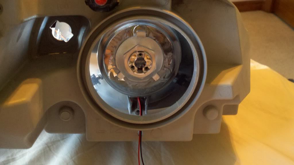

Why did you flip that cut off piece over and put it back on and why didn't you use the big fender washer thing?

The pieces you cut off the back of the reflector bowls. I've never seen anyone do that.
There's a washer that goes on the back of the reflector bowl that compresses and pulls the projector tight as could be to the bowl. I has three tabs on the outaide and is angled a bit to go over the washer you used before the locking nut.

That is the H7 Adapter plate... you don't have to use that. I didn't cut anything off and put it back on. I dremeled half of the material away. The way i did it I find much better, That was the H4 washer can't move around.. it's centered by leaving that big of material.

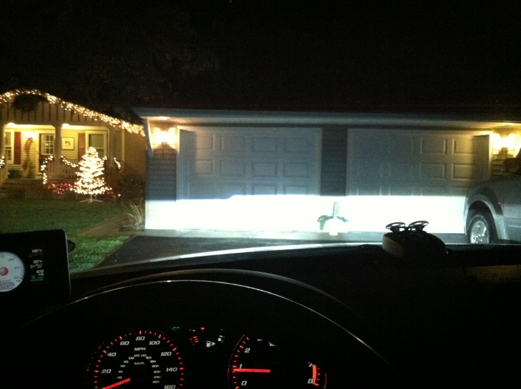

I have a few questions. To start , I assume the ballasts are the Morimoto Mini H1 5.0 Bi-xenon ones. Also , what shrouds do the cobalt use as well as which wiring harness do I select. I assume one can pick which ever brightness they want. What would the 5000k look like color wise. Thanks for the help.

I think he picked up the complete Moromoto kit. This means that it came with the 3Five ballast, the Morimoto wiring harness which is the 9007/9004 harness. You can pick any shroud that you want too, just depends what you like. 5k is pure white, they will look like this...

padlock's Avatar
Joined: 07-20-09
Posts: 5,305
From: Platteville, WI
Originally Posted by CannonBalt
You should do what Padlock did, Paint the cutoff shields Red so that it shines through! And get some red Halo's off ebay!
everyone wants to copy me now
i find it easier to mount them like this in the rear with the larger washer.. sometimes the smaller washer doesnt like to fit well inside there, not to mention my 27mm socket used to tighten on the projector nut isnt shallow enough to fit in there (using a pliers is ghetto and has the possibility of ruining threads); ask me how i know lol
its still just as easy to line up as the small circles do help you get rotational alignment fairly close from the get-go
