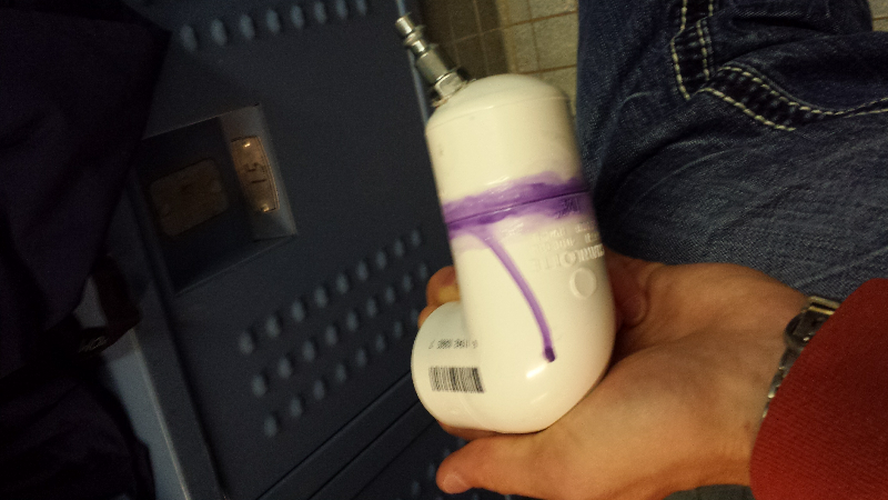

Made it today.
Old Oct 23, 2014 | 12:37 PM
iboost's Avatar
Joined: 12-22-08
Posts: 8,356
From: Rochester, New York
Looks good. Just make sure...that whatever compressor or how ever you are pressurizing your system, bring that **** down to like 15-20psi or you will blow things apart...
