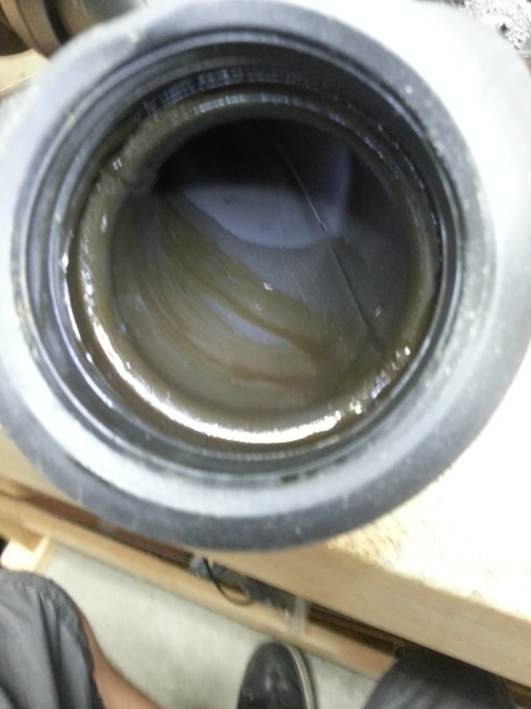

Upon removing the stock intake tube I noticed a LOT of oil covering the inside of the tube as well as a slight pooling up of it on the turbo inlet. Although this sounds to be about normal. I am ordering the Powell PCV separator soon to remedy this. I also want to take the car into the dealer (under powertrain) and have them clean the valves. See photo:

Almost looks like the filter was over oiled, cause that oil starts before the PVC inlet. Clean ur maf and start it without a filter on and see what it does. Then put filter on and try again.

Thatsss alot of oil.. The oil I see that pools there is brown/ black. I too think somethings up, at the idle the car should be normal. 15+ may be a leak, or you may just have a car that doesnt like intakes.
That pic was from the stock intake at 25200 miles looking from the turbo inlet side.

The issue is not your intake, it's all that oil going into it. if your stock intake did 15 and your aftermarket one did 15 then nothing changed.
