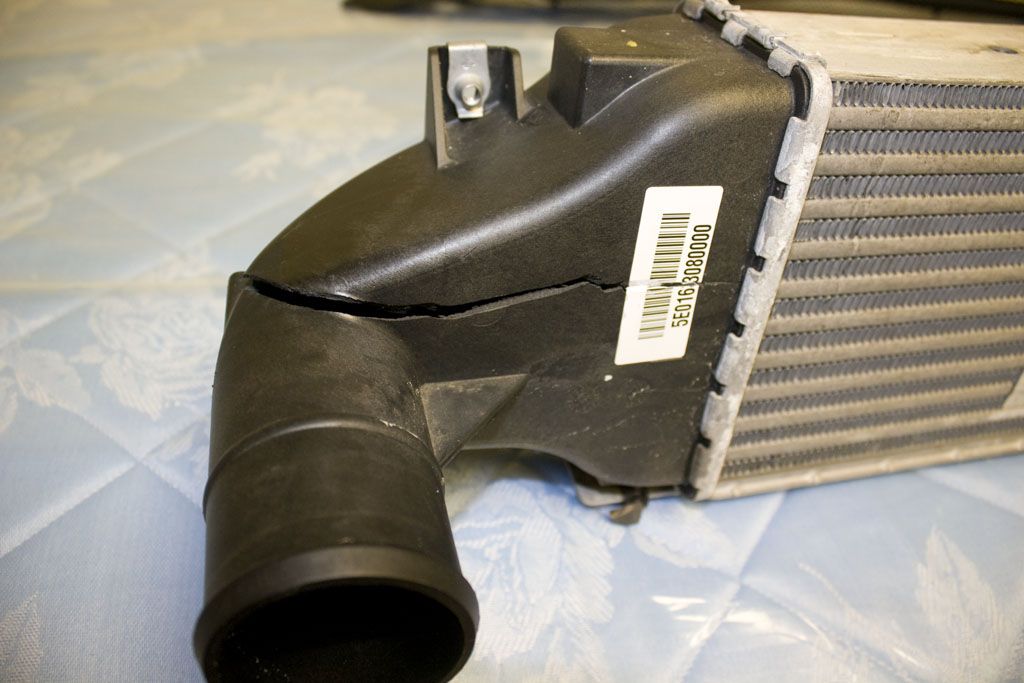

Example photos of cracked ICs just so you can see why pulling the bumper is necessary. Obviously these are really bad and there would be no boost what so ever.

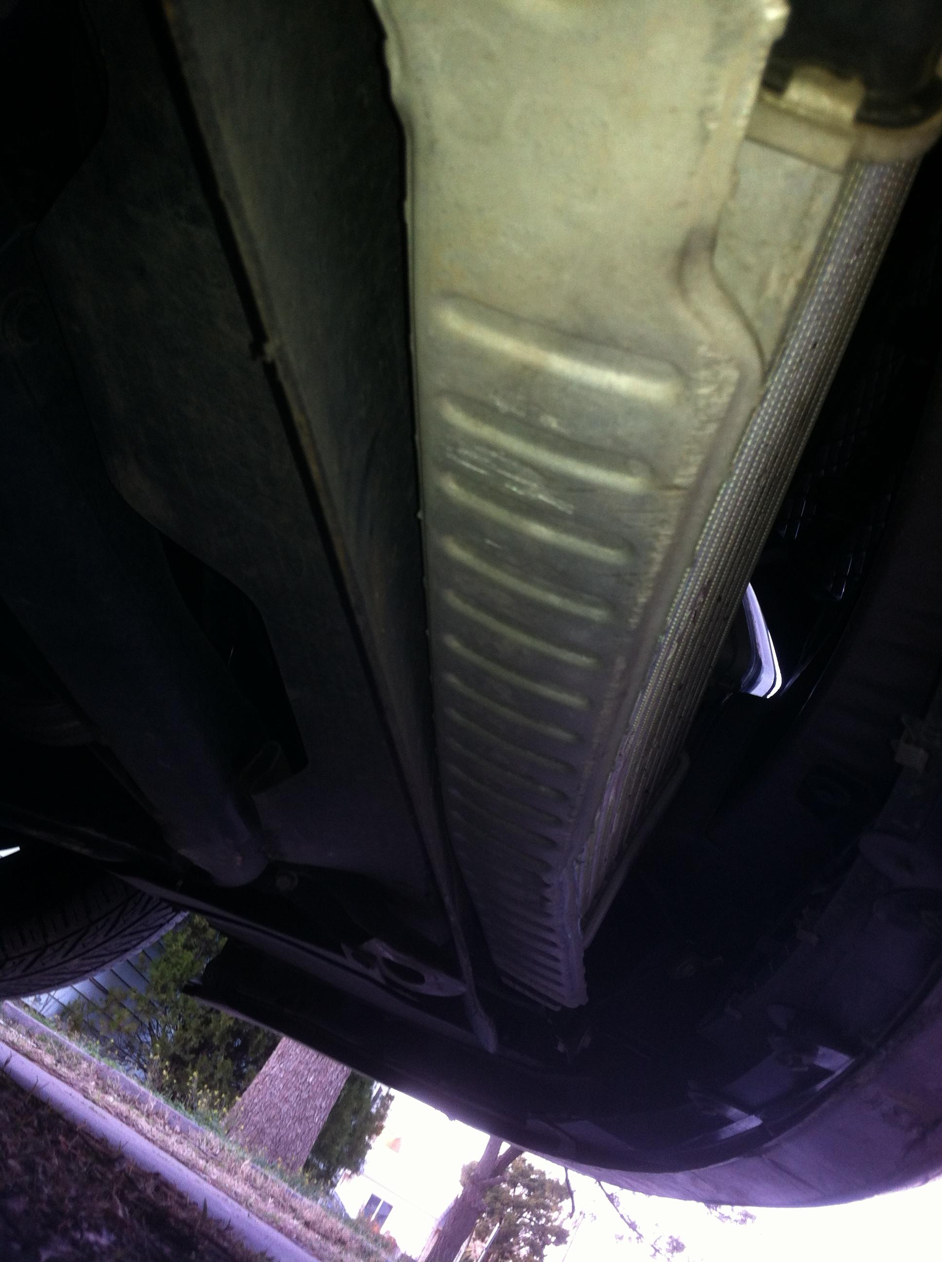

Cant find any photos, but the condenser bar may also be damaged or separated. If its separated at the screw side, not the clip side, it will cause a boost leak.
^Thats it, and that one looks like it hit a curb bad lol.

Also just raised the car and did a thorough inspection. Found a scuff on the condenser passenger side and found very small cracks running through the piece that a bolt runs through to mount the condenser to the plastic IC housing. Tried poking it with a sharp dental pick and it only seemed superficial. Tried spraying a jet of ether to see if it was leaking there but no luck.

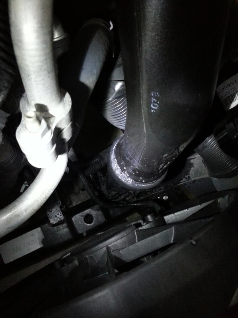

FOUND THE LEAK
Made my boost leak tester and hooked her up for 15psi. Barely noticed the sound under the hiss from the oil cap but thought I heard it on the lower part of the hot side pipe so I sprayed my soap mix onto the coupling from the plastic hot side pipe to the rubber tube that runs to the IC and WHAM, lots of bubbles and foaming. The entire band there is leaking.

Thats a new location to me, so the stock upper charge pipe is crap for you, you cant fix that, only replace it. I recommend the ZZP one, its cheap, functional, looks good and for a cheaper price you can use the factory rubber couplers. Since that stock plastic band clamp is not working at all, who cares if you destroy it for the factory rubber couplers?
ZZPerformance - LNF Upper Intercooler Pipe #ZZ-LNFUPICP
I have it under my hood. But, if you want colorful stuff Im sure somebodies gonna chime in soon lol.
Glad you found the leak though without having to take the bumper off. That would have ended in frustration.
