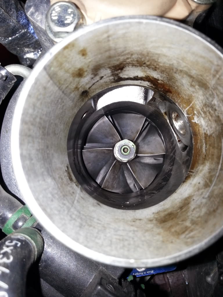

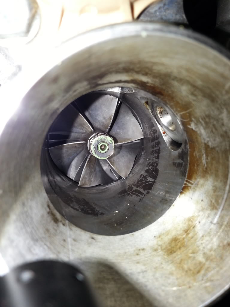

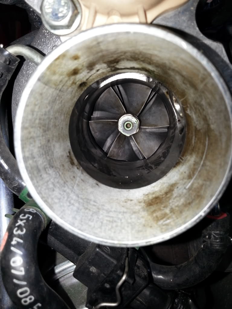

take the intake completely off and take a picture inside of the turbo at the inlet.
Many time we can see bent fins and scratch marks from the the wheel hitting the housing.
May have to add artificial light with a flash or flashlight.

Ill refrain from my thoughts on these pictures so I don't skew your opinions.

There does seem to be a minor scratch on the last few pictures. Near the edge of the blade on the housing. Not as bad as I have seen on other cars.
Hopefully get several opinions.

The pictures lost quality when going to photobucket but there is a nice healthy scratch around the inner housing. The little metal flakes that are everywhere when i run my finger around it as well as we're visible on the bypass valve make me think part of my problem lies here.
I can give it a decent wiggle up and down but not side to side.

From what I have read the turbo should not contact at all. Any hit against the housing would cause lots of noise. The rpm of that thing is so high.
I'm not going to say you need a new turbo, but you probably need a new turbo.

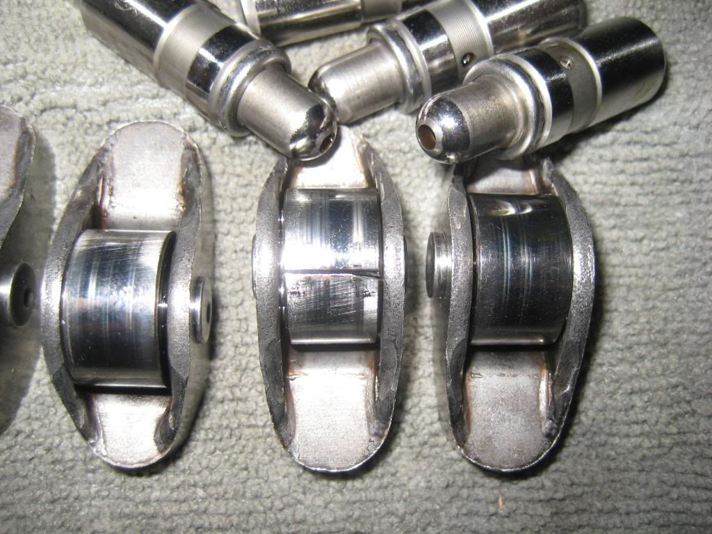

If you plan to check out the engine, have a look under the valve cover and see if any rockers are knocked off. From what i've heard, you can have rockers busted and the car still runs like a champ. That could be the cause of the high LTFTs and slight hesitations as well. (Exhaust side rockers).
Heres an image of what im talking about

If a few rockers were busted off on the exhaust side, I feel that limits the flow of exhaust gases out of the engine, hence lower peak boost and the O_2 sensor has a more dilute exhaust reading. I may be talking out of my ass though cause exhaust gases have to go somewhere so they would probably all go through a single valve opening like an 8 valve DOHC. lol. If two exhaust rockers were busted per a single cylinder, then the engine probably wouldnt start.
Just thought Id give you other things to look at and put a half assed guess story to go with it. I know the cobalts still run with a few busted rockers but they sound like Subaru's. We call it the "Subaru of death" sound. Search that phrase and Im sure you'll find videos. Doesnt sound like you have that either though. Just something to look into if the previous owner ran E85 or had a tune over the GMS1 at one point and abused the car.
