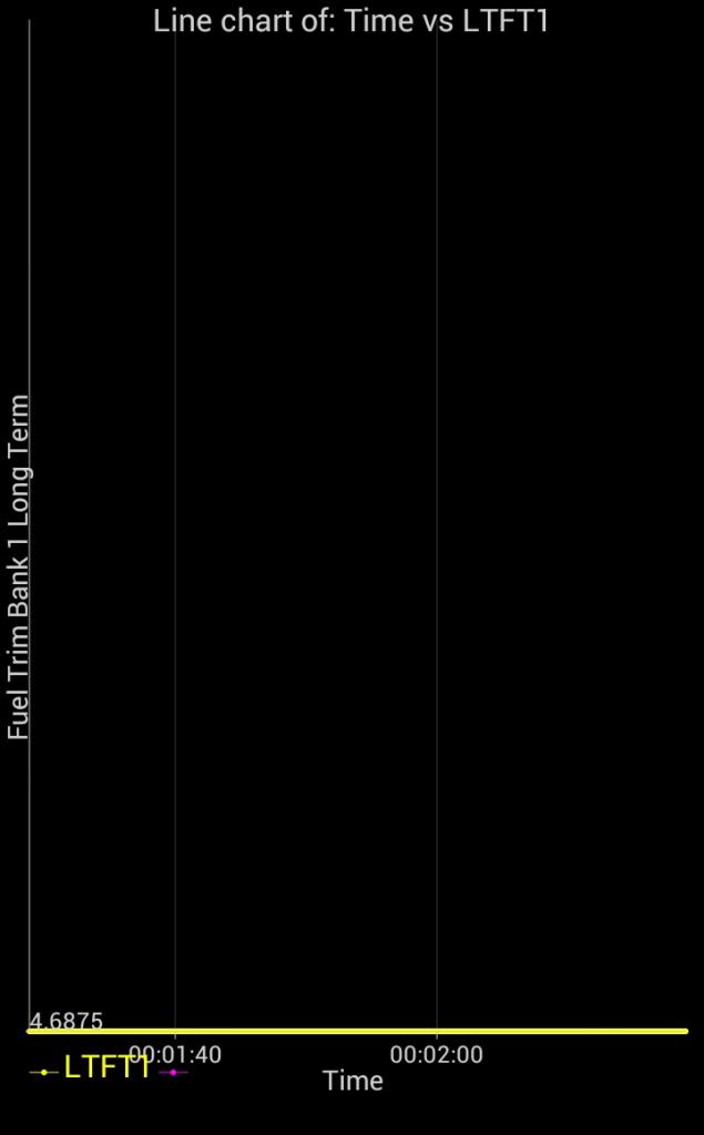

Put the oem intake back on and drove it 25miles to work. No cels no problems. Fuel trims went right from 3% at the start to averaging around 15. They still jump up and down from that. I have not reset the trims in weeks so you woukd think they woukd have settled down by now.
So I think my wiring is fine and that it was the intake giving the code.

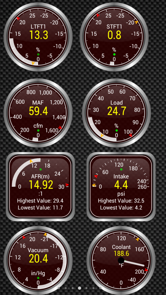

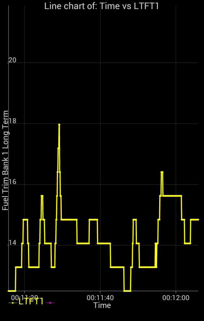

I did a graph log with torque on my way home. The LTFT sensors literally refresh each second. Ill see about posting the picture. It's a freaking roller coaster of a graph.
The trims settled to about 16 at cruise, 20 coasting in neutral, and 12-13 under wot. They literally change depending on each mode of driving.
The fact that the trims went to -3 to 7 when I had the intake on makes me think that A) torque might not be lying, and B) maybe there is a leak in the stock intake piping.

Tomorrow IIwil try to remember to log ltft. It should not change much at all. Maybe once every minute. Remember it's designed to be a guideline for fueling over a long period of time. The stft changes quickly for quick adjustments. I noticed the same behavior on torque app and dashhawk.

Does Stft Move At All? Maybe Stft And Ltft Switched Places?
If those LTFTS are real, thats crazy. They shouldnt swing more than a few percent at any given moment. Your fuel trim is doing some crazy adjusting. Bad O_2 sensor but I dunno how to test that other than just replace it :/

Then I want to test the MAF and the O2 sensor. Does anyone know how to test them with a multimeter or other means?
Umrdyldo - What bluetooth adapter are you using for your torque app? I kind of want to get the same one as you to move towards ruling out my diagnostic equipment as the problem. I put in my own equation off of wikipedia for the LTFT PID and got the same numbers as the preinstalled readout.
To check the wiring you'd have to get the service manual or find the schematics. You could check for breaks in the wire or short to ground by checking from the pin on the ECM connector to the pin on whatever sensor you're looking at. You could also check for the correct voltages going to them.
