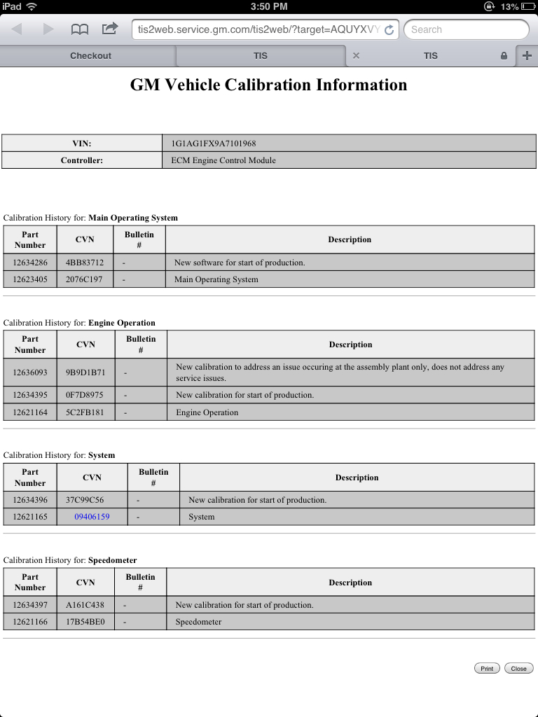

I ran the vin through that GM die and got this. I do not know if it has any significance. I have not been able to see a corresponding number on Torque app.

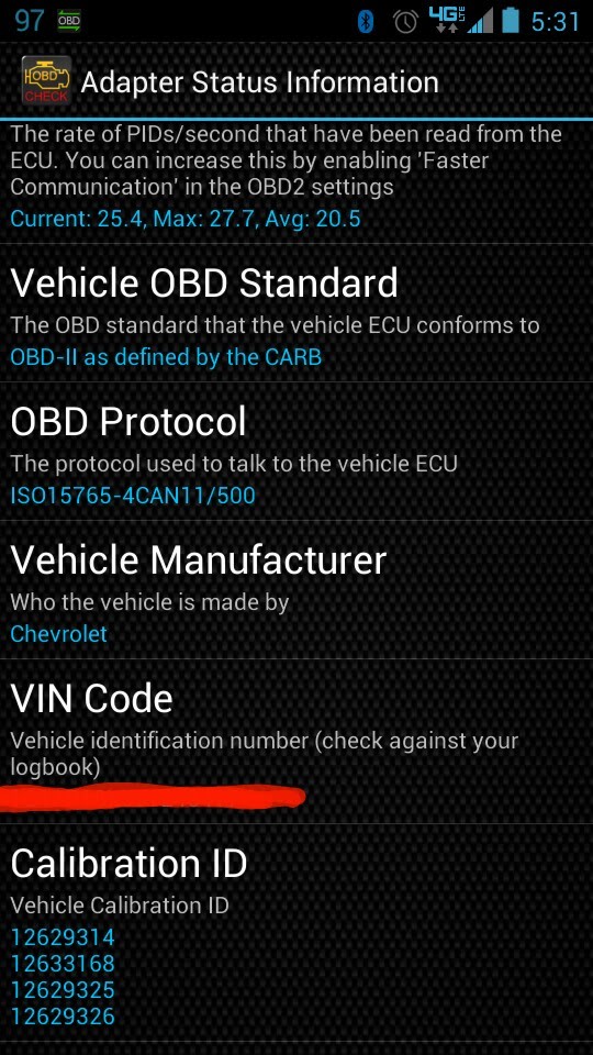

Check the adaptor settings page, it's at the bottom.
Didn't see anything that made sense. Screenshot?

It's a selection on the main rotary page, adaptor status i think.

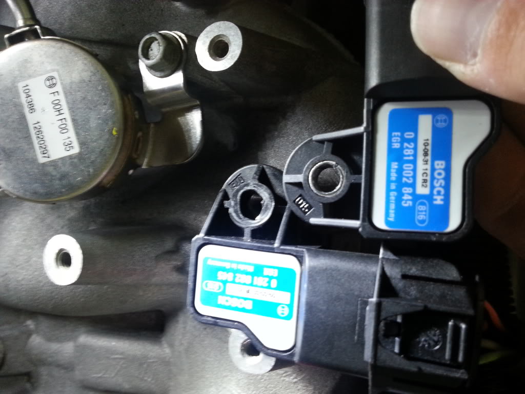

Went to install the new map sensors, got the black orings on the new ones. Took the old ones off (the IM one had a lot of oil residue on it). Filed off the tab on the lower new one so it'd fit. Installed it just fine. Went to install the upper one and it will not line up with the bolt hole. Looking at the old one it appears the metal ring on the inside of the bolt hole was removed to make it fit. Do I have a wacky intake manifold or is this normal?
See picture - new map has metal reinforcing ring on the inside of the bolt hole (which does not allow the new sensor to line up with the intake manifold hole). Old one has had it removed and maybe even filed down a bit.

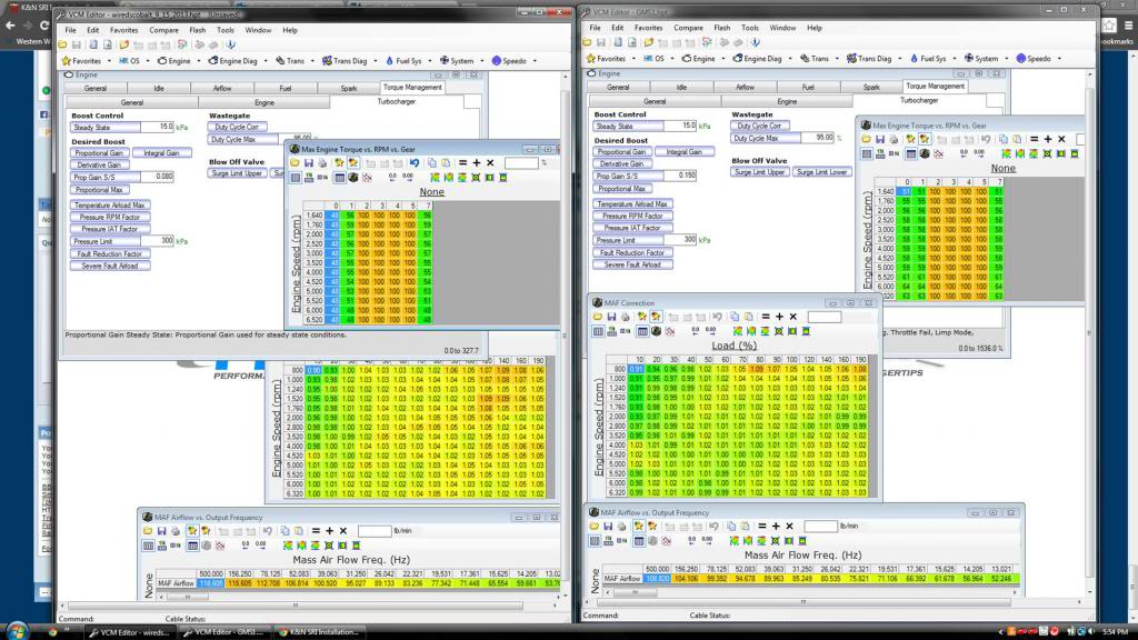

I read the current tune on the car expecting it to match a stock GMS1 file that was provided to me by a member here.
They do not match.
Several tables such as the MAF base and correction, the torque mgmt, the prop gain s/s, BOV surge limits, and other tables that I am not experienced enough to understand are all different between the two. My torque mgmt table makes no sense as it is now because 1st gear has a back and forth ramp up such as 48, 42, 51, 56, 49, etc. In that order.
Someone want the file to take a look at it?
Here is a screenshot of a couple tables. My car on the left, GMS1 on the right.

Put up a link to the file on your car. Have you compared it to the stock tune (not GMS1)?
My upper MAP fits with the ring still on. It doesn't line up perfectly, but there is enough play it should go on.
I did compare to a stock and it is not the same either.
Ill upload it after the seahawks game.
