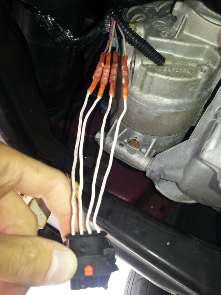

Opened up both map sensor wiring harnesses and individually taped each connector to make sure they could not short out. I noticed the bottom charge pipe sensor has four wires utilized out of the total four in the plug, while the upper manifold map sensor only has three wires being utilized with a missing fourth stock wire and a fourth plug wire that is cut and unattached to anything. Is this normal?
Bottom
Bottom
[IMG]http://i183.photobucket.com/albums/x37/CA_Sniper/20130818_111109.jpg[IMG]
That's normal. The lower sensor is a TMAP (temp+manifold absolute pressure), the upper is just a MAP sensor since it doesn't utilize the temperature part of the sensor.
They wired it right, so that's good at least.
If you want to double check the upper wiring it should be: orange/black, empty, gray, light green. This is with the connector facing you with the clip on top, left to right.

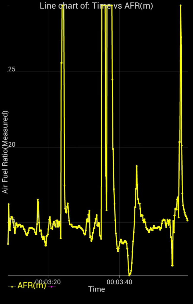

Here is a log of 25-35mph driving over three miles of my AFR. The spikes were when I was coasting in neutral for a corner or speed bump. Does it look normal?

See if you can find a flatter road and try to hold it dead on a certain speed for a consitant engine load, its hard to tell from afr's what the engine load is and how your ign advance is changing for the load demand

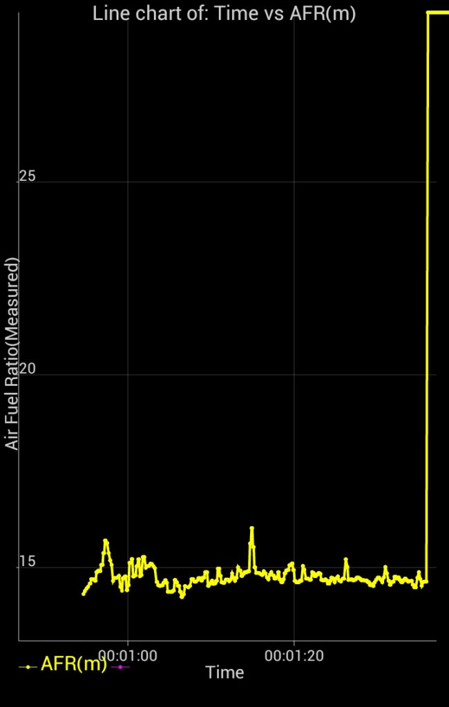

Same three miles tonight. Cruise controlled the flattest part and it couldn't choose between 30 and 35.
The spike at the end was me going down a steep hill and disengaging cruise control.

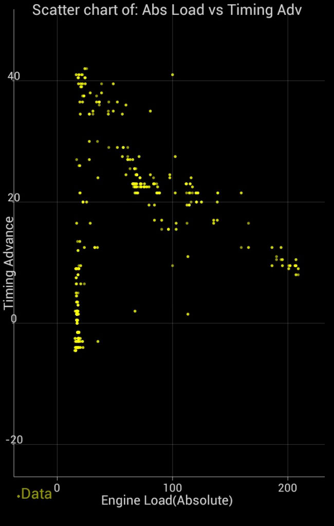

Then on the way back I did absolute load to timing. Up hill for the first part of the drive, then flat, then I did a quick 0-30 at the end of the drive.

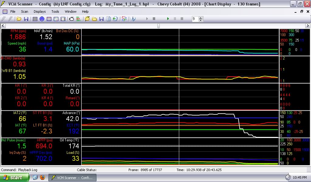

Those graphs don't really mean anything without some other relevant information. You need to be using a scanner that can record more than one parameter at a time to get any value out of it.
