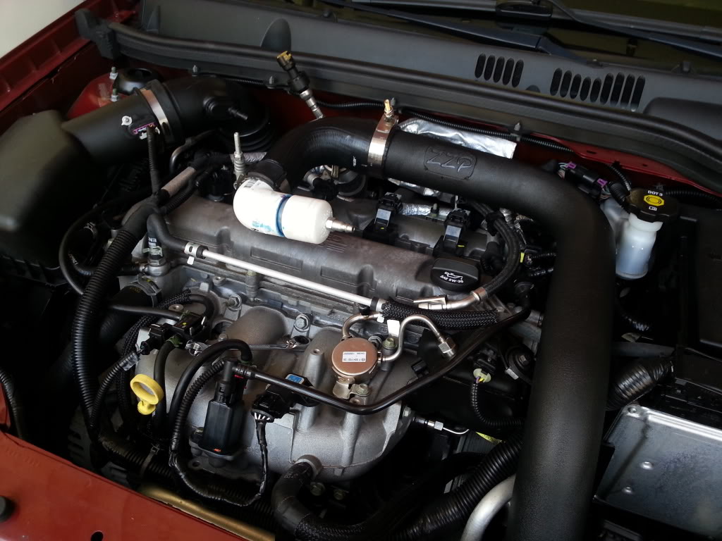

UPDATE:
Decided to bypass the vacuum tank after spraying it down really good and not seeing any bubbles (used my air compressor to pressurize it). Took it on a drive and fuel trims did not move however right after a hard 1st to second shift I heard a loud blow off valve sound (I did not "no lift ****"). I thought I had blew the hose off but it was fine. I figure its because the tank was disconnected (I had read that on here at one point).

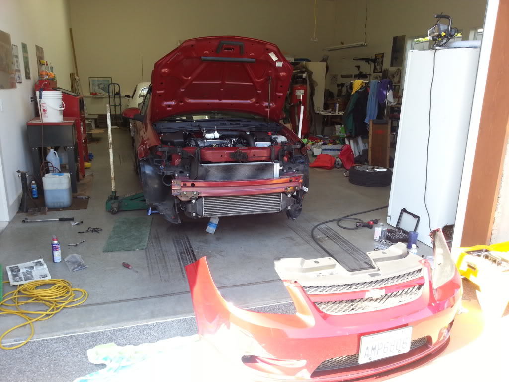

Removed the bumper.
Sprayed the entire intercooler and all fittings (both sides of IC, the couplers, the plastic rings, etc) and did not have any leaks. I put almost an entire spray bottle on the thing trying to find something.

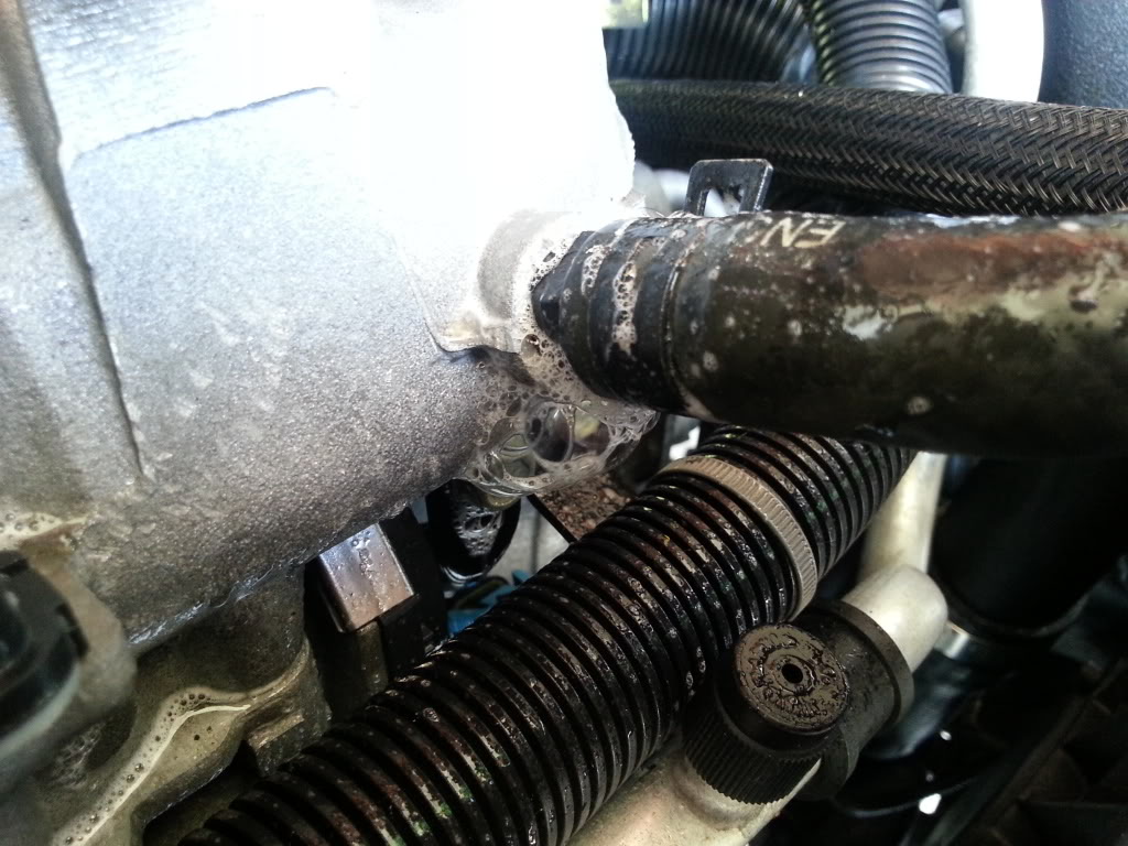

Before we had the bumper back on I noticed that the brake booster line looked a little odd and I decided "what the heck, why not" and liberally sprayed it. LOTS of bubbles from between the manifold and the plastic fitting. See picture:
I tightened the fitting and ran the boost leak test again. No bubbles. I was very excited that I had found another leak. After getting the bumper put back on I took a drive to town (15 minutes one way or ~8miles one way) and the LTFT hovered around 3 until it AGAIN rose to an average of 15%. The maximum it hit during the run was 24% at idle and parked.
I'm at my wits end. I have found and fixed TWO quite large leaks in the system and the fuel trims have not changed one bit. The rest of the piping was also leak free.
I think I will remove that fitting to check for cracks and maybe use some RTV sealant. If I can't figure it out soon I will be taking it to the dealer and driving a different car while they figure it out.
I also was wondering if the valves gunking up could have something to do with it, but it does not follow that more gunked valves would lead to more fuel being added...
