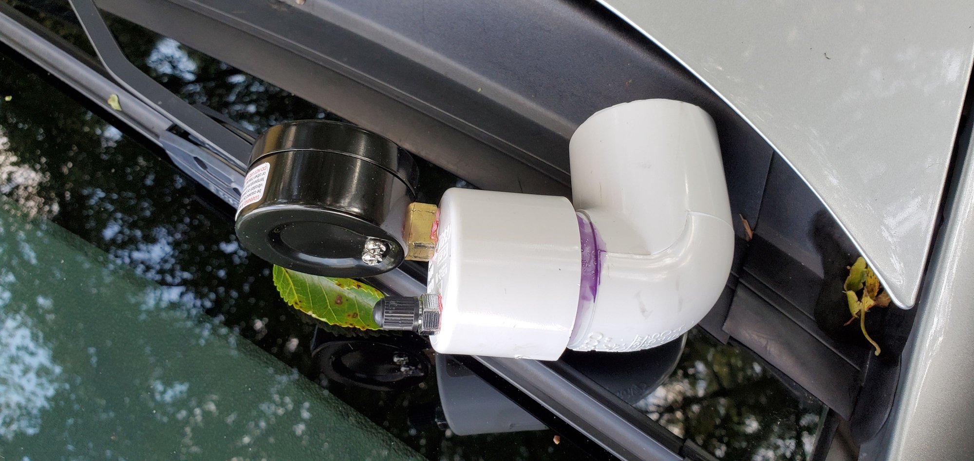

https://turboboostleaktesters.com/ho...ost-leak-test/
