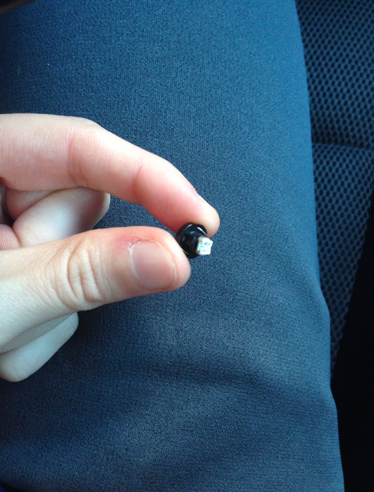

For all SS or just certain years?
This is what the correct one looks like

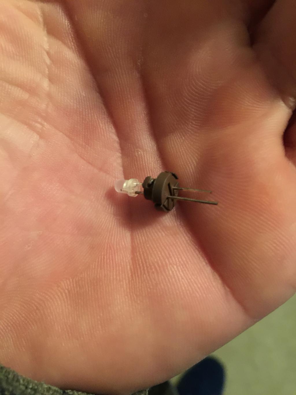

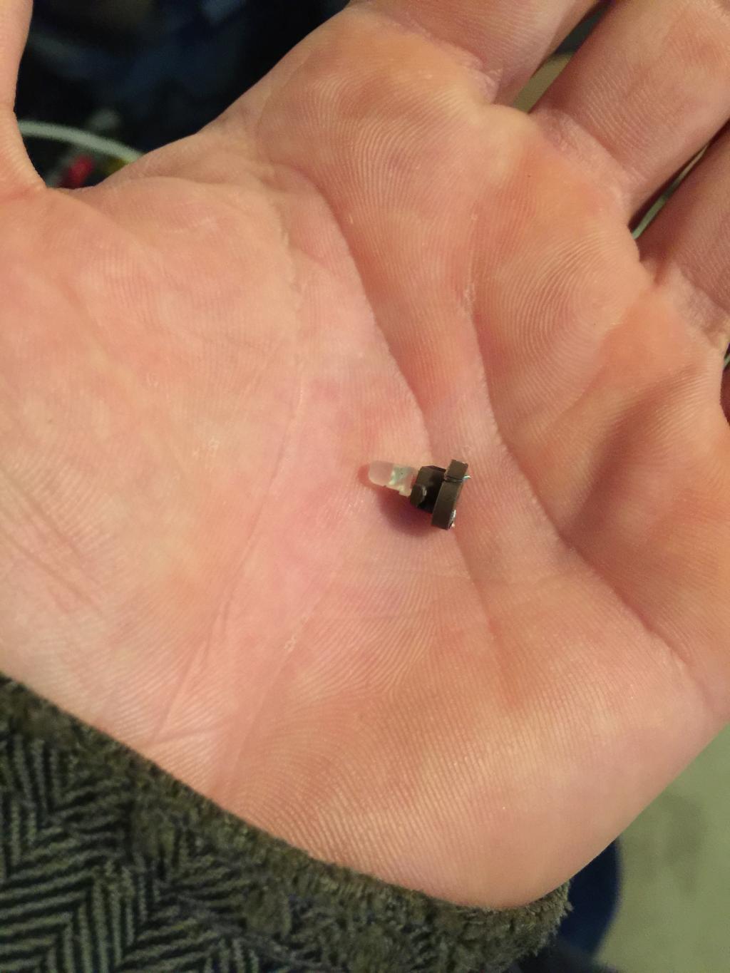

a 3mm works just fine. Thats what I used in my 05-06 wheel. the legs of the led slip right into the holes of the old bulb holder. bend the legs around just as the stock ones are. re-install. The ones you posted also work.

It's easier to just buy t3 though. You can buy them on many sites.

It is easier but the 3mm is $.25 I had extras too from the LED conversion I did on the other switches

Yep, you need raw LED's. 12v LED's are direct replacements. You'll need both 3mm and 5mm LED's for a complete swap. LED's are polarized so be sure you solder + to + and - to -
