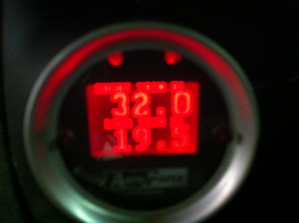

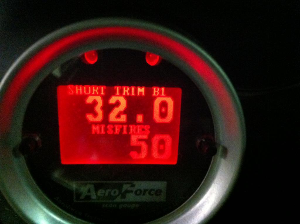

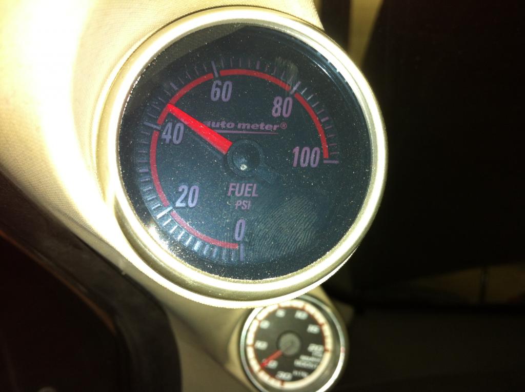

There is no negative on the STFT and LTFT, misfires when i let out the gas trying to hold the throttle @2k fuel pressure is pretty steady @46ish due to BRFPS, and of course my AFR supa rich.
