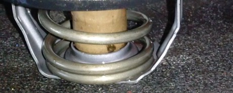

I agree that there is probably still air in the system but where and how to get it out. I drilled a 7/64(.109) hole.

Dont do it to the one you delrilled holes in, do you have the old one still? How you do it is flip it over and cut the two side pieces that hold the spring and plunger to the main body. All you want is the top section so it looks like a big washer with out he guts. Cut the sides in this picture. And I drilled the hole on the outside silver ring not in the center
